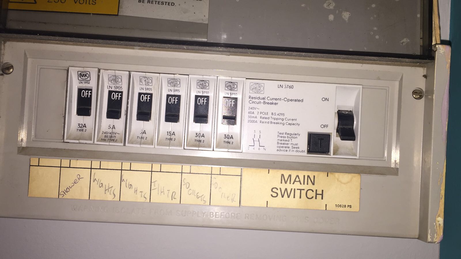

Our mains RCD switch 60A 30mA MK LN 5760 is tripping when either one of my larger mcbs is turned on.
- 32A shower
- 30A sockets
- 30A cooker
I turned every breaker off and individually turned them on. All three mentioned above individually trip the mains RCD.

I would suggest that you probably have a neutral to earth fault on one of the circuits protected by that RCD and the resistance of the fault is such that the RCD will not trip until a significant current is drawn from the supply. This would account for the three different circuits all tripping the RCD. The fault could be on any circuit and only testing would determine which circuit

The consumer unit is:
MK sentry unit
CM16
BS 5486 Pt 13

That's the problem, I had turned them all on 1 at a time and all three MCBs 30A+ cause the RCD to trip so difficult to identify an individual circuit problem.
The fault Richard suggests is a possibility, if it's the socket circuit tripping the RCD unplug everything, switch back on and try your appliances 1 by1 until the RCD trips, there is the culprit
Ok, I asked because I've just fixed a house with a similar situation caused by a lack of understanding in the spark who changed the consumer unit.
Could you post a picture of your consumer unit please, making sure to include the LN 5760?
I would suggest you follow the advice from @Pete999 and try unplugging/turning everything off that is connected to the socket circuit and then try just turning that circuit on.
If it still trips, you are going to need the assistance of an electrician and their test gear.

It might be an idea to try turning off the cooker switch near the cooker and then switching on the RCD and then the cooker MCB with everything else off and see if you still get the tripping.
With only the initial current draw from the capacitance of the circuit the RCD should not trip and I would fall back on the earlier post.
If you do still get tripping then it may be that the RCD is failing, that type is now quite old (and unfortunately difficult to get replacements).

I reckon they would be willing to have a look at it for me, is there any type of tester I could advise them bring along with them.
Failing that, looks like I will be contacting a local sparky as mentioned I've noticed the RCD not easy to get a like for like now.

Initially I would be considering an RCD trip test and thereafter, if that was OK, an insulation resistance test individually on each circuit.
Any electrician attending a job should have a tester to do these tests.
