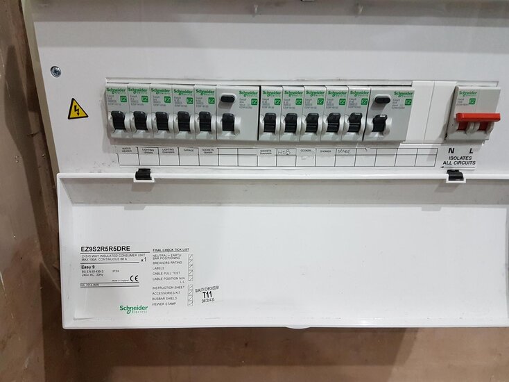

We're having work done to insert an open plan kitchen-diner and snug seating area plus wood burner into already existing extension. One load bearing wall is being knocked through.
Electrician just bumped his quote up by £820 to cover replacing this consumer unit and moving it up the wall (above where the fridge will be going), breakdown:
Consumer unit replacement (even though no new circuits) = £500
Plus he's said we need new mains wired:
2 x smoke detectors (top and bottom of stairs in main house, not even area we're having work done) @ £80 each = £160
1 x heat detector in new kitchen = £80
1 x carbon monoxide detector in new snug area = £80
House built in 1982 and has one battery operated smoke detector at bottom of stairs.
1. Are these mains powered devices necessary as we'd be more than happy with the long life 10 yr battery powered devices?
2. Is it necessary to replace and test etc. the original consumer unit (photo below)?

On the face of it there's no requirement to swap out a perfectly good distribution board. It may not be the very latest but is still fit for purpose and a very good make.
As for smokes/heat/Co detectors etc as I'm guessing yours is a private property then there's no requirement for mains powered devices although they are my preferred option.
Has the electrician mentioned membership of any scheme such as NICEIC/STROMA/NAPIT etc?
I would seek quotes from another two electricians, if you know anyone that could recommend one then great if not post up a rough location then I'm sure a forum member would be close by and able to quote for you.

open that cover of the consumer unit ,so we can see if it justifies that price ,was their any testing done .
That's the original consumer unit, installed prior to us purchasing the property.

He also says because the consumer unit is being moved it needs to adhere to updated regs, so we need a new "gen-18 unit" and "these are a bit more pricey than they used to be". - Can anyone confirm if this is the case?
Losing the will a bit here, phew.
Hmmm. How far is CU moving, and are any of the circuits being extended?
CU is moving about 6ft up the wall it's currently fixed to, mains cable runs up the same wall.
We've not anticipated any circuits being extended as the current rooms already have lights, sockets, oven etc. circuits in them. There will be some moving of wiring but doubt there'll be additional circuits needed. There are 3 spare module slots in the current CU if that makes any difference.
