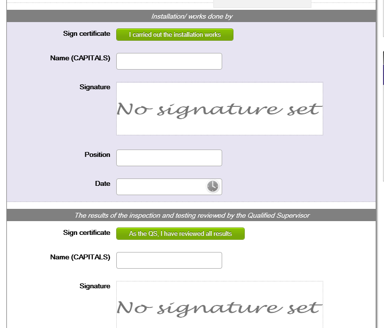

I believe it needs a Minor Works Certificate because my copy of the wiring regs say "The Minor Works Certificate is intended to be used for additions and alterations to an installation that do not extend to the provision of a new circuit. Examples include the addition of socket-outlets".
I accept that NICEIC won't accept their system being used for 3rd party work. If you have another suggestion other than doing an EICR, I'm all ears.

That's probably great advice which I will take on board. The NICEIC online cert system doesn't allow you complete the cert with other peoples information in the box specifying who constructed it. Not knowing they wouldn't issued certs for 3rd party work I asked them why.
There is no other option. It may be a commercial decision to be giving some sort of certification for other people's DIY work but I would personally recommend you steer clear of it, I can see why the NIC take a dim view on it.
Thanks that's probably good advice, that I will take on board
An EICR can cover as little or as much of an installation as the inspector agrees with the client.
As for a 3 part signature MWC I've never seen one of those.
