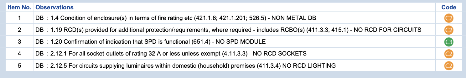

I had the first EICR done on my flat last week, which failed with some C2s for having an older (2001) plastic consumer unit with no RCDs, but otherwise passed:

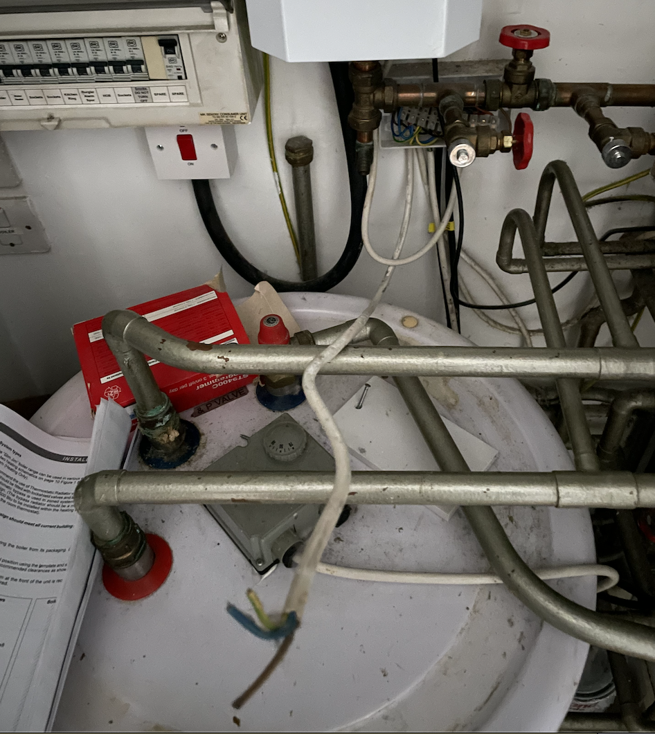

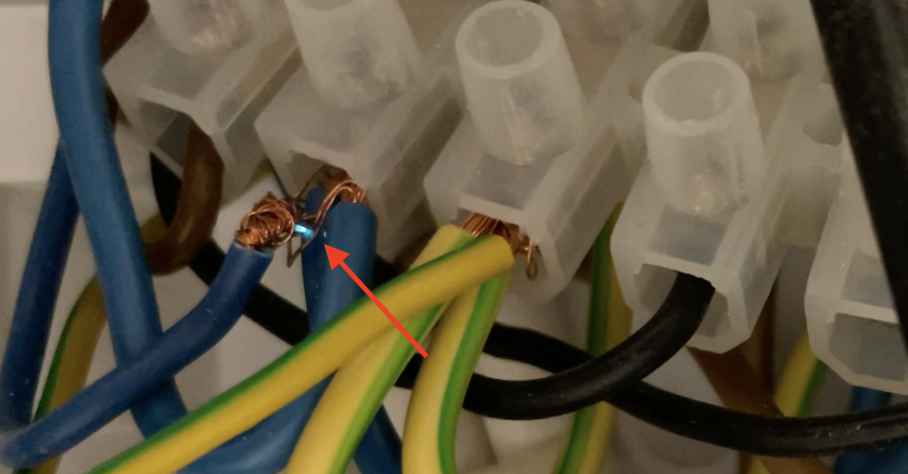

A couple of days later I'm called to the property due to no hot water and find the electric boiler is dead. There's a connector block in an enclosure under the boiler so I removed the faceplate to have a look and saw continuous blue sparks from a very bad connection, to say the least:
At this stage I'm already feeling aggrieved as this had worked flawlessly for 6 years and suddenly just after the EICR there's this terrible connection that can't have been sparking like that for years, and the control board in the boiler is likely blown (later confirmed).
I'm wondering why there's three neutrals jammed into the same connection and notice one is from a loose cable going down behind the hot water cylinder. Wondering where it goes I reach down to wiggle it and... BANG!
Photo isn't very clear because I've immediately switched the main switch off so it's dark. The cable had bare ends and was just dangling behind the cylinder! It had come into contact with the it as soon as I reached down and thus the bang.
The electrician who did the EICR and the agency I paid deny any responsibility for not finding any of this, saying "checking wiring centers and cables from cylinders is not part of an EICR. Inspection and testing is carried out on the fixed wiring where accessible, as far as the isolator to the heating system, which was carried out."
(The cable isn't from the cylinder and in fact has nothing to do with it.)
Is it really the case that a professional test costing hundreds of pounds isn't even expected to find a live cable with bare ends dangling in an easily-accessible location right next to the consumer unit? Just another box ticking exercise with no real assurance of the safety of the installation at all? Please forgive the rant but this could easily have electrocuted me.

items 1 & 5 should both be C3.
the missing covers on those boxes for the wiring centre should have been picked up as C2s if nothing else.
and a kick up the arse for the wet-pants that put his pipework directly in front of said boxes.
There is some argument on here as to whether no rcd on sockets is a C2 or a C3 but that’s a different discussion.
They have noted C2’s so the EICR is unsatisfactory. There’s no such thing as “otherwise passed”
There is a box on the report for limitations of testing. Some don’t do wiring centres…. Others may not even open lighting jointboxes… As mentioned above, the act of opening a cover or removing a faceplate to do the tests can actually introduce faults where there wasn’t one before.
A live cable hanging like that is a C1, immediately dangerous situation.
I’m surprised they missed it, but then… a dark cupboard…. Being told not to test wiring centres….

Yes, tested up to the fcu, but I honestly can't understand why this was not spotted during the EICR visual inspection.
And the limitation to test only up to an fcu would only apply if expressly agreed with the client and recorded in the limitations box.
Wiring associated with the Unvented cylinder and any other controls associated with it would be checked on the annual inspection done by a G3 registered heating engineer / plumber.
The wiring isn't associated with the unvented cylinder, or any controls associated with it. Just happened to be dangling behind it. And there's no gas so it isn't the gas safety's remit either.
No, the live bare ends were dangling free for anyone to see or touch without removing anything.
Apologies - I was looking at the connector block photo not the loose flex, rather missing the point.
I'd like to think that I'd have spotted it in an EICR but personally I'd test as far as the FCU and anything beyond would be visual inspection unless I had reason to dig deeper. So if I saw a loose cable I'd certainly go into "I smell a rat" mode, but if it wasn't in sight I wouldn't go looking for it.
But it can't be a coincidence that the boiler failed due to that bad connection immediately after the EICR
I can see it looks suspicious but doesn't really make sense for the tester to have caused that loose connection unless they unwittingly increased tension on the cable, and it would have had to have been loose in advance.
Personally I would agree with the inspector in that any appliances are ancillary to the fixed wiring installation and that is most definitely not part of an EICR. I would like to think I would have spotted the dangly wire and maybe would have looked into that but mostly I would have been very focussed on the fixed wiring. It is a moot point I agree but given time and cost constraints especially with landlords you simply cannot cover it all. Added to that, appliances are outside the skill set of an electrician and we would generally see all boiler and controls as part of the gas safe inspection. It is not that I do not have an eye to pick up things outside of the remit it is more like my focus is not there. It is a cautionary tale though for me at least. It is very much the LL's responsibility to ensure the installation and appliances are safe. It is something you might consider taking up with your local council?
