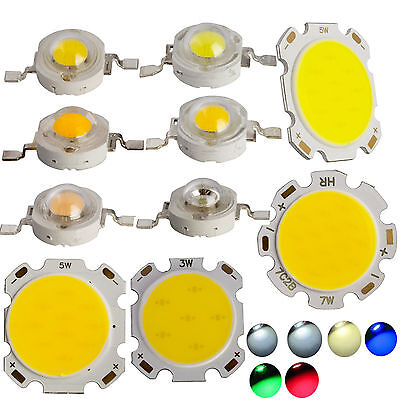

Hello,
I am an artist in Portland Oregon and I need to power an array of 3 watt cob leds (9-12vdc 260-280ma)
They need to be strung in strands of 8 (12 total strands) 96 total leds.
I would like to run them a little underpowered to reduce the heat and make things a bit safer and perhaps last longer? I've tested them on a small constant current power supply at about 2.5 watts strung in parallel and that seems about right.
How would you design the power for this, with safety and affordability being important. I am decent at following instructions...
Many thanks, Tor
So you want 12 strings of 8 LED modules in parallel. Do you want all the strings to operate together with a single driver (power supply) or are the strings far away from each other and better suited to 3 separate drivers?
Current and wiring size becomes a big factor when you've got a total load of 250 watts at 12V, you need substantially sized conductors to carry that current if all the strings are on a single driver.
The reliability and longevity of the LED modules will be greatly affected by how you mount them and how effectively they're heatsinked by the substrate they're sitting on.
From the safety aspect I'd suggest using a good quality driver like a Meanwell and ensure your wiring sizes are appropriate for the current.
