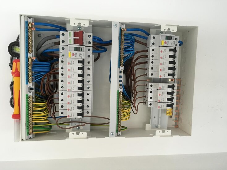

I fitted a dual row Hager board a couple of weeks ago. Great bit of kit. Can't beat Hager imo
