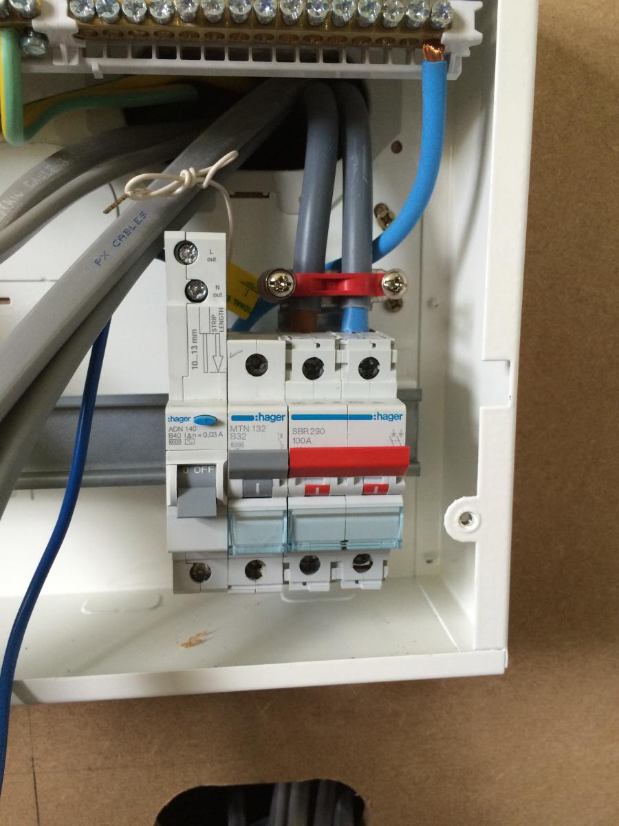

Was that a Design 10? Because the cable clamp on the Design 30 stops you fitting an RCBO next to the main switch. So on a THTC heating board you would theoretically loose 3 ways, but Hager on supply a clamp on 1 main switch and not the other 2. I guess they sussed the problem.
Not sure, it never had the clamp, so plenty of space beside main switch.
