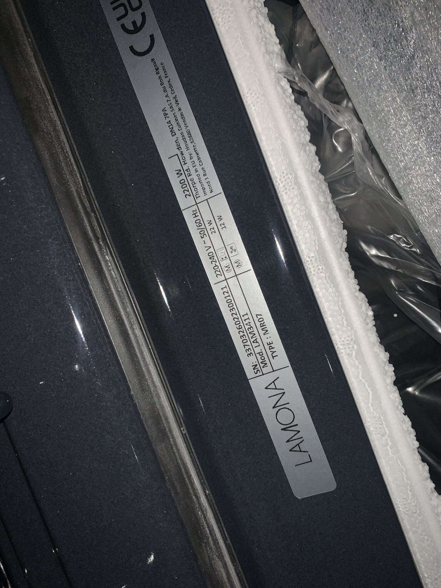

At the moment I am confused I have a new single electric oven totals 2.2kw,

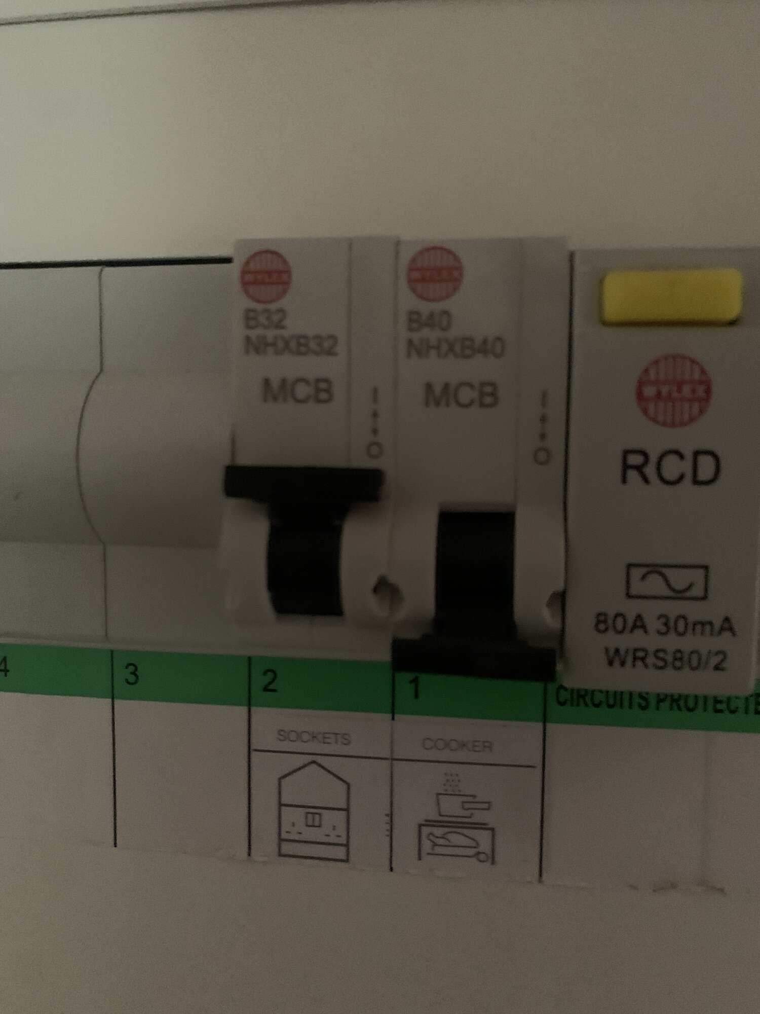

I have 6mm cable from mcb on a 40amp breaker on dedicated cooker point on board
The oven has 1.5mm flex no plug and the label on the flex says do not use plug 🤔

Drop breaker down to 20amp and re run 2.5mm from mcb to a single socket and run a 2.5mm fused spur switch from that single socket and just put a bg plug on the 1.5 flex ?

If the manufacturer is telling you not to fit a plug, I wouldn't.

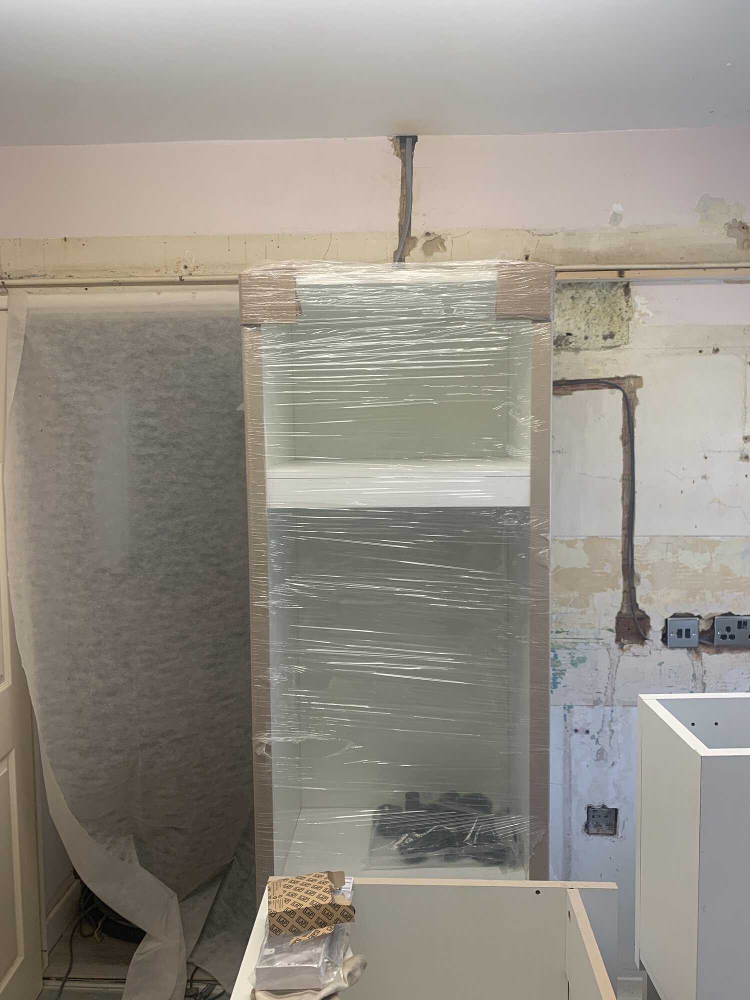

Hi no I have just had my kitchen renewed and there is a plugged in built microwave and single oven going in there and as it said plug and play and the reason I brought it I had a oven switch put there but the guy that did it put a cooker switch with a single socket and said I can plug it in there but I said I won’t be able to access the switch to isolate it if needed other then at the board but he was threatening his country people on me and this that and the other also as he only chased the wall out deep enough for the 2.5 ring circuit to sit flush with the wall and now got to go around and re chase so the 2.5 can sit in the chases comfortably so I can plaster.
Can I leave the 6mm cable in situ and put a cooker outlet in place of the one that is there now and can I run 2.5 to a idolater switch where accessible?

Second pic. Can we have a photograph of it straight on? I’m worried the cable on left is rising away diagonally, which means it’s not in prescribed zones.
Also concerned all the shiny new faceplates have been fitted before plastering.
Ideally there shouldn’t be any isolation switches behind appliances.

Hi yes of course I guess as they say you buy cheap you get what you pay for I don’t like it there either the top single socket is for the built in microwave

The vertical chase is required to be in a 'safe zone ', which is anywhere within the width of any of the three fittings grouped together.
Electrically, it is probably OK, as long as the spur to the microwave is directly of the RFC ( assuming that's what feeds the three fittings), but to be compliant, the vertical chase needs to be moved to the right. Definite C2 on an EICR as it is.
Prescribed zones are understood by all trades that the horizontal or vertical line from a switch or socket may have cables buried beneath the surface. Don’t drill holes there.
Anywhere else is safe to drill for fixings.
It’s a big surprise for a kitchen fitter to drill what he thinks is clear, only to find a live cable!
That’s why the chase mention contravenes the regs.
