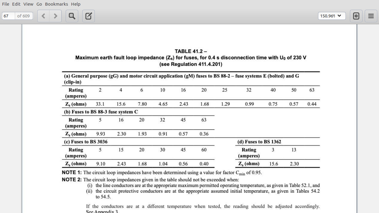

thanks for the reply Cliffed, so your saying that in effect the FCU 13A in this case is Zdb which is 1.83 ohms and I'm doing R1+R2 for the cable from the new socket to the FCU?
Then when I measure max Zs it should be under the max Zs for the BS1362 at 1.83 Ohms.
Sorry to bother you just want to be sure as this is one of my portfolio of evidence for Napit.

They are good questions. My opinions:
1. Zdb measured at the DB at the origin of the final circuit, not at the FCU.
2. I think 13A BS1362 . If there were multiple sockets downstream of the FCU, then this part of the circuit would rely on it for overcurrent protection.
3. Max measured Zs is the actual measured Zs at the furthest point, ie at the garden socket. R1+R2 is from the origin of the RFC to the furthest point ie the garden socket.

I think we can use BS1362s to meet disconnection times. Max Zs for them is in tables 41.2 and 41.4. I take your point about owners replacing them with ones of an incorrect rating, but the same is true of BS3036s, or any fuse used for any sort of protection really.
