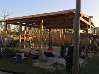

Hello everyone. I’m a DIY person and I’m about to give my shop a little juice.
I had previously ran UFB 35 feet to a 220 outlet for my brothers RV. Now that he’s gone, I’ve built a 24x24 shop.
My intentions are to run 16 led shop lights that will pull 7.04 amperes. Also a shop fan (unsure of draw as of now) a small power tool charger, a radio and every now an again an air compressor.
I’m wanting to use that outlet I have wired as 220 and change it to 110 to do all of this. I don’t like the idea of plugging all of this into outlet adapters I would like to know how to wire multiple outlets off this one that I already have.
And last, the shop lights I have don’t have an option to daisy chain all of them together. Each one of them have their own outlet plug. In a perfect world I’d like to get them all on a switch.
Looking for the best way to do this. I’m a visual learner and live in Florida it that matters.

Here is a pic of where I’m at so far, it isn’t finished.

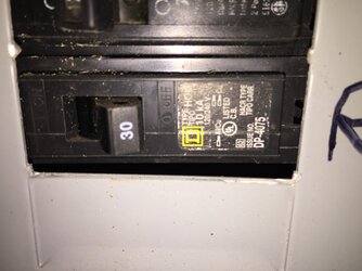

Here is what I have it running on. It’s ufb ran about 16 feet. This is coming from the outside of my house running to one 220 outlet 16ft away. I live in the country with no one around for miles.
When you get your garage built and in the dry purchase a 60 amp main lug only 16 circuit 240/120 panel to mount in the garage do you have any spare spaces in you main panel ?
When you are finished you going to like the panel and everything you can run plus the lights no problem

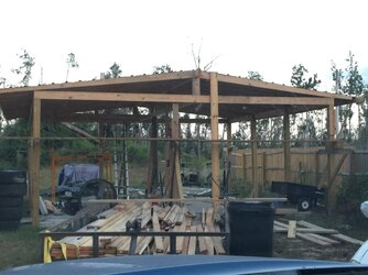

You probably think it’s bigger than it is
I am now hating you !!! my workshop has enough room ( just) for a wartime era REME bench, a few tools, 4 dutch bicycles, one italian motorcycle, and a Morris Oxford, like me its slim and stylish,!!!! although at the present moment I cannot get my motorcycle or bicycle in due to 2 tonnes of classic cars spares I purchased, and a Great War Tank in process of being constructed for an event later this month
