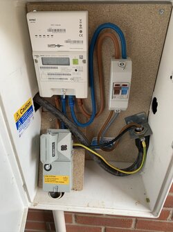

Hi guys, working round a friends brand new house at the weekend and discovered this in the meter box. Why can’t people do things properly? Also twisted cpc’s in common sleeving and no cable identification on 3C+E s
What size is that? My impression is 10mm but I can't say I know enough.
Also they seem to be a bit short in length for the CPC! Still, at least they used a gland...
I wonder whether someone thinks that's adequate? Can't see copper, IR tests OK, tick the box and move on.
I think the word "quality" in your title is a bit of a misnomer. No identification of cable by colour. I would have got a metal isolator and glanded into it. No seal on holes in box. Not straight. Inadequate security of fixings i.e. the cut-out. Poor workmanship, I could not work like that, and maybe it was a requirement for the persons doing the work to do that. Agree with @pc1966 size of cable probably inadequate as nowadays all heating will be electric???? as gas is not used so much.
I’m surprised they even bothered with the bracket type thingy.
i recently saw a brand new multi million pound house where the armouring was simply cut off and the cores terminated directly into the meter.
Infact it was like this at both ends , so the armour had not been earthed at all...
another rough thing I come across occasionally on new ish installations is a ec14 clamp used on the armouring in the meter cupboard.
This kind of thing simply defies explanation. Whoever did that had enough knowledge to gland the SWA, and connect a copper link with a ring terminal to the armour.....and yet they didn't think basic insulation requires enclosing, or that cores need identifying?

Thinking about it though.....meter cupboards require a tool to open the door, now I wouldnt do this but I suppose it could be argued that this is in an enclosure with a lockable door and hence complies, perhaps the only non compliance here is the lack of core ID?

True but it’s in an enclosure which can only be accessed with a key/tool thus satisfying the regulations.
I was thinking along the same lines, but as this is expected to be accessed by unskilled persons checking meter readings or operating the main switch it is certainly poor practice and could be considered unsafe.
Regulations don’t make any distinction between skilled or unskilled persons opening an enclosure such as a meter box or even a CU cover, as long as a key or tool is needed then it’s deemed deliberate action, also internal barriers giving protection against live accessible parts are in place, I don’t like it but I can’t see a regulation not adhered to (basic insulation wise anyway)?
Maybe the Meter guys or DNO might not like it?
I mean unless anyone can add anything to it to say why you can’t have basic insulation exposed in the enclosure?
I think it stems from always installing insulated and sheathed tails as common practice and to now install Swa and exposing the inner cores , it looks a bit wrong but only because it’s different, if that makes sense?
