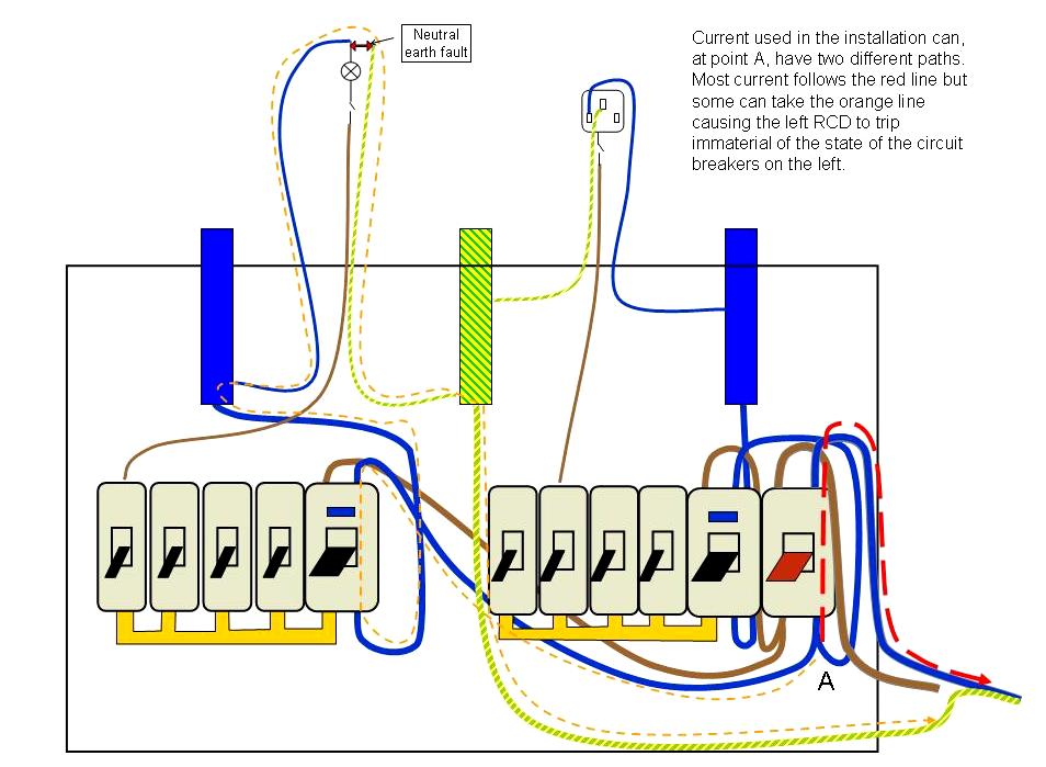

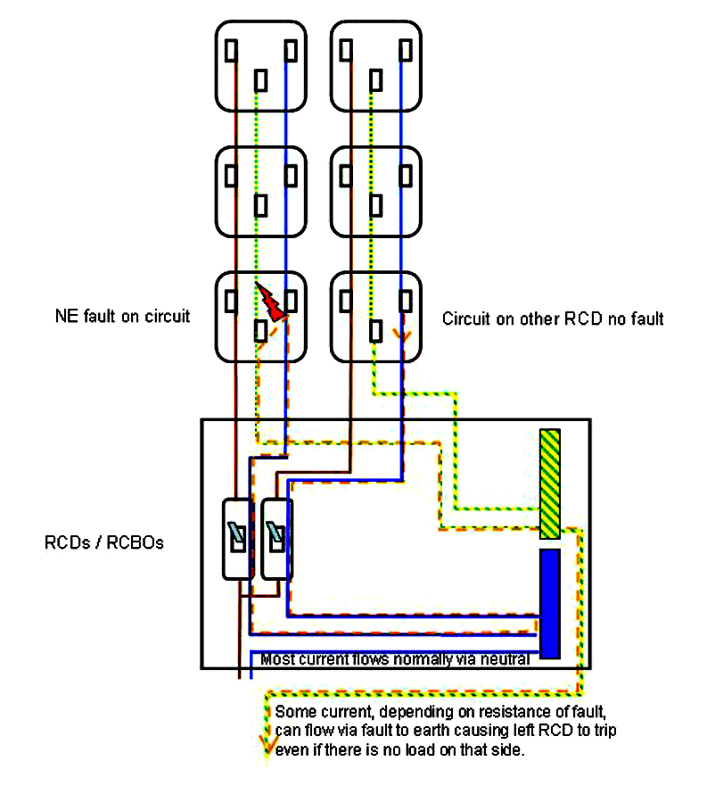

Some of the more experienced chaps have said 'shared neutral', I can't see how this is possible so must be missing something? Doug says it trips when a 'significant load' is placed, if it was a shared neutral between rcd1 and 2 then it would trip immediately when anything on the circuits 2/3 on RCD 1 is used. Also, it would be a bit of a coincidence that circuits 2 and 3 have a shared neutral as well?
Doesn't it sound more like an accumulation of earth leakage? Richard Burns had a good diagram showing how a fault on one RCD could still cause the other RCD to trip (not a shared neutral).
I think crossed neutrals is the immediate default, said it myself. But as you say it may not be the case.
With a neutral earth fault on a circuit some current can be redirected from other circuits through the RCD protecting the circuit that has the neutral earth fault causing it to trip.
If only a small amount of current is diverted then only a large current loading on the other circuits could cause the trip.
Possibly this or this diagram?
Circuits 2&3 have a poor neutral somewhere,
causing some of that neutral current to find a path thru the other side
which must have a better neutral.
Check ALL neutral and earth connections.
you could try using an IR camera, look for hot spots.
