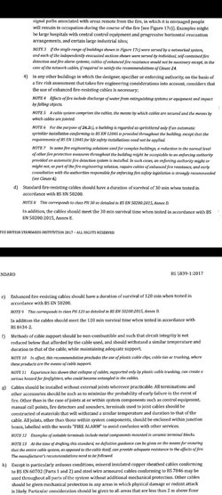

LS0H cables should not be necessary, especially if the existing cables are PVC, unless specified by the local authority for this type of building.
FP/MICC would be th requirement here, not sure if there is a LSOH/LSF variant of FP, or its already LSOH/LSF by construction. Clause 26.2 refers.
