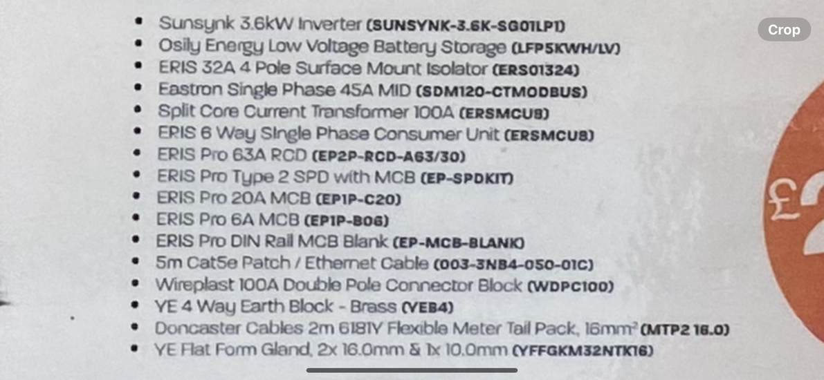

The details of the supplied components;
For 2400 all in…. What I don’t use can be stocked for other jobs.

Here is a link to the "Datasheet"
Things that leap out are: Start up voltage is a little higher than other available systems, means it starts up later in the day and drops out earlier in the evening , not really a big deal but it is there.
Also your existing string voltage max is probably higher than this inverter can handle with 16 panels on one string.
To know for sure, double check you only have two DC cables connected to your existing inverter, get the product details of your existing inverter and if you can details of your existing panels and confirm No off.
Also remote monitoring appear to be an option - i.e. pay for a wifi dongle or the like
Otherwise this product appears to do what you want it to do
