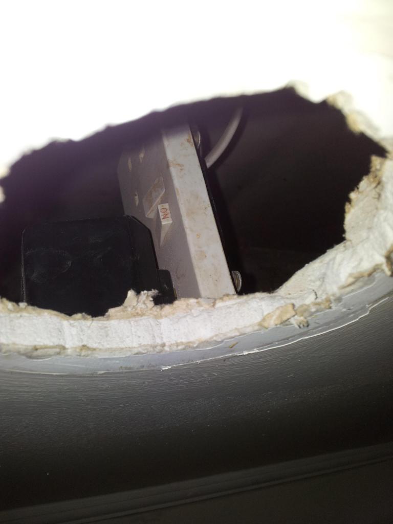

Customer asked me to look at why a downlight wasn't working. Removed it to change transformer and was astounded to find a 13a plug-in transformer pack into a socket (with no backbox) terminated on the end of the lighting circuit in the ceiling!
Amazed.
