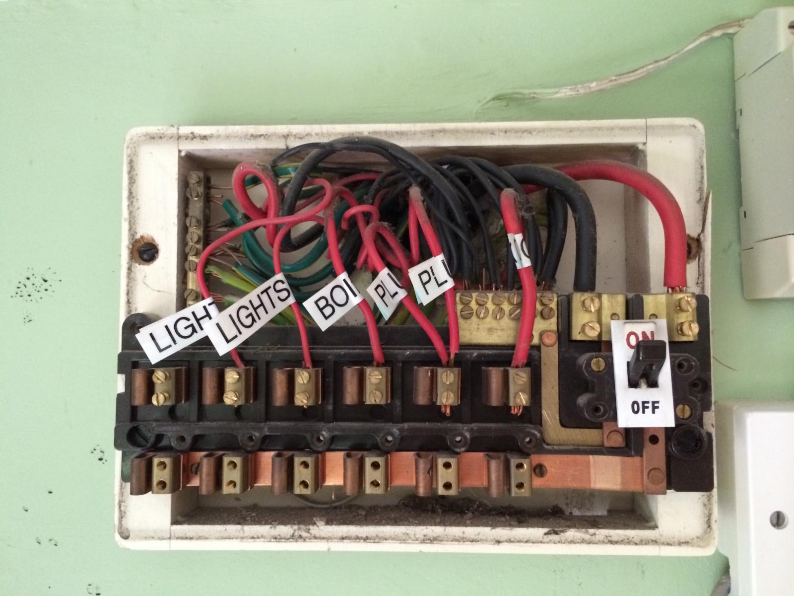

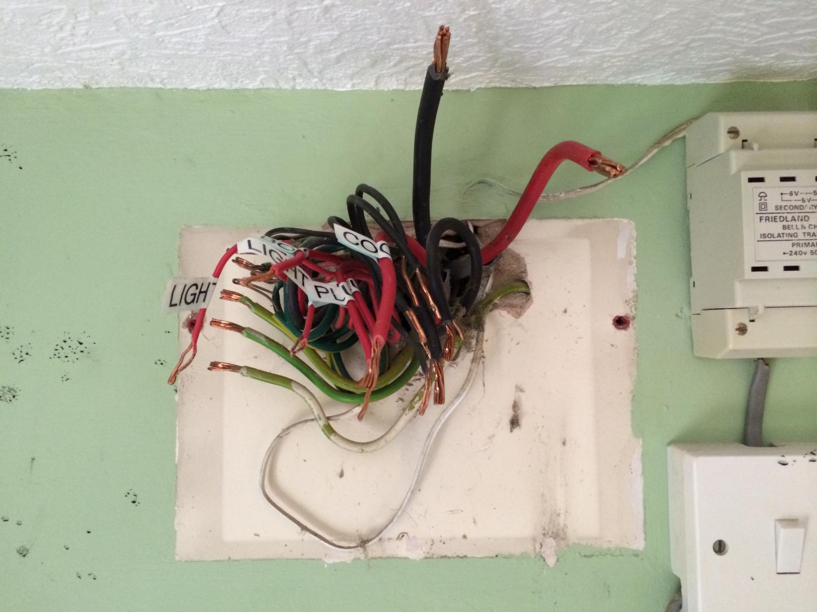

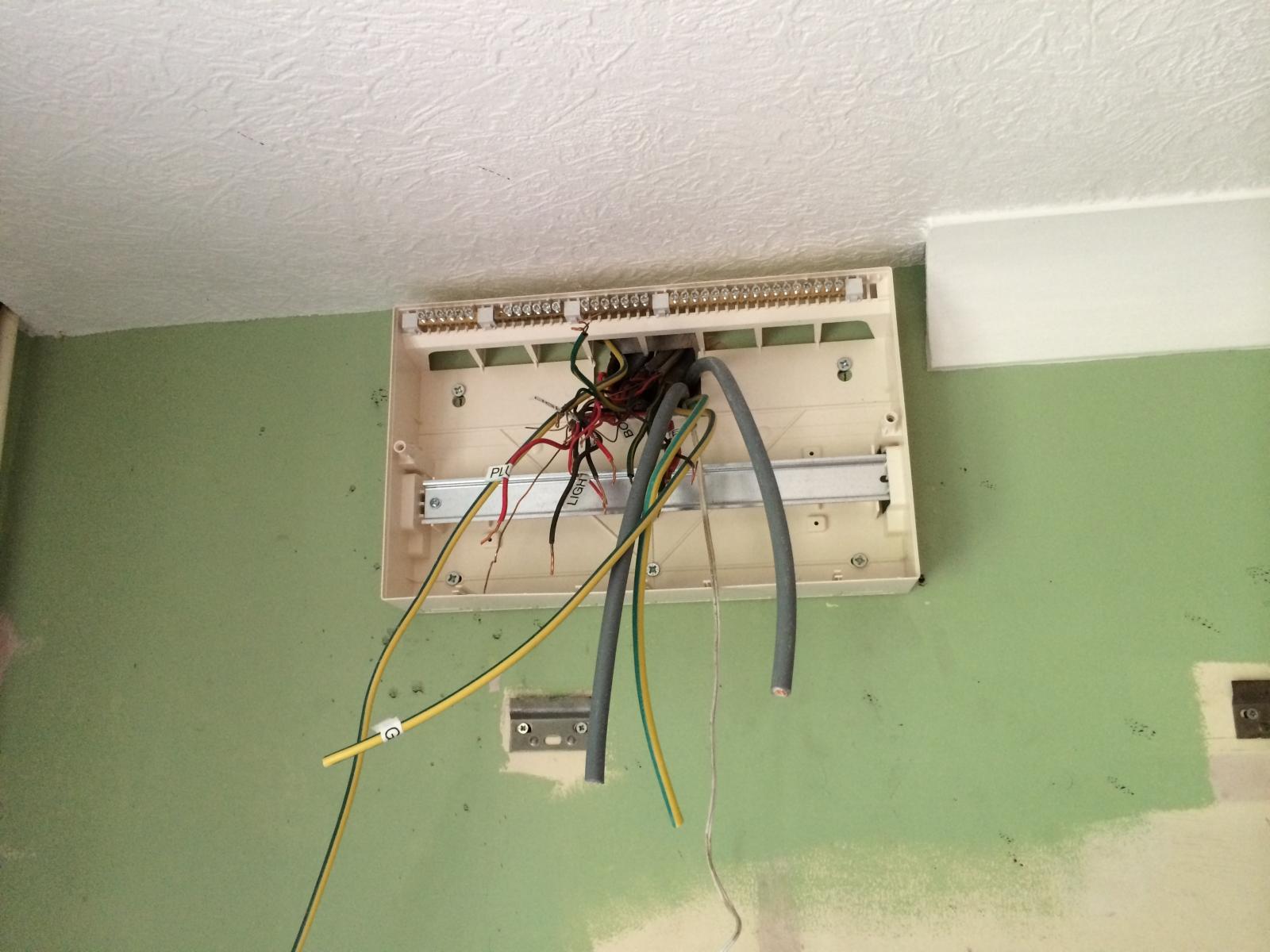

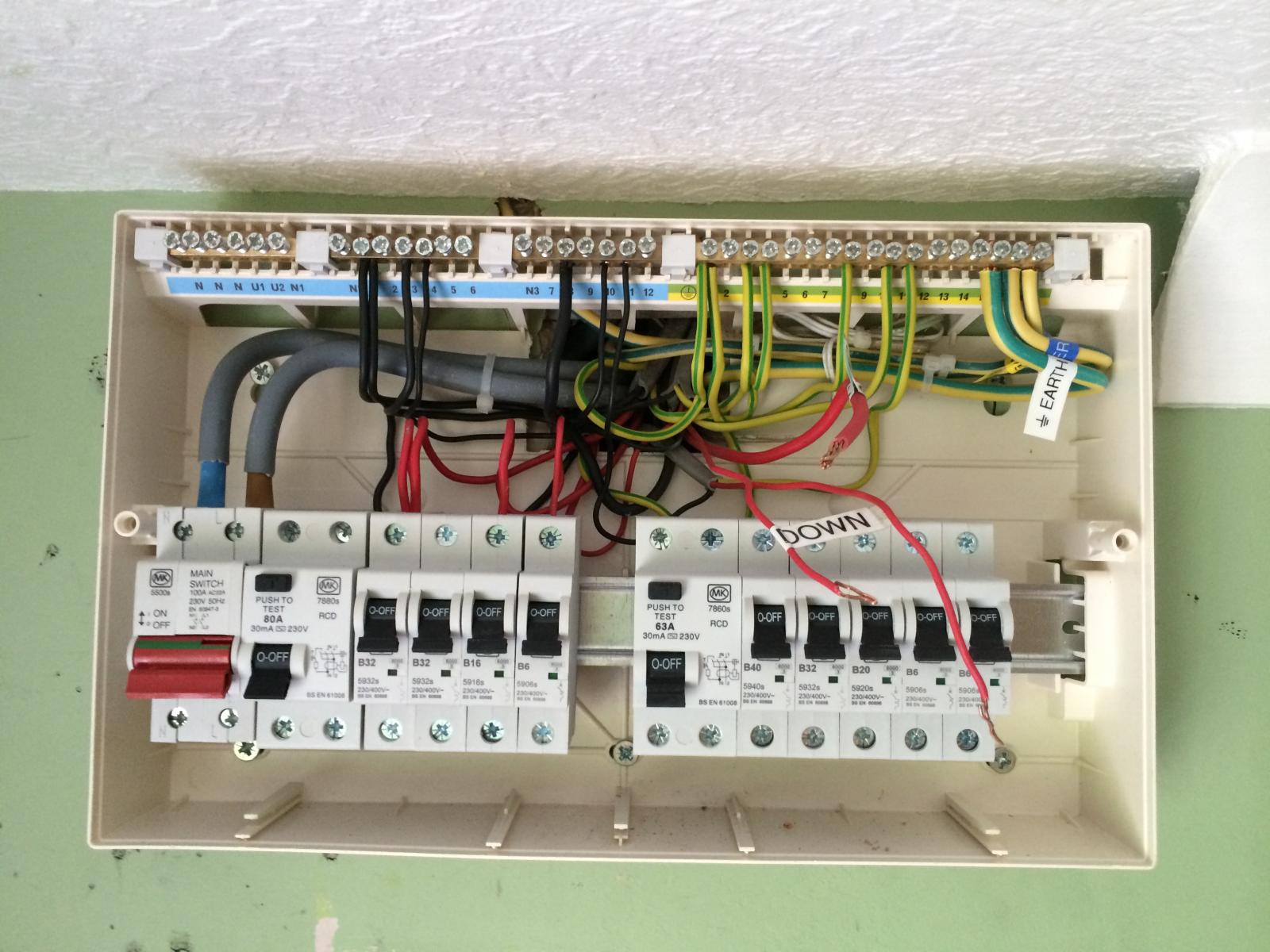

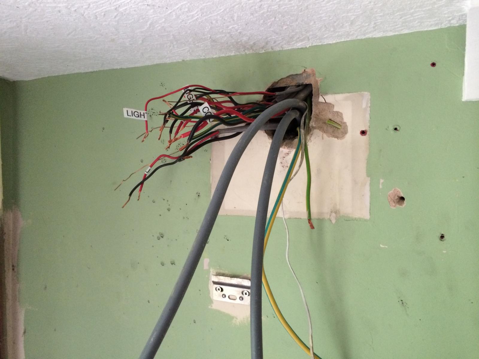

Just thought id share my work with you, I did this board change this morning, I was contemplating extending the circuits, but managed to get it all to fit quite well, quite neat considering.

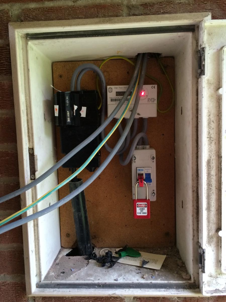

Had to put new bonding in and tails and main earth which was a pain dragging it down through the cavity. I had to pull the main fuse in the end despite having WPD out last week to fit the isolator, I then realized today I couldn't get the earth in without removing the fuse!
Started at 7:45am and finished a 1pm, fully tested, inspected and all paperwork done.
