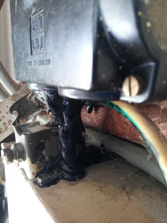

I have just completed an EICR and came across the following :
TN-S with a BS951 clamp and black tar covering supply cable? black tar on supply cable - EletriciansForums.netTN-S with a BS951 clamp and black tar covering supply cable? BS951 clamp on TN-S - EletriciansForums.net

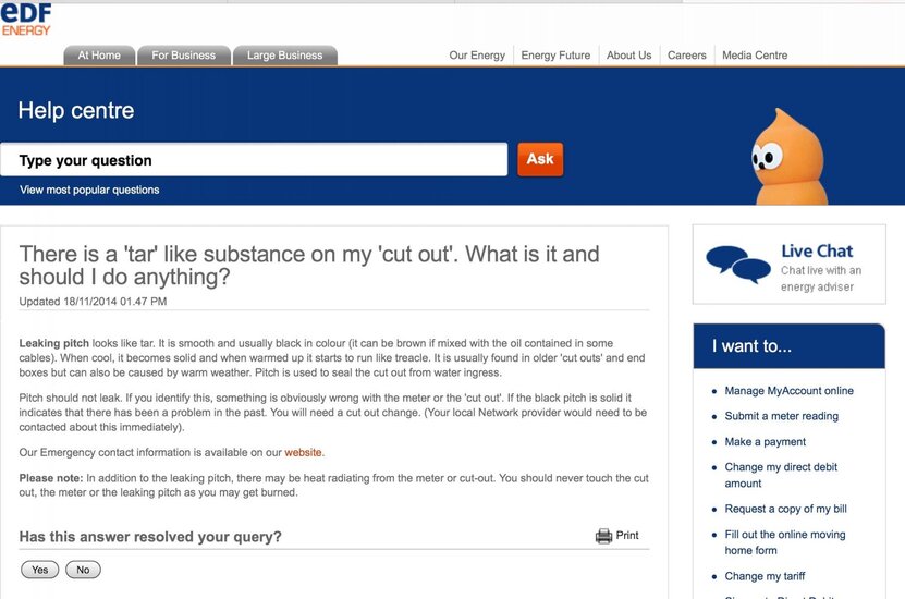

1. Is the black tarry substance Pitch?
The homeowner is unsure how long it has been there, however it is not completely solid and is slightly sticky to touch indicating that it is still getting too hot at times and leaking? I will be contacting DNO but wanted to get some more information from those who are experienced with this?

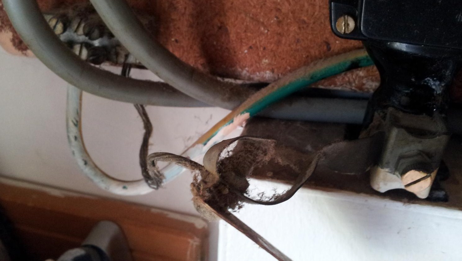

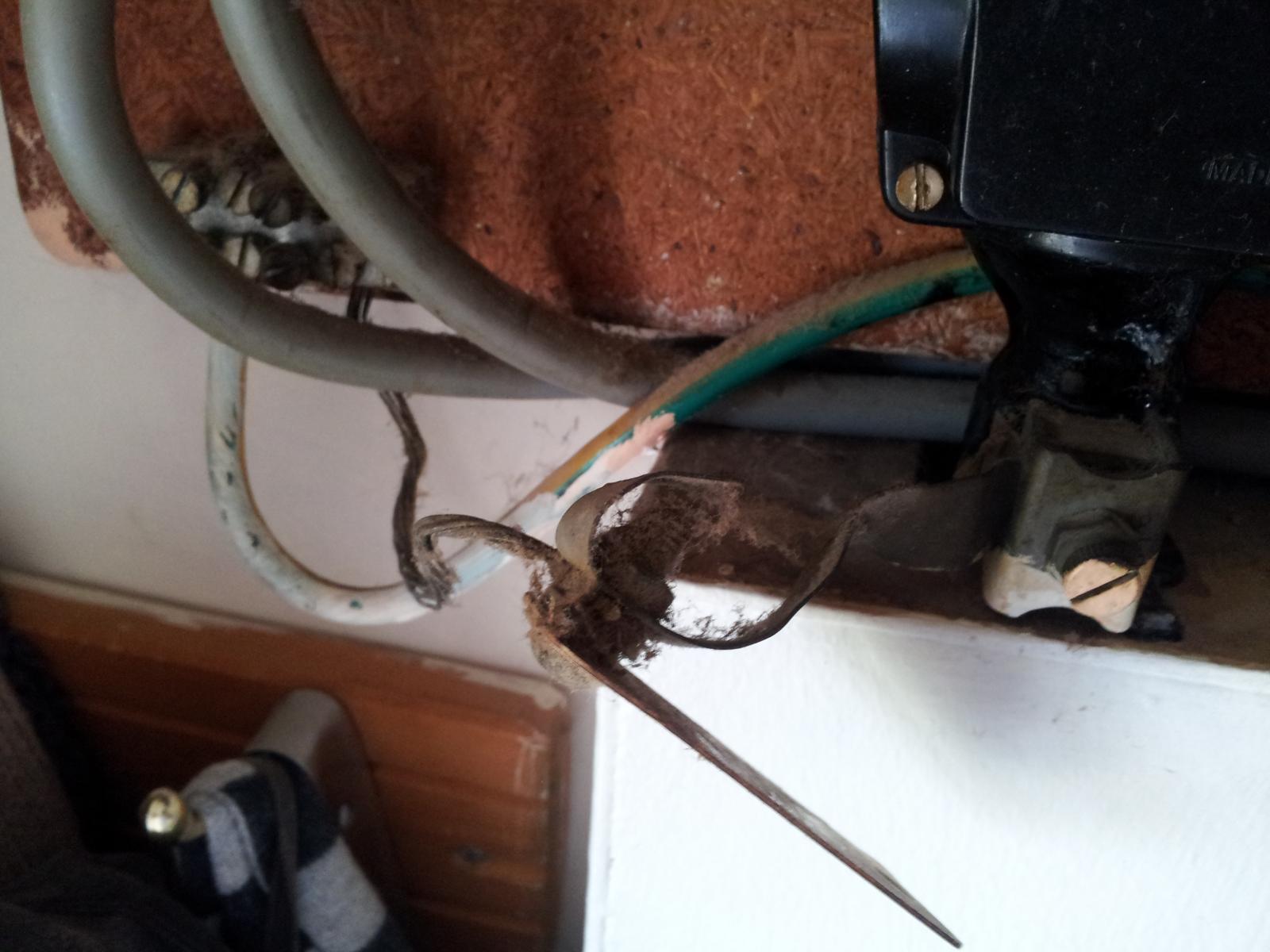

2. TN-S is supplied by a BS951 clamp which I understand was done for a period. My concern is that the 6mm bare cable from the clamp to the MET is just connected to the sleeve of the clamp that is moveable. It is a firm connection to that part of the clamp via the bolt, but just looks awful. I'll tell the DNO about this as well but again wanted some opinions please?

They will always attend site if it's leaking pitch. whilst southern electric are there get them to install the correct earth clamp for the incoming cable for the main earth connection.

It would normally suggest overheating within the Cutout joint

Also, I cant believe that clamp connection is ok. I can understand that BS951 clamps were used for a while, but that is not my worry. It is the way it is connected to the clamp. Again.. not an emergency as Ze=0.14, but it's hardly a very stable looking connection to the flapping sleeve of the clamp is it??

That doesn't look like a bs951 clamp, it looks more like one of the older mechanical clamps for lead cable. Have a proper look at the construction of it to be sure. The construction of the lead clamps is a bit different to a 951 clamp with a curved plate to fit snug against the lead and not crush it. Clamps like that are not uncommon in the SSE area.
Also that is not a 6mm bare conductor, it's an imperial, probably 7/029, conductor.

Thanks Dave,
It does look slightly different to a 951. It is more they way it is connected. Can you see from the picture what I am getting at? The fact that it is connected to the flapping sleeve rather than firmly against the clamp as you would see with a 951?

I am familiar with that type of clamp yes, it's quite common in the SSE area. There is another one which is just that length of that band wrapped round the lead sheath with a bolt and two wedge shaped nuts to hold it tight, then a nut and bolt with a castle washer through the band in exactly the same way.
Is there a castle washer on that termination?
