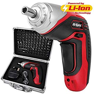

No to the impact driver, but I am interested in a weak willed wizzy winder to help with my poor aching joints. Any suggestions welcomed :) .
Being retired I have no idea what a "weak willed wizzy winder "please Wilko, enlighten me.
cordless screwdriver. like :
50097
The Bosch Go 3.6V driver seems to a be a popular one. Not got one myself though. Have to get them online as they are not UK release.
have to admit i have a ryobi one. on the + side though it has variable torque settings.
usefull for running them up, then manually tighten to correct setting. whether by experience or using a torque driver. personal choice really. also find usefull when fitting longish 3.5's in sockets.
I have used electric screwdrivers in the past for running fixings in but never tightening up.
