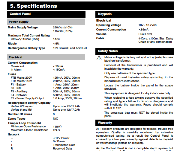

There is no 125mA fuses on the Veritas 8 panel, incoming power F5 1.6 A
F5 1.6A fuse is for power supply output.
In the manual on page 27 Specifications. the first fuse listed is FTB Mains 230V 125mA, 250V, 20mm
There is also a label on the transformer saying 125mA, and the original fuse fitted from new was 125mA and the spare fuse in the casing was 125mA.

You say you have you have changed the box and strobe box, there's the clue.
specs from manual
So you are stating the incoming mains fuse terminal is blowing, not the pcb F5 fuse. If so this, this can be only 2 things, battery is over 5 years old and on its way out, or mains filter fault....you can remove filter, not needed on Veritas
