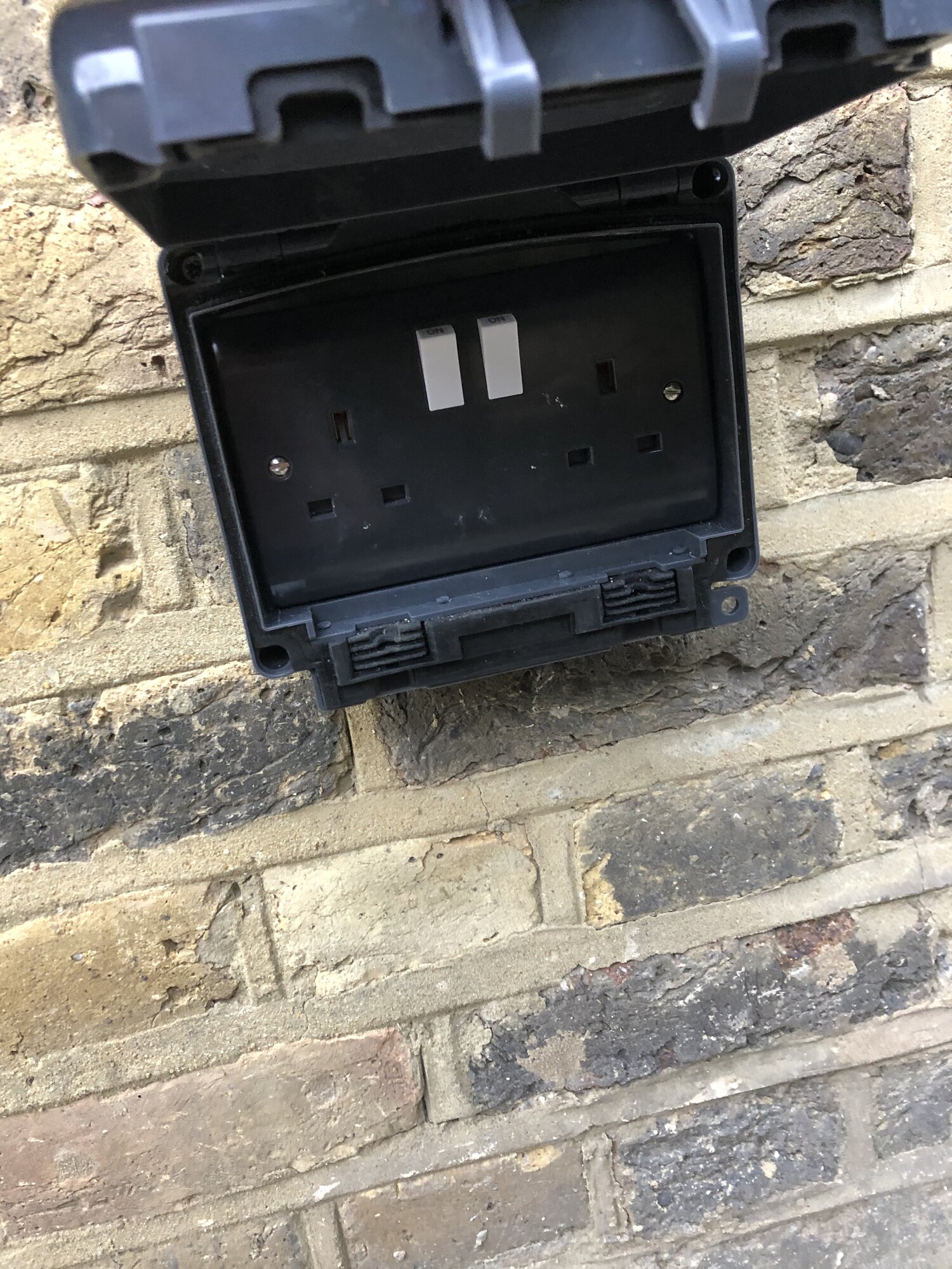

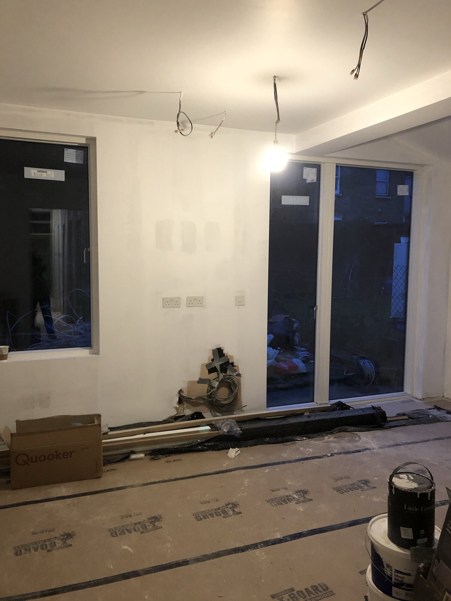

I’m not an electrician so seeking advice as to whether my requests were actions correctly or if I need to arrange for additional / remedial work to be done.
During the first fix of a renovation I told the electricians working on my project that I planned to put an office / studio in the garden at a later date & could they run something outside that would be suitable. They told me that they’d install an external socket and that any connection could be spurred off that for an office constructed at a later date.
I am now in the process of getting quotes for the studio and not sure if the external socket will be enough? The renovation isn’t quite finished so although it would be a real pain to run another cable from the fuse box it would be easier to do it now rather than later.
I attach pictures of the cables that are running to the outside as well as the external socket (this one OA036AG) . We would be planning to have a couple of 230v sockets (charging laptops etc) and some lights.
Would be grateful for any advice,
Nikki

It depends very much on what you want to have in the office.
A feed off that socket is likely to be limited to 13A so OK for powering a decent amount of LED lights, a PC or laptop, and a single 2kW heater (not full 3kW). So quite small and limited, but if that is all you plan on doing there it is fine.
If you want a lot more (hot tub, several heaters, etc) it is going to need a dedicated feed and a lot more design information for sizing that.
Whether or not you can spur off of that socket depends on what the existing wiring an circuit arrangements are to the socket.
If it is an unfused spur off of a ring final circuit, which is what most external sockets would be, you cannot extend to your studio, unless you install the fused spur BEFORE this existing socket.
Looking at the size and quality of the building you are constructing, I feel it would be a mistake not to install a decent size feed (min 10mm2) direct from your electricity meter.

Is the outside socket you want to spur off ofa spur already, or is it part of the RFC??
@Pete999 I'm sorry I'm afraid I don't know. The external socket has its own wire from the fuse box if that means anything?

If there is a breaker in the CU (fusebox) that is labeled outside socket only, and this is true, then you can go on from it to your studio. Not even a fused spur is required, as long as the cable to the studio is of an adequate size for the rating of the breaker.
This would be fine if you were building a small garden shed, but I still say you'll eventually regret it if you don't give this place its own largish dedicated feed.
What is the rating of the breaker? (likely B16, B20 etc.)
For the sake of a few hundred quid , I would buy some 4mm swa and put in a dedicated 30a supply
you are spending thousands on a nice outbuilding , why skimp now
The outside socket might be wired in 4mm... We may find out...
i like working with 4mm swa and 30amos is plenty for most domestics
10-16mm is overkill for domestic office power
