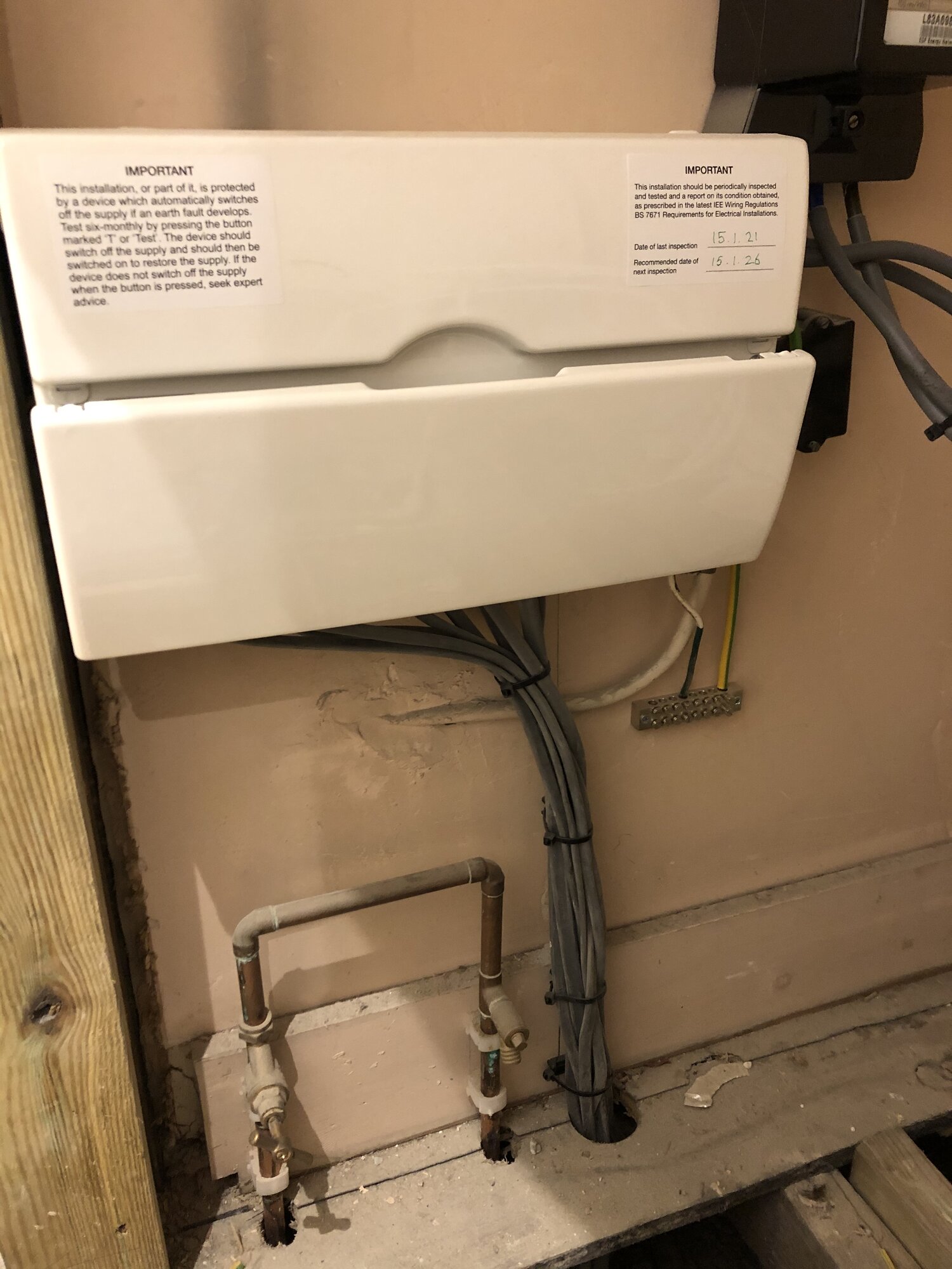

I’ve attached a photo of the fuse box & the cables coming out of it...Not totally sure what I’m looking for?!

Outside socket is on a 32A breaker
Bugger, @brianmoooore beat me to it.
You might be in luck of the outside socket is in 4mm cable you could piggy back off this

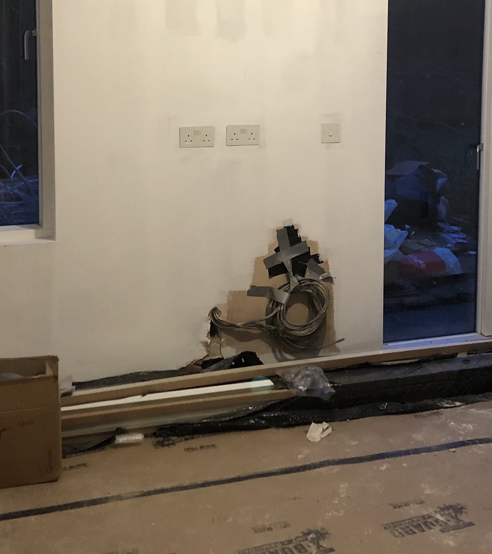

Thanks. How would I find this out?! Here are the cables before the kitchen units were put in - it’s one of these...you can see the hole in the wall to the outside. I’m not sure if this is what you’re asking me though!
I'm not sure what I'm seeing in that picture. It looks like coils of cables with about 4 cables going into the wall from the coil.
Is the outside socket behind the coils?

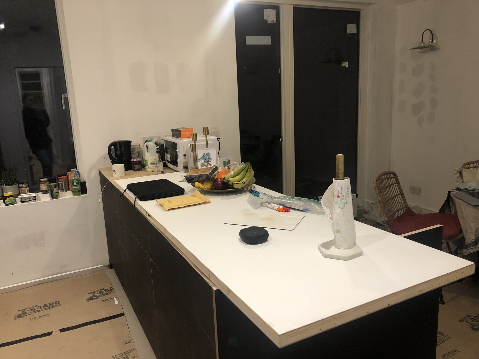

Sorry it’s not that clear is it! The outside socket is directly behind the wall with the wires on it - the kitchen is in now (well nearly - as you see) and the induction hob and a socket will be in this island bit, hence all the wires.

Very roughly, what is the distance from the external socket to the new studio?
In that case, a 32A supply to your studio should be possible. Go on from the outside socket with 4.0mm2 or 6.0mm2 3C SWA to a small non RCD consumer unit in your studio.
Only downside, is that the RCD for the studio will be indoors on the main CU, so if it trips you will lose all power to the studio, including lights, and you will have to go indoors to reset it.
