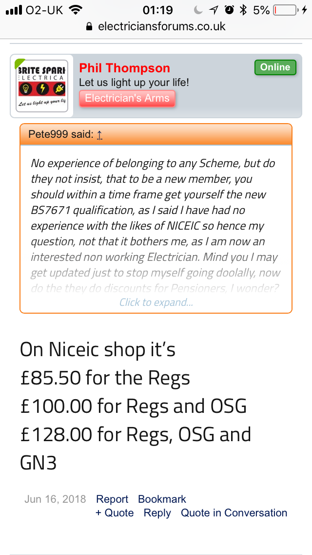

Just checked on the Niceic Shop as i had looked a few weeks ago.
The 18th Ed regs are £95.00
The Regs and OSG are £112.50 and they no longer do the Regs, OSG and GN3 pack
But here’s a screenshot of the prices as checked on the 16/6/18.
Can anyone who actually has a copy of the 18, let us know the max Zs for a 32A type B MCB/RCBO?

View attachment 43137 Just checked on the Niceic Shop as i had looked a few weeks ago.

Napit Online Shop is doing it at those prices.
The kicker with most of the online sales is that Northern Ireland will be extra delivery, usually £10-£15+VAT.
