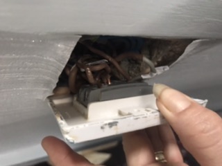

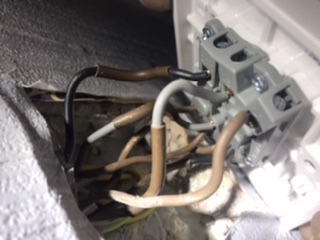

help please made a really stupid mistake and can’t figure it out ,
i have a 2 gang light switch at the bottom of the stairs this controls upstairs and downstairs stairs light also downstairs is a 1 gang 2 way switch, upstairs there is a 2 gang switch that controls upstairs light plus bathroom,
the light switch broke at the bottom so i tried to change it but didn’t take note like ? now i’m knackered
it has 8 wires coming from the wall
1 black brown sleeved
1 black white line sleeved brown
1 grey sleeved brown
4 x brown
1 of the grey has a brown with it
1 black has brown with it
2 browns together
2 single browns
the new switch has 1 way 2 way 1 way 2 way com com
but not a clue where they go now as i never took a picture
can this be fixed with help or am i ?
i’m in the uk as well
rewired about 10 years ago
obviously the wiring to the switch isn’t right because it doesn’t work !

You will need to contact an electrician who can test the wiring on site, trying to work that out over the internet will take a very long time. There are many possible incorrect combinations.
There is a risk here of interconnecting two circuits and creating a potentially dangerous situation if you try winging it. Definitely worth getting an Electrician in.
As far as I can tell it appears to be 2x 3 core cable and 1x twin brown
agree. the downstairs would appear to have the L and s/l in L1 and L2 + 3 core strappers, and the upstairs just the 3 core ( with the L and s/l in the upstairs switch ). 1/2 hour to sort for a spark.
as above. if you've not messed with disturbed the upstairs switch, we can then see what's what.

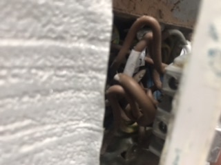

without taking if off it’s hard to get better photos

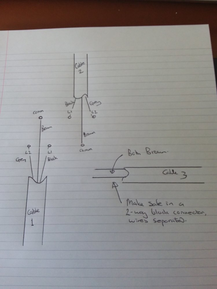

Difficult to see from those pics. Here is how I suspect it should be connected. I assume the back of your new switch resembles my drawing so connect as shown but keep each cable with the brown, grey and black to its own switch. For now make the cable with the two browns safe in a connector but with the wires separated. Theoretically one light should work, once we know this we can say where the other cable goes. ISOLATE ALL POWER FIRST.
What have you done with the cable which only has two browns, if they are connected together the light will stay on. They need to be separated and kept safe for now.
Is that last picture the landing switch, please tell me you haven't interfered wìth that one.
my right controls upstairs now on off my left does nothing downstairs light won’t turn off
strange thing now to the upstairs light comes on with the bathroom light ?
[automerge]1583061729[/automerge]
put them in a connection box behind
