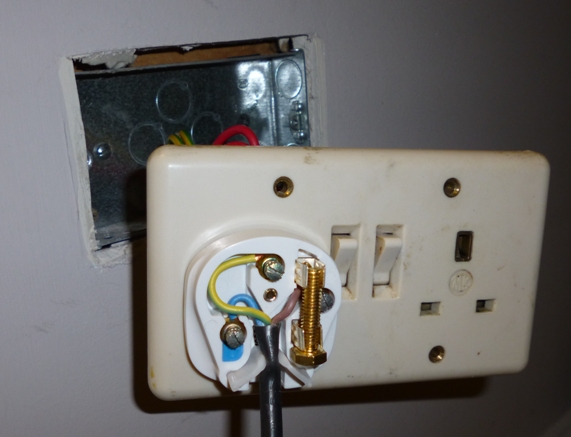

Got a 4.5kw water heater that comes with a 1.5mm2 flex from the manufacturer that looks like its meant to be wired into a 20A DO switch. My question is, isn't the size borderline as 4.5kw = 19+ amps?
Thanks
Edited from 13A

Most appliances still have their power ratings quoted at 240V not 230V, if this is the case here it will be 18.75A which is fine for a 20A supply. The power at 230V will be less.

4.5kw water heater On 13A spur.
