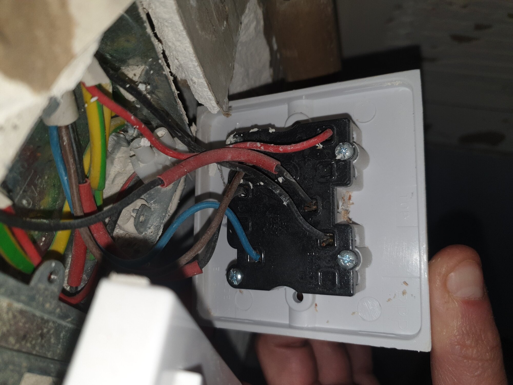

We are having a new kitchen installed and have changed ll the sockets / switches to a stainless steel (Like below)
There is a boiler switch below the boiler which i cant seem to find a switch for. Can i just use a fused spur? any advise would be great. I have found 3 pole switches but they all say "fan isolation" on them
You might need to get an electrician to trace what all the cores are doing.
Normally there is just a switch fuse that isolated the entire heating system.
I don’t think I’ve ever seen a 3 pole isolator on boiler circuits??
I suspect the 3 pole switch has been used to replace a programmer that would have originally been there.
The simplest fix is to fit another 3 pole fan isolator.
If the adjacent spur is the sole supply to the heating system (can't see any sideways interconnection) or if there is a single spur supplying the heating elsewhere, then the 3 pole could probably be eliminated by using connectors then just have a blank fitted over, checking would be required.

So that is a 3 pole switch? ill just buy one that says Fan its thats the case

You might be able to find one that has no writing on it.
As suggested above though... if the 3 pole isolator isnt actually doing anything... (do you turn it on and off frequently? is the whole heating system also isolated elsewhere?) then you could joint through each switch and cover with a blank plate in the decoration you need...

I've purchased the below. Will this be ok do you think ?

Provided it's wired to simply call for heat/water or not, which is most likely, then that 10A switch is fine - most heating programmers only have contacts rated at 3amps anyway.
It would be interested to know if there's a fused spur elsewhere for the boiler, and whether it has a wireless programmer/time clock as many do these days. Do you ever use that switch?
It will be to isolate the boiler locally, assume the heating controls and wiring Centre are elsewhere with their own isolator. So there will be a permanent live, neutral and a switched live for the boiler. That 3 pole isolator most likely is to disconect those 3.
EDIT although looking at the photo again, I'm not so sure.....
I'm not 100% sure either. I'm not sure any of us can be without a closer look at what's going on there.
But In a sense it only matters either way if the switch rating matters.
