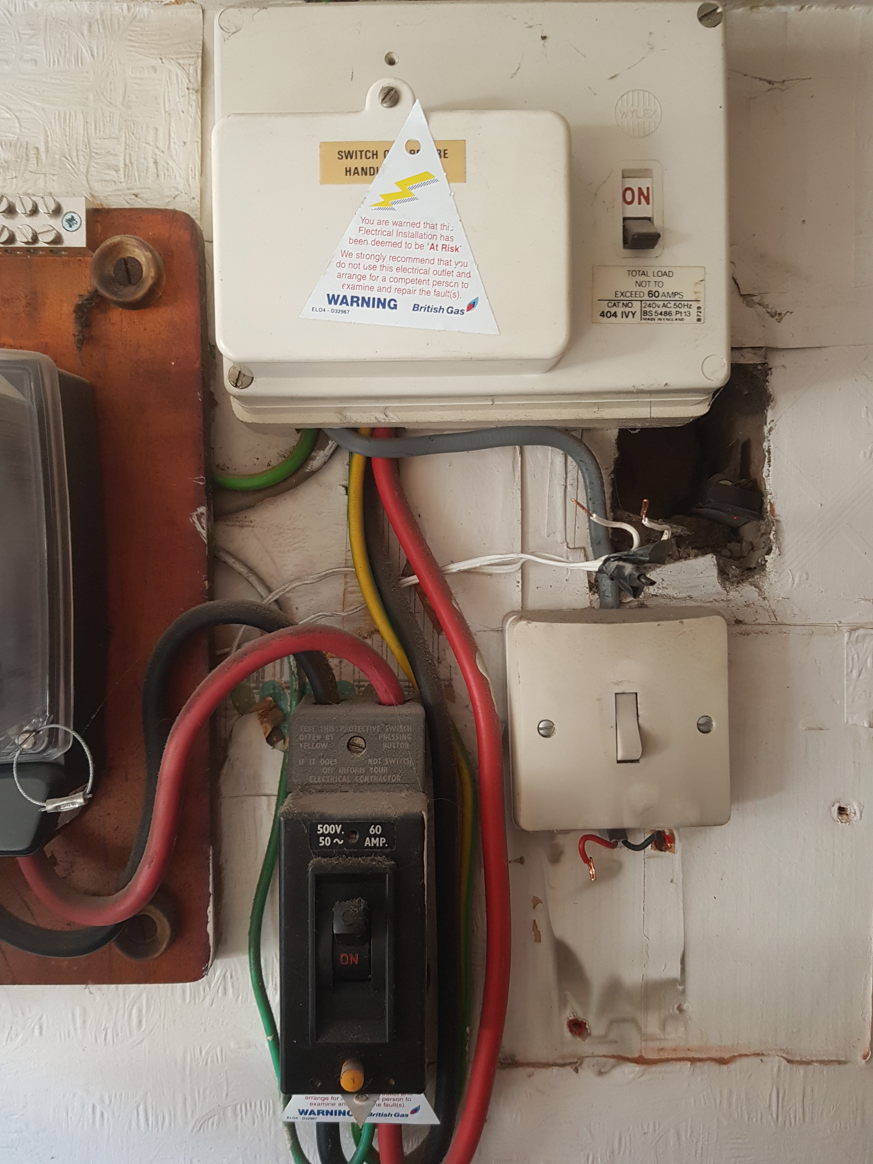

Am at a house today to change the board prior to other works.
Old rewireable board upfront RCD no earth. the earth from the incoming cable was short and just sitting in free air. Had DNO to attend to pull fuse as cutout was old and seal fairy was on holiday!
British Gas still fitted a brand new combi boiler earlier this year to replace immersion heater! spurred off the ring final that covers the whole house, has upfront rcd protection. no earth to property other than a Zsdb reading of 58.2 via the gas pipe!

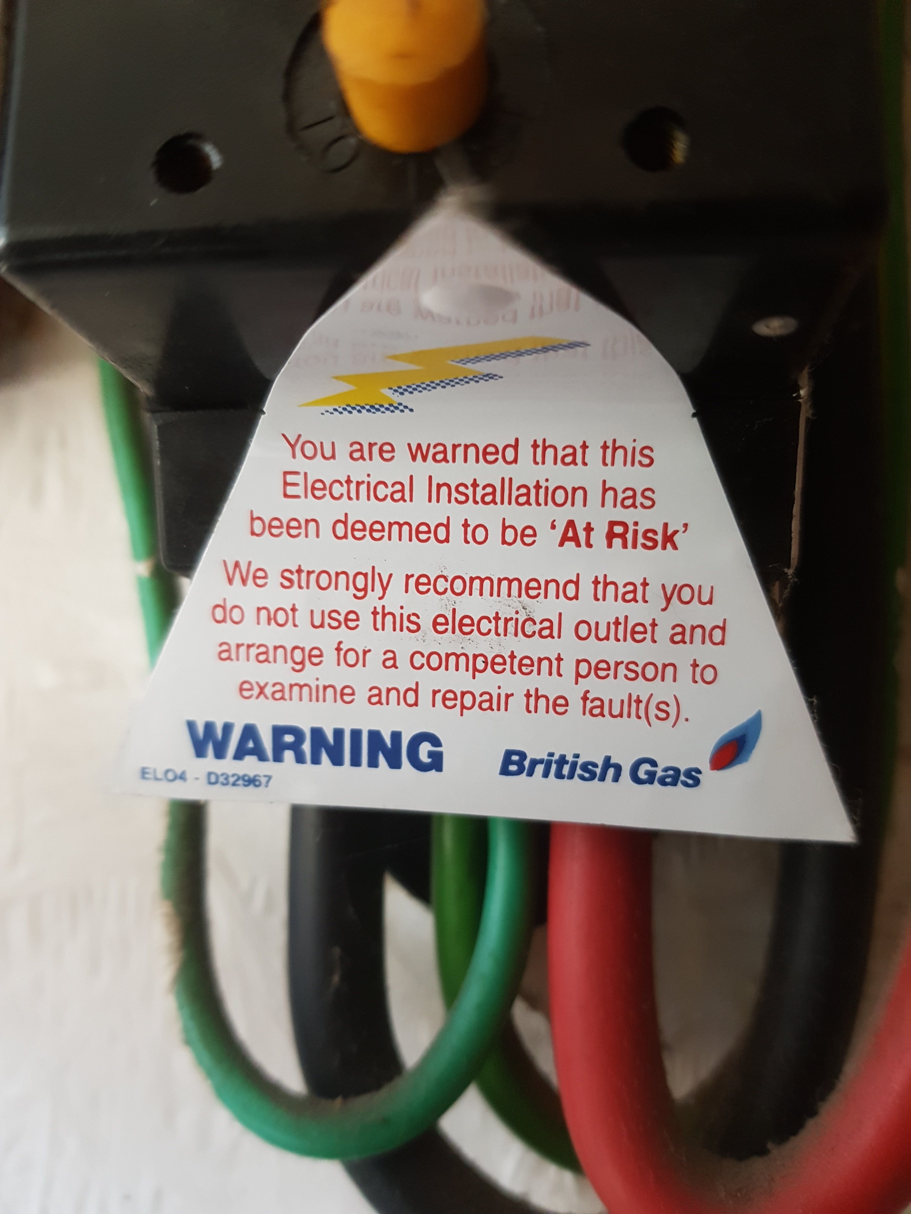

Interestingly, British Gas stuck stickers on the RCD, Old Cu saying installation at Risk!
If it was that dangerous and at risk why did they proceed and install a new boiler with the faults/lack of earth present? Surely they must realise this is non compliant? Clearly wanted the money and scarper!
On the upside, there was a crack in the lead sheath just before cutout where the door had hit it too many times (which i hadnt noticed) so got a nice new cutout aswell now with a Ze of 0.17.
It amazes me that people trust the British Gas name so willingly and pay the sometimes vastly inflated prices for the work. Albeit sometimes it is not even BG guys doing the work but sub contractors.

iv'e seen cowboys leave places in better condition than that.
p.s. what is the bare red cable coming out of the light switch all about?
I had just taken the transformer off the wall myself when taking pictures, had to stop and take them as it just struck me how bad it was of them to leave it like that with no earth, the transformer is currently on customers book shelf to go back up when they get a new chime. the switch didnt actually have the out going wires connected up inside. so they are not live.
Should have added to the original post it isnt actually an RCD upfront its one of the old VOELCB things there is a small green wire out bottom of it that at one stage went to a rod, it is disconnected from the remnants of the rod as said rod sits outside front door covered in dirt with no clamp or cover. Dont see many of the voelcbs around these parts nowadays as they have mainly been removed. I often get them confused for the similar looking upfront rcds. the small green wire pokes out the brick work out front where its been cut off and covered with some sealant.
