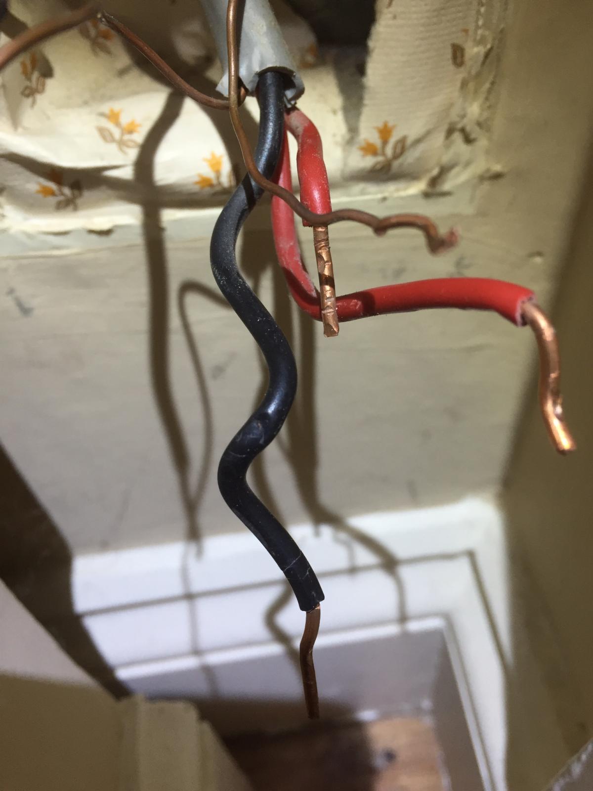

I got called out this evening to a tripping RCD on a TT install after a lightening strike in the area.
Its quite an old CU with mcb's and a standalone 100ma RCD on the tails between the supply and the 100A DP main switch on the board. The RCD would switch on but as soon as the CU main switch is switched on it trips the RCD.
Tested the Ra and it was 155Ω, so not brilliant but within spec for TT.
I did an IR between the CPC bar and neutral bar and found a dead short, so I disconnected all the earths from the bar and reconnected them up one by one until I found the offending circuit causing the tripping which was the ring final for the lounge. Unplugged everything, still short between Neutral and CPC on the circuit.
I split the ring and found which leg is causing the problem but it was getting late and I didn't get a chance to go any further as they had a young family they needed to be put to bed. I explained that I had to leave the offending circuit isolated on the board and locked it off so they couldn't switch it back on. I am going back tomorrow morning to split the ring further and hopefully find the problem.
I live not far away and there a massive lightening strike in the area and according to the owner it was very close to them. My only conclusion at the moment is that a voltage surge from the lightening has travelled up the earth rod, as there is no surge protection, it has somehow managed to breakdown an existing fault between neutral and cpc and has made the fault worse to the point that it is now causing the RCD to trip?
Does anyone have any more logical explanations as to what has caused this problem to appear all of a sudden?

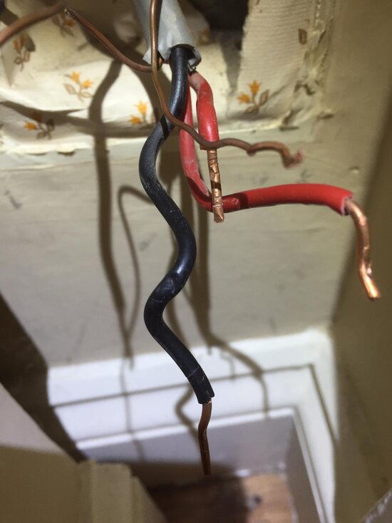

Problem fixed. Split the ring down, probably about 12 double sockets and some spurs . Found the short on the last leg of the ring between two sockets. Opened them both up and the last socket on the ring was the only one with no CPC sleeving. On closer inspection there was the tiniest of nicks out of the neutral and the unsheathed CPC was resting against it, so possibly caused by heat between the two wires? Tested IR again and got >2000 on all combinations. The owner is adamant that the problem occurred at the time of the lightening, I don't know if it is possible that a voltage surge caused the CPC to heat up and just push the insulation on the neutral over the edge?

Yeah could be heat between the neutral and CPC. Once the insulation breaks down a little, some electricity could leak to the CPC, and this then gradually worsens over time. The lightning strike may well have been a red herring and just coincidental. Always nice to rectify a fault. Can be a pita at the time!

When there is a lightning strike there can be a huge voltage difference between the local rod earth and the voltage at the earth of the local transformer. Also the overhead cable is a huge aerial with the N earthed at the local transformer, these effects combine to make for a huge N to E spike that could jump a small gap...

Thanks I figured that it was something like this I was just looking for clarification that I was thinking along the right lines. There was obvious signs on heat on the insulation of the neutral. I took a picture which I will try to post, so that people can see how small the hole in the insulation is.
