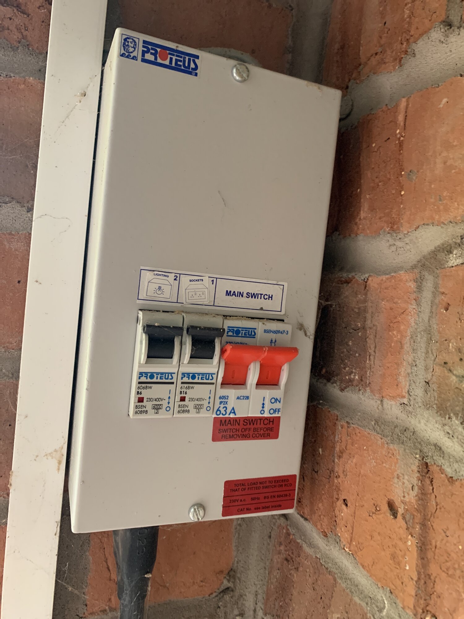

This is one side of my split consumer unit. I’ve just turned off the RCD and the garage power went off as expected. So proves the garage feed is RCD protected?Can I connect an outdoor socket to a junction box which feeds my garage? image - EletriciansForums.net
This is the junction box I want to take the feed to the socket off. Back cable is direct from the main consumer unit and bottom SWA cable going to the garage consumer unit.
And this is the garage consumer unit that the SWA cable from the junction box feeds.
I’ll assume the SWA is earthed properly at the garage end. (Banjo with flylead to earth bar)
Not a problem adding an exterior socket to this circuit from the joint box.
As above, check that the armour of the SWA is really earthed at the garage end (it should be as metal box, but might not be properly bonded if it lacks an earth wire to the "banjo" (earth tag, see it in the plastic junction box).
You should be able to add a plastic IP68 gland to the box and run some cable from that to your outdoor socket. Replace the choc block with some 3-way Wago terminals for that.
Remember to use cable rated for outdoor use (i.e. UV resistant)! The rubber H07RN-F is one choice, easy to use, but if you want something that stays in place better but is not so hard to deal with as SWA then look at NYY-J
Just dont like those banjo's, piranha nuts are my preference. (with fly led) hope its on the other end.
Yes, having tried the piranha / Earthing Net alternatives I would always choose them now.
But if they already have the banjo then a crimp terminal and bolt would allow a wire to be attached OK.

First time I’ve been inside the garage consumer unit since in moved in and the banjo is not connected to the earth bar! Thanks for pointing that out, I will be addressing that before I do anything else.

The reason to make sure the armour of the cable is earthed is basically safety… even though one core within the cable is used as an earth.
imagine going through the cable with a spade (accidents happen)
The spade cuts through the armour, then into the live… the spade and armour goes live, causing a short to earth, and then causing the mcb to trip. Goes with quite a bang, but it does trip.
without an earth, both the armour and spade become live and STAY live.
Garage CU is metal, which is connected electrically to the earth bar, so, assuming paint doesn't provide an insulating layer, the SWA gland, and hence the SWA is earthed at the garage end. It's good practice, though, to earth the SWA at the source end, and preferably at both ends, so the banjo in the adaptable box should be connected to the earth wire.
Why would anyone fit a banjo, and then connect nothing to it??

Makes perfect sense and very important. The gland is touching the metal box so should have contact to earth, but most probably not earthed well enough as the metal casing is painted.
Exactly what I thought, why add the banjo if it’s not being used! The house is 8 years old, but I’m not sure if this was part of the original installation or if it was an added extra. by the previous owner.
