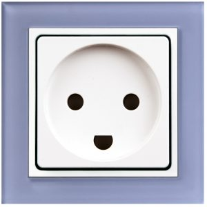

Denmark are pretty quirky all round in terms of sockets. They officially allow installation of Type E and K but also C and F! They have the friendliest looking sockets though:
