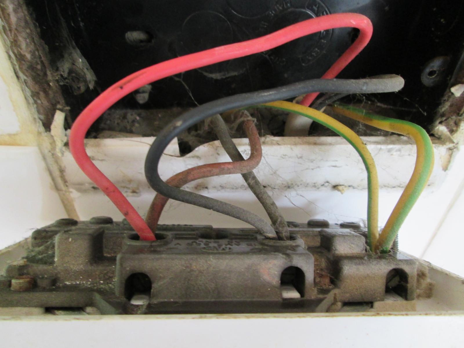

Rewire I'm on at the moment, previous owner done all the work himself, not sure if he was an electrician.............
Twice he'd connector blocked the earth do a conductor core........! Pretty much every connection in the lights and sockets had the cores snipped down as well! A red single coming out of a neutral connector block, don't know where that goes yet it was right at the end of the day, the house is empty though and no power. I don't know how half of it worked, the voltages I was getting at lighting circuits was crazy, ended up being poor connections and some nicked cables. Started of as a partial rewire...........
