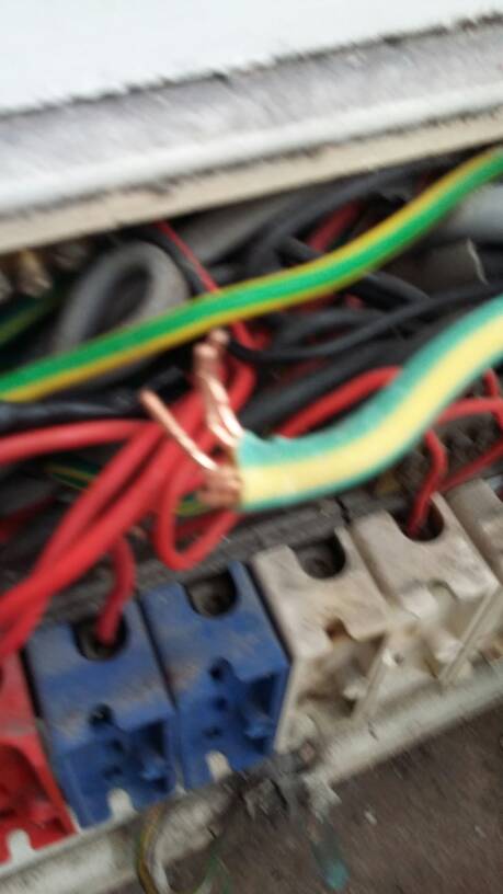

A customer called me and asked if I could have a look at a connection he had performed on his generator. The cable he had attached to the generator was a 3x95mm2 aluminum. The main fuse on the generator was 400Amps! I did not approve.
He might not have a crimp for 95mm. All he had to do is hire one for the day and put the cost on top of the job!!!
It is these sort of things that cause problems for the next electrician. Soon as you see that and you tell the customer that you can not touch anything until that is rectified (at an extra cost), the normal reply is "well, it was done by an electrician and it has worked for years". Time to pick up the tools and walk away.

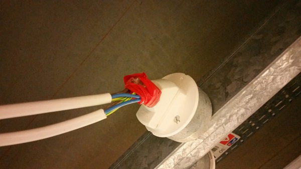

Here is a couple from a job I was called to, the rewire had "just been finished by an electrician friend"
I suppose at least one of the "busbar earths" was correctly identified!

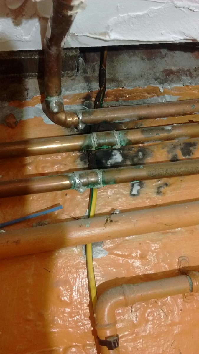

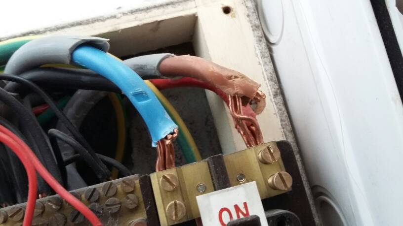

Also have this beauty
These were feeding an garage board supplying an electric shower on a 50A MCB.
Also, the water bond was taken from aforementioned garage board!
Conductor size: three sevenths of 16mm!
