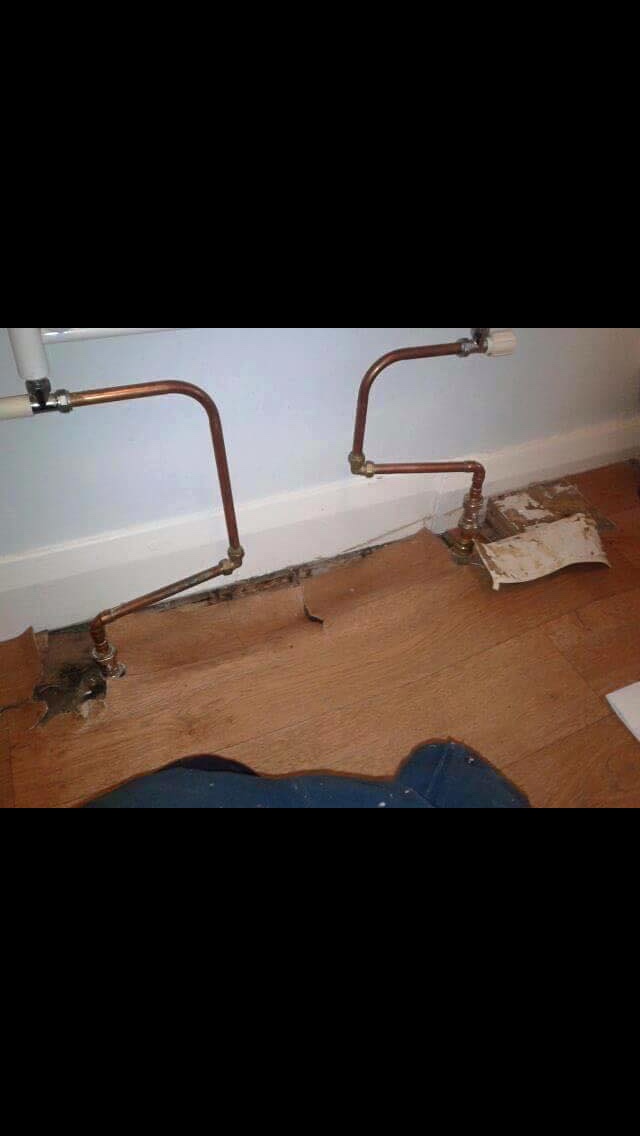

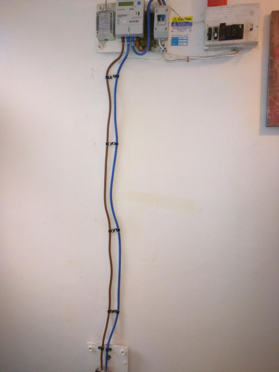

Customer put a complaint in. Apparently someone came out from BG and said the meter monkey did the best job they could and they do not use trunking...! Customer not happy with that response and apparently they are gonna sort it now. I should be getting a board change and bonding job out of it so happy days....and there's even an isolator fitted which is nice!
The slight irony is that the clips are actually pretty straight and aligned. So duck knows why the tails were not attempted to be straightened out.
Got to totally disagree on that, the top cleats have a gap between them, the spacing height between sets of cleats isn't the same by some margin, just because the screws may follow a nearly verticle plane doesn't excuse it, its as rough as you can get and deffo' not done by a trained professional. The true Irony here is I regularly see DIY work to a better standard.
It is rough DW, no dispute. Although the cleats are not perfect they are 100% better, in comparision, to the insanely meandering snaking tails. Kinda reminds me of the signature line of someone on the IET forum; knotted cable makes lumpy lektrik....or something like that!

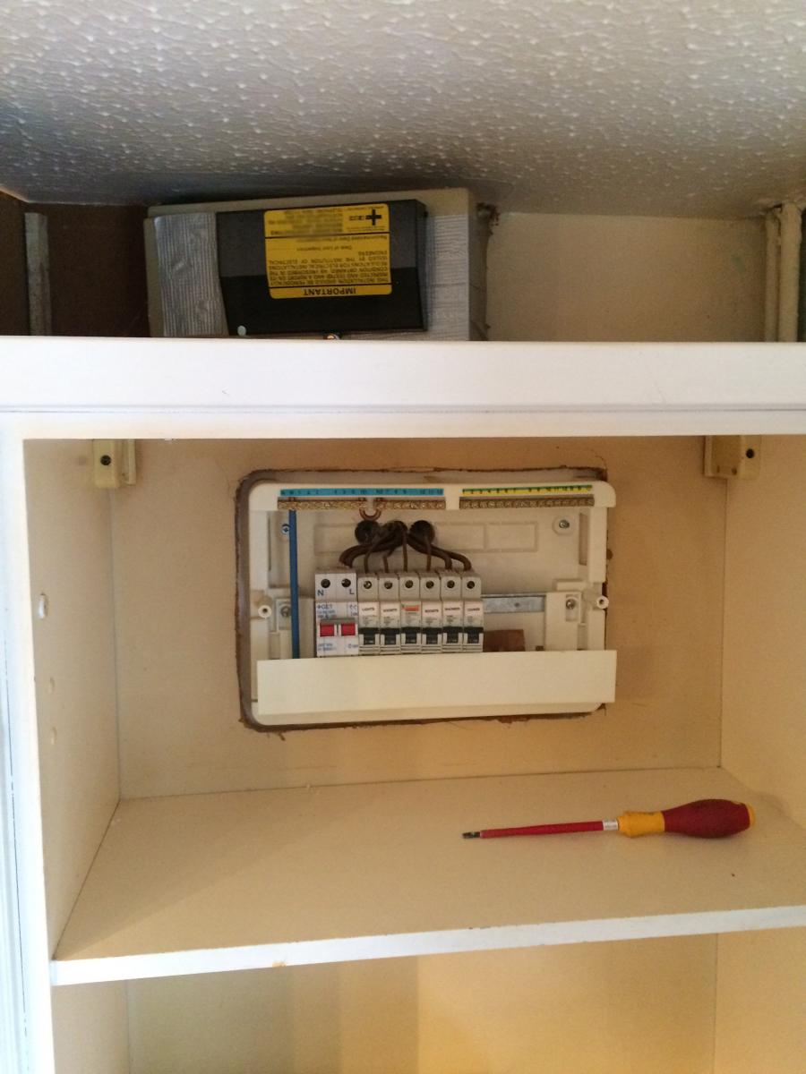

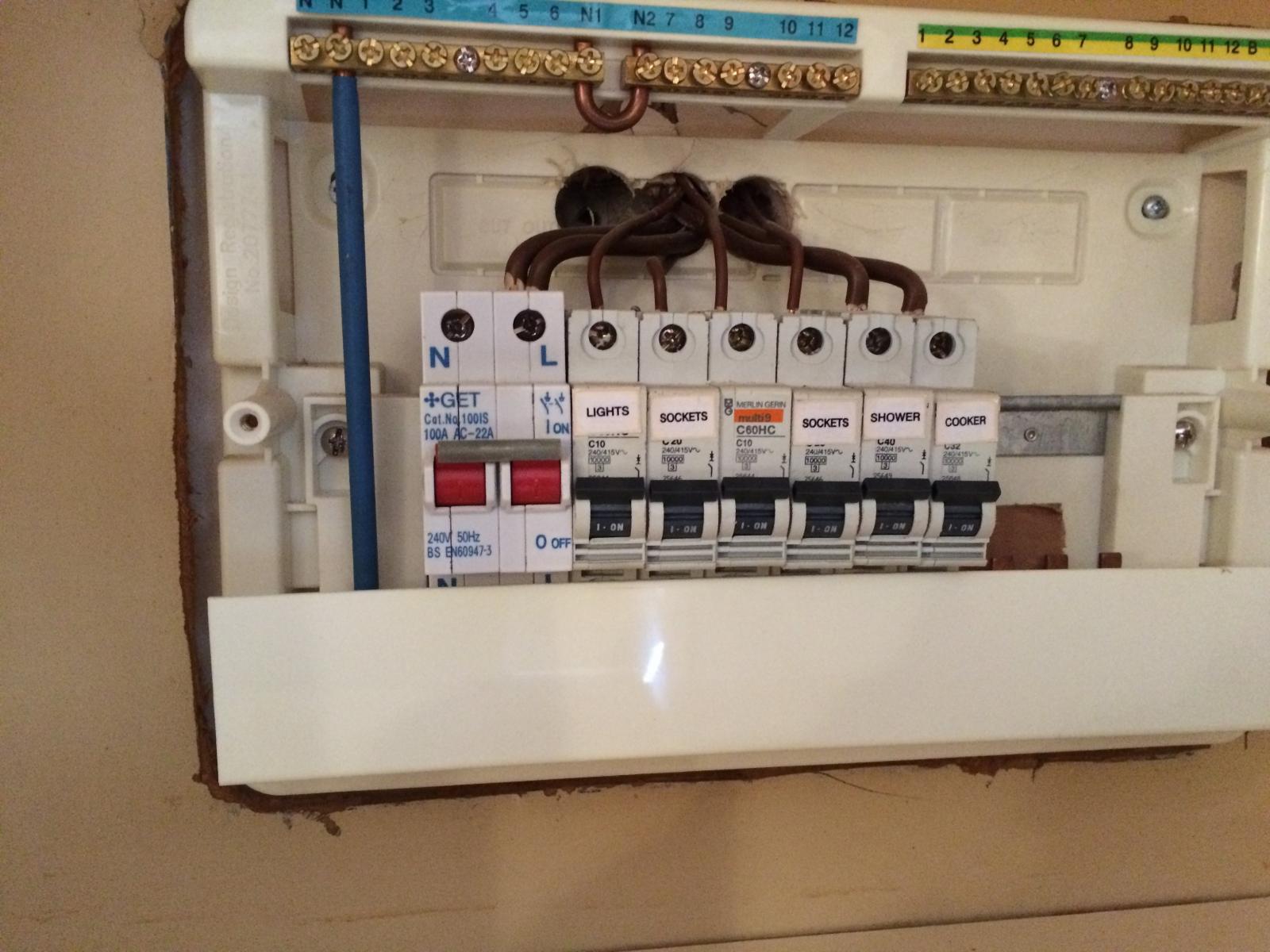

Looking at a friends house today he has just purchased.
Sorry about the middle pic, but couldn't resist this little gem of a consumers unit change utilising the old one for a connection point. No need to extend the CPC's and Neutrals then. :stuart:
i can see an adaptable din rail box going in there and the cables extending professionally, along with a shiny new steel CU with RCD protection.

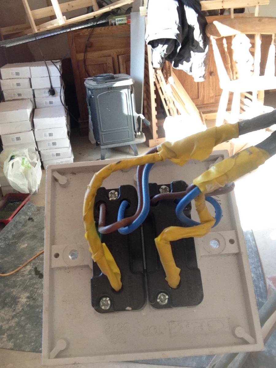

Ok some pics to follow after my further investigation.
Two way lighting circuit

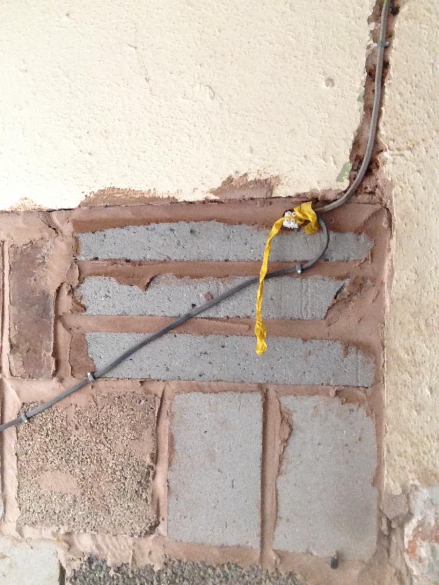

Routing of cables

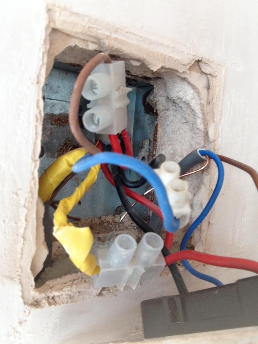

In service Junction box
In service junction box

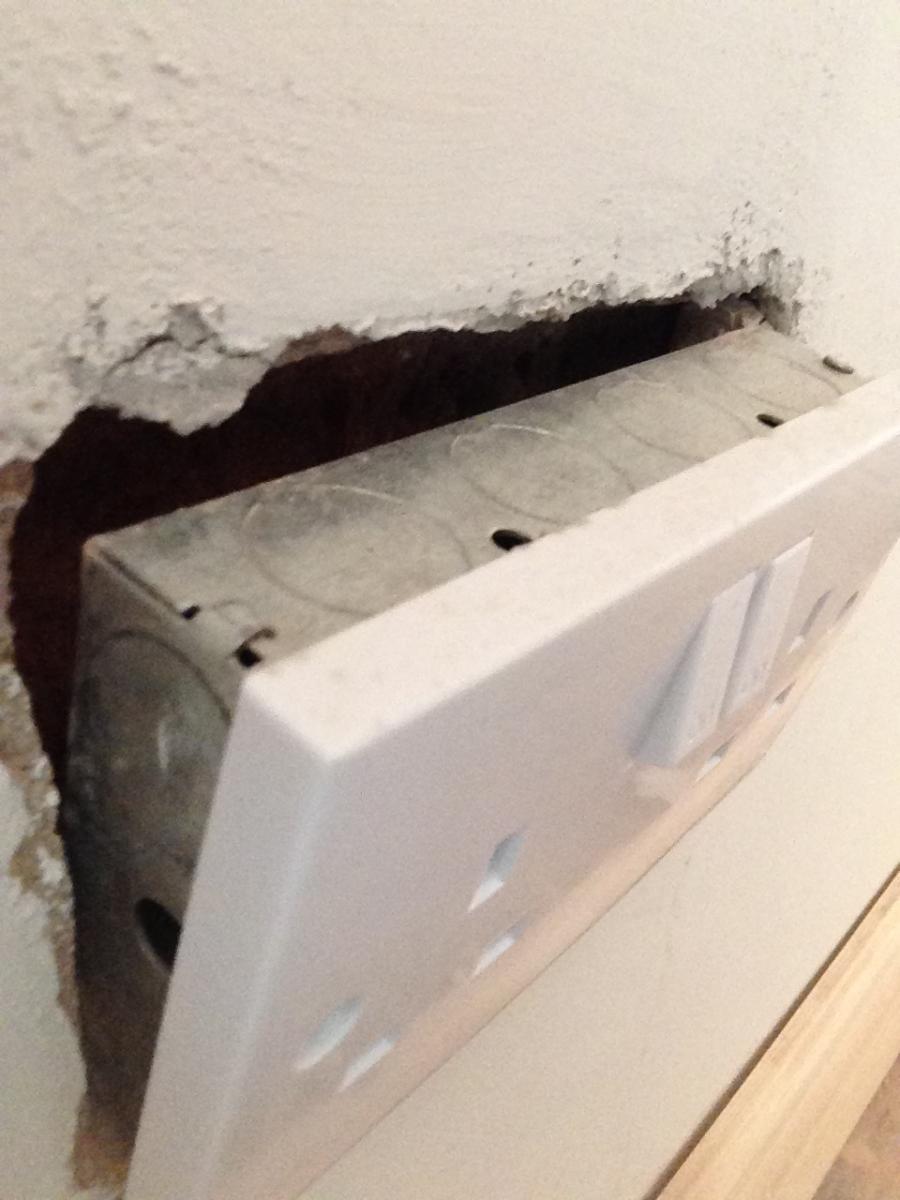

Socket fixing

All these photos were taken today prior to me doing any rip out or start over! This is the state of just some of the installation after a "full re-wire". The owner of the property wasn't just ripped off but actually put in danger!
That bathroom light fitting almost touched my head as I stood in the bath! An I ain't 7ft tall!:90:
Note the use of the cpc as the common conductor on all the two way lighting!
This guy can't be bothered with sleeving either. After inspecting and testing the socket ring circuit I found no continuity on the neutral conductor and no sleeving on any of the cpc's. The neutral problem turned out to be a loose connection and the ring actually tested ok, which surprised me considering the two ends of the ring had been connected into seperate 16A mcb's.:frown2::thinking: Turns out that the two radial circuits in the house were connected together in a 32A mcb. :wacko:
