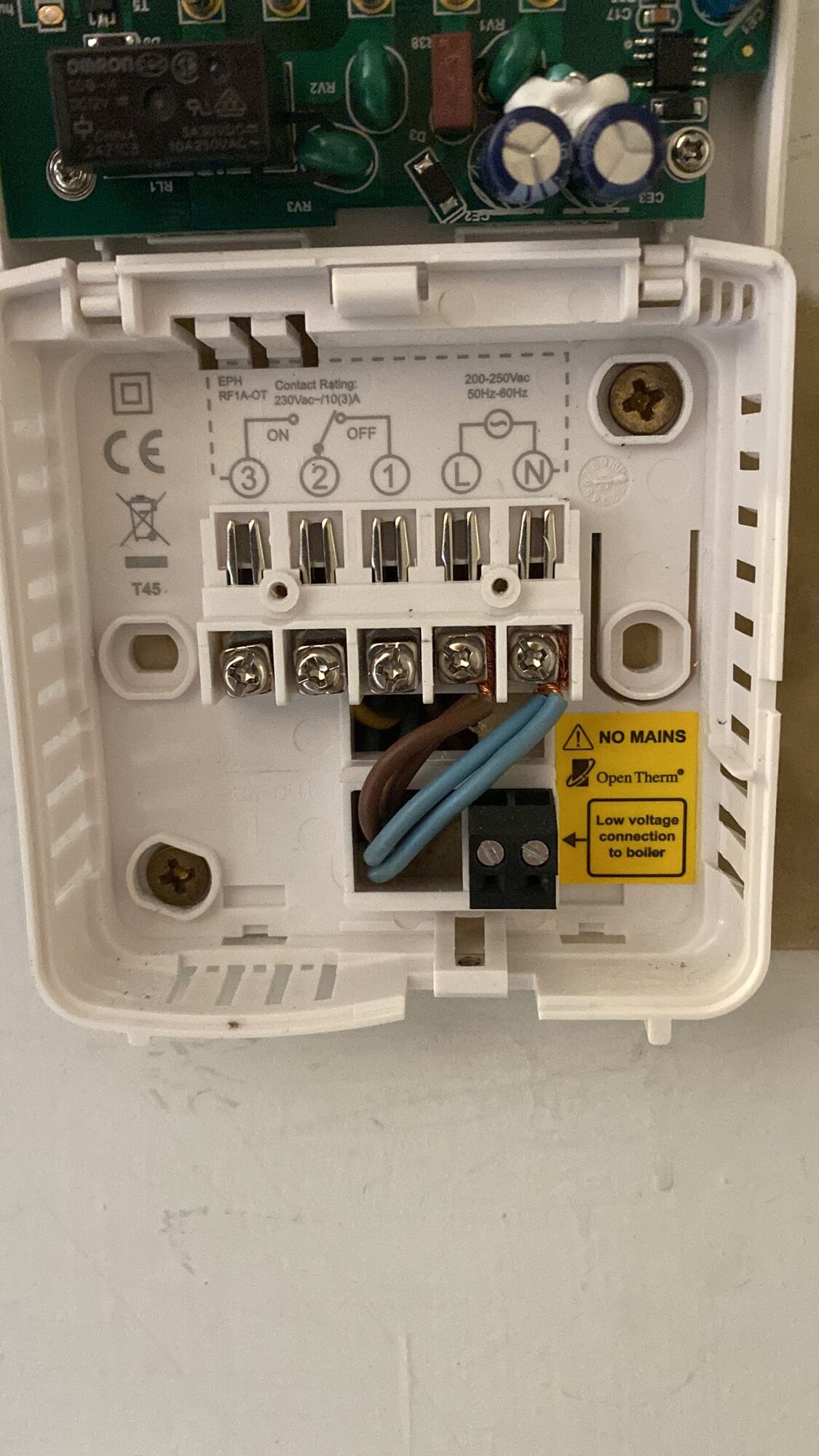

Text from a previous customer.
“Hi Carl, sorry to message you on the weekend so no rush to reply.
I thought I’d installed the wireless heating system on my apartment fine but now the boiler isn’t turning on. The wireless control unit is talking to the panel that the boilers connected to. However, the unit is then not turning the boiler on so currently no heating in the apartment.”
So I said send me a pic of what you’ve done……
After explaining that all he’s done is supply power and there should be some other wires. I asked him to take that plate off and show me what was behind it……
Now, I’m not sure here, but I think his boiler must be faulty as those conductors must be irrelevant……. 🙄🤦🏼‍♂️😂

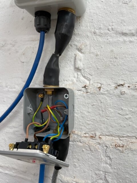

Oh, for a coupling and a couple of bushes.......and a bit of a rethink all round.
Reactions: 123

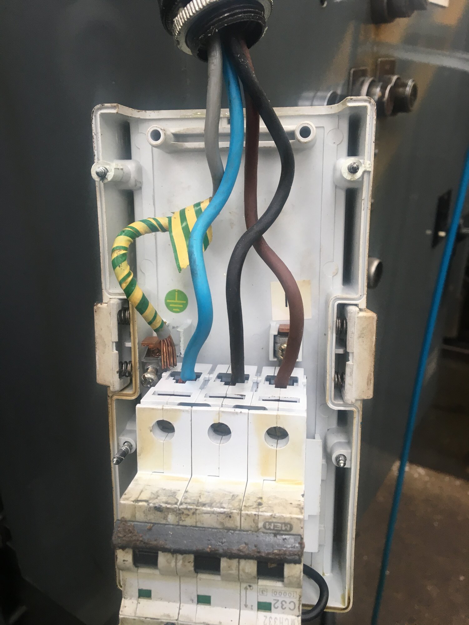

I cant figure out how they did that… unless the shrouds were cut open and put back round afterwards.
Your assuming it is properly terminated SWA looking at it closely i'm not so sure
Reactions: Fazz711
It's only SY cable and, if it's warm enough, the shrouds will bend.
A crap job done in SY and 3c blue flex. there's even SY glands fitted but no protective wire earthing.
How to finish a job off with class.....

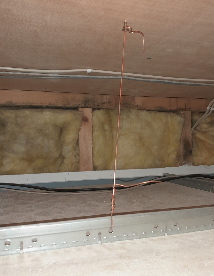

And one final one (I should have organised these into one post). The place I was working Friday had an entire office suspended ceiling held up with 1.5mm2 copper wire like this. I don't know how it hasn't collapsed.
