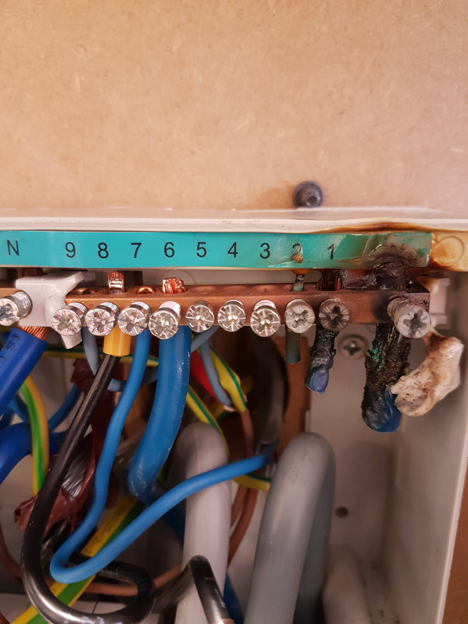

A nice Friday morning job doing a periodic.
I guess the note about checking the tightness of manufacturer assembled screws was not noted...
Client says can you replace today well yes but wasn't planning a long day so I said can't shut them down today but can put in temp fix.
You see it a lot where they don't double back the solids in terminals
Or is that just heat transfer from the larger cable
Looks like the stranded main neutral was never tight enough.
Hard to say that bar only did the fire alarm, comms socket which has little load and the air con.
