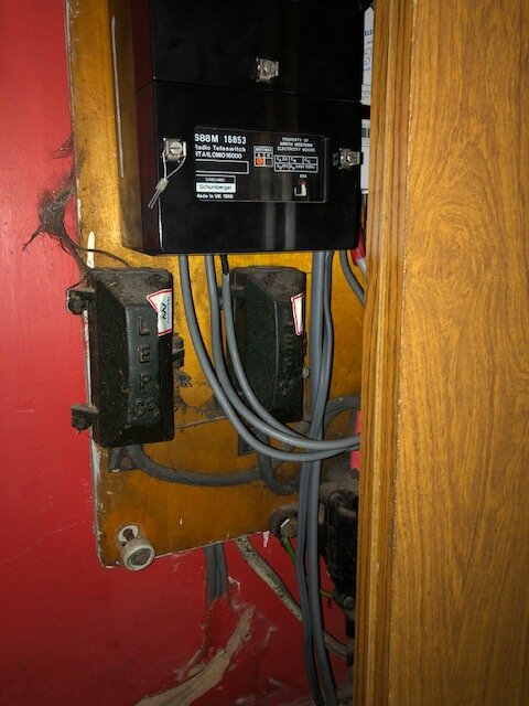

Can't say as I know enough about TT to say as we don't use it
But was wondering was that a 30ma incomer and a badly earthed TT or something
Wouldn't it be the dno that decides on the supply type and provides the neutralising terminal ?
Between the fused cutout and main switch
Behind that board, one of the new slim types?
No supply cable either.

Prob some type of apartment meter centralisation job
The cutout gets left behind and the neutralising is now left idle as ready mentioned

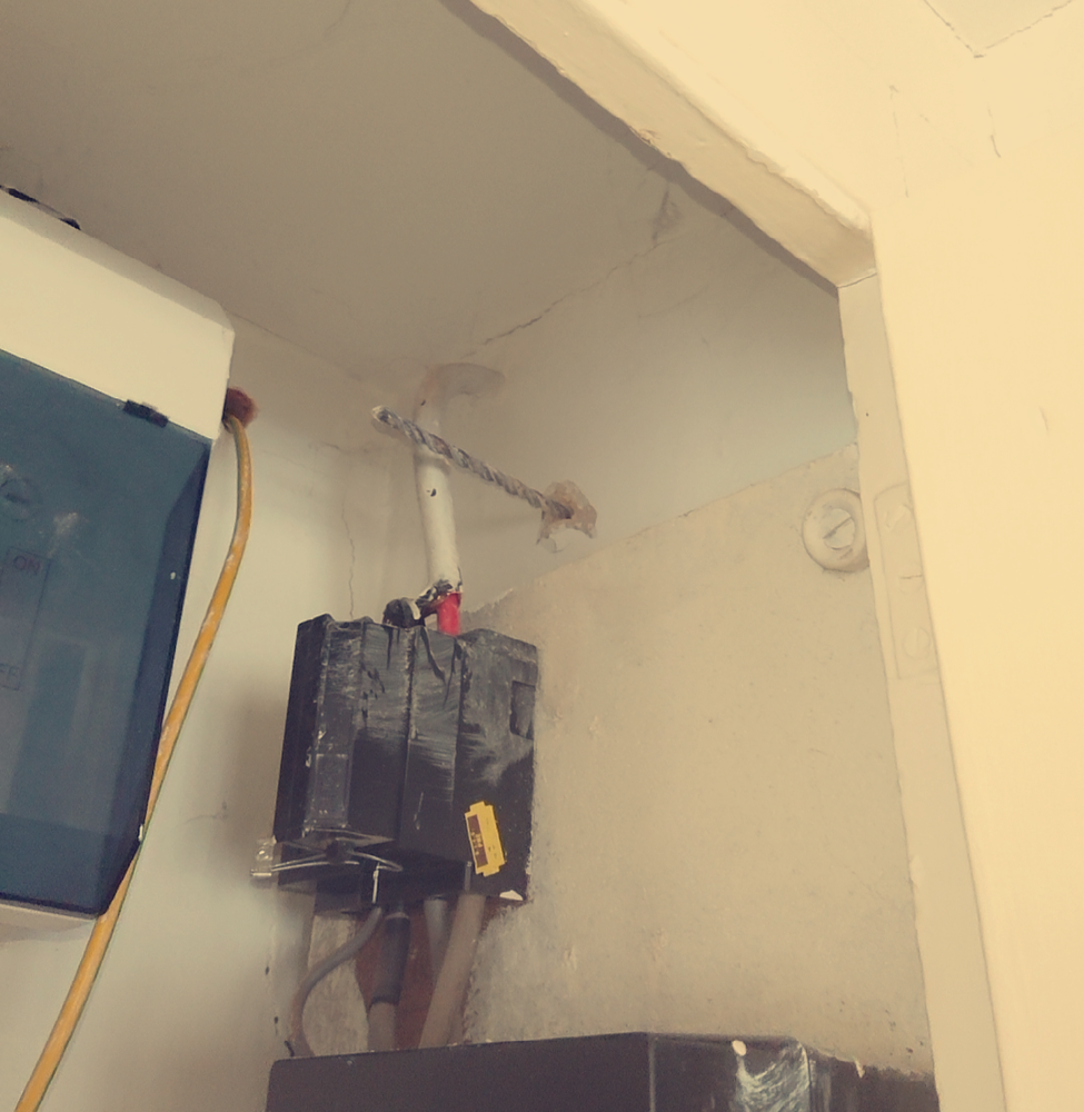

Having been on a quick fix in factory in Wakefield and on a way home for the night stopped in Maltby because the two way switch wasn't working. Nobody in, downstairs lights MCB off, so I have tested wire coming out of the switch with for continuity against the earth (AC light lit-up), but not enough to Display value and I got a hardly noticeable kick(touch) from the radiator. Apology for the stickers, but as I have went only for a switch I haven't brought the testing (locking )kit or proper condemn stickers.
Strait for the main-switch off and what I have seen when I have looked at fusebox properly:
-There is a case when access for the finger to live bush-bar is not the worse problem by far
-there is a case when 6mm meter tails are not the worse problem even if they are supplying the electric shower on 10mm cable and are connected on 100Amp incomer fuse.
-there is a case when neutral being shared between both lighting circuit is nowhere near the worse problem here. lets see if you spot the largest issue here. (description have hinted it)

As I have said, I came very badly prepared, only expecting a badly fitted two way switch.
As I have had quite few of mine locks broken this week (when locking MCBs) These stickers where in hope to scare person not to switch/reconnect it back on(I had re-routed mains cable not to connect to the bottom of the DB main switch too.).
As an update Stickers and disconnection vere not enogh as I have had a phonecall from the plasterer today asking me in Pinglish why did I not fix the kitchen light which after he switched both mains switches back on and reconnected busbar and brown cable back to the bottom of the main switch (like he used to do when being electrician in Pakistan) now declines to ever switch off...
I admit I did not work on TT system in a UK yet (except for SELV) but based on a type of wire this to me looks like TNCS That was newer finished
Had it been TT it should have had an earth rod!
