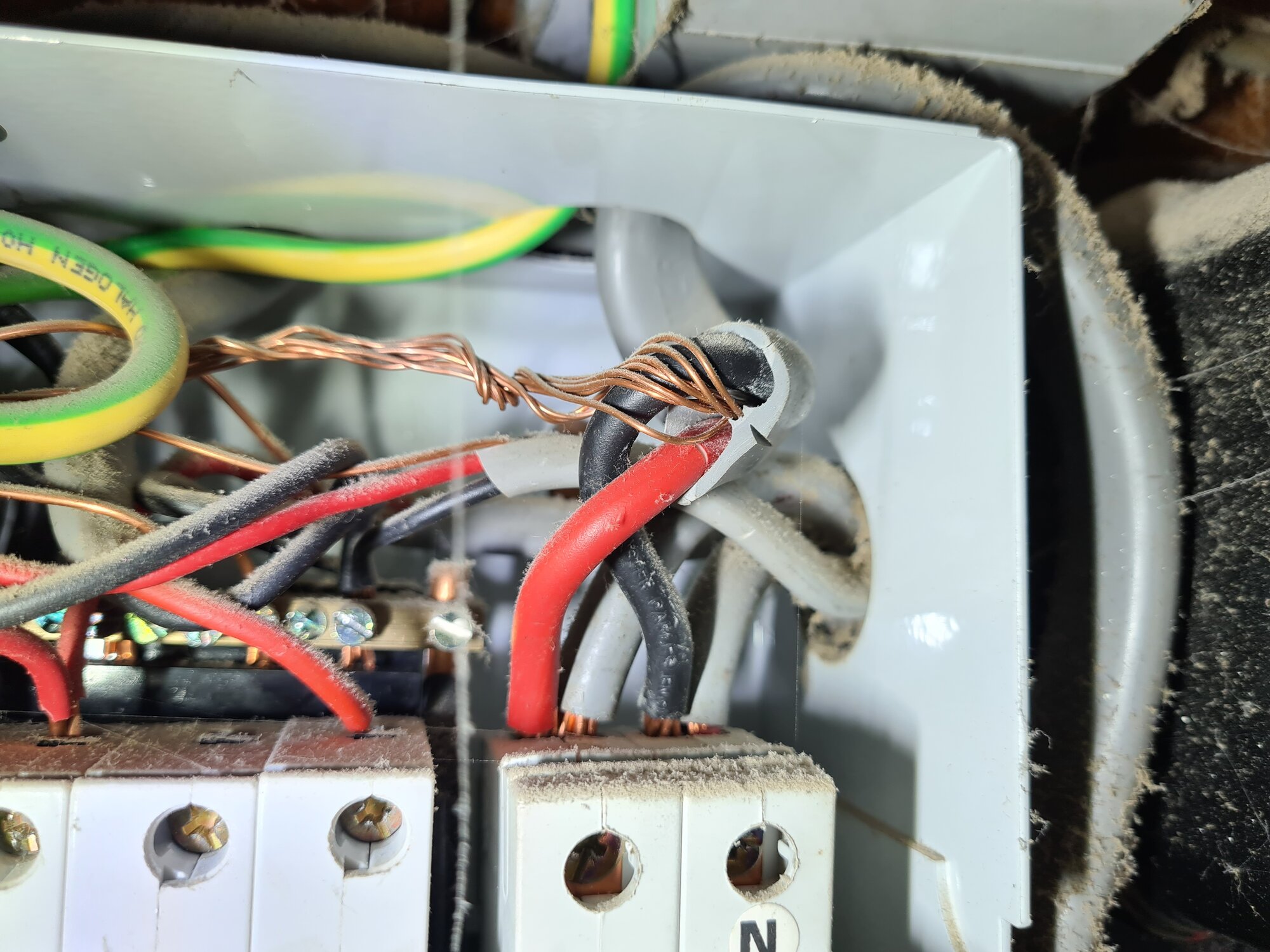

I know there is a load of options to shake one's head in disbelief at, but I am obsessed by the green cpc in the last photo, I am not sure if it's been chewed, overheated, or just had a difficult childhood!
I think it's just been wrapped with tape.

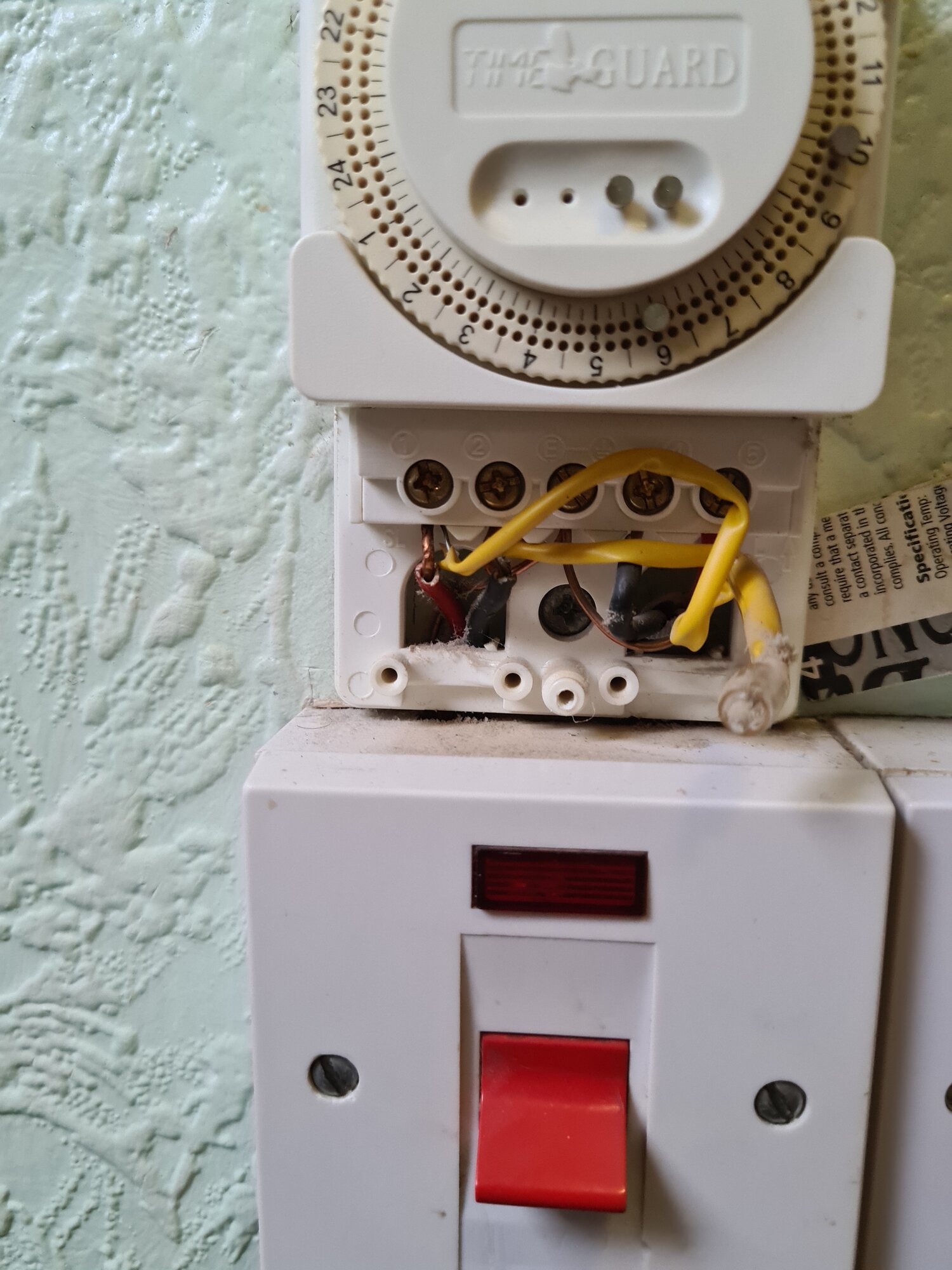

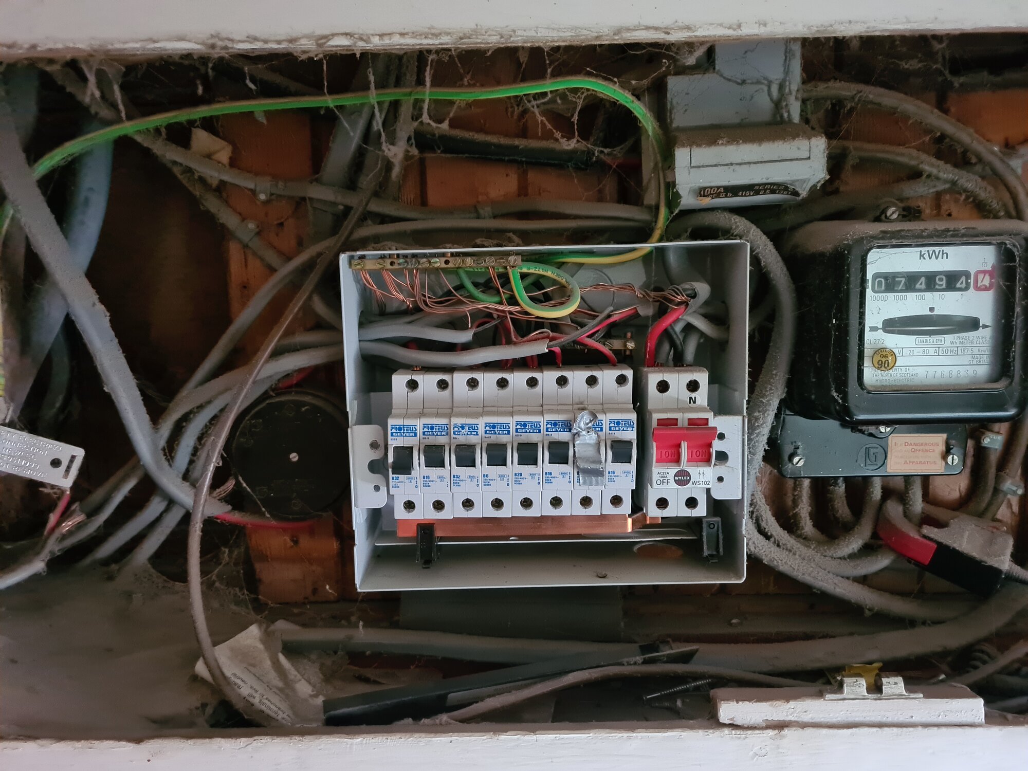

Needless to say, the list of things right in that house would be shorter than that of what's wrong. Got to 30 observations then gave up filling in the cert to be honest. Socket outlets in the bathrooms, very little to no earth sleeving used, bad connections at most accessories inspected, jointboxes everywhere, CPCs used as strappers, no earth continuity on half a dozen circuits including socket circuits, outside jointbox which comprised a pattress & blank plate. Plus a bonus "hybrid" circuit which left the board as a 10mm T&E, was immediately joined to 16mm T&E beside the board (see 1st pic). Never did find the joint at the other end but that circuit ended up supplying most of the kitchen sockets, the boiler, oven & hob. (I was assured by the tenant it was a joint and not another consumer unit, he couldn't remember what part of the wall it was hidden in though!)
Bit of a weird setup with long-term tenant who's done alot of work to the property themselves over the years as a return favour for a very low rental rate and a landlord who recently inherited the house. Report is definitely not going to go down well.

I recently had one very similar.
A pre work survey for a board change turned into a quote for a rewire in about an hour.
Also had multiple unused live cables taped up and left floating about behind plasterboard and or in ceiling space..
Fortunately the customer was really keen to get the rewire done once made aware.
