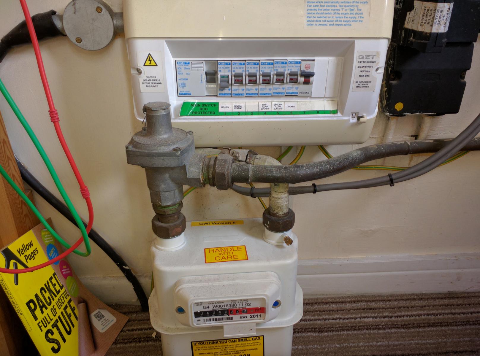

Amongst numerous other issues in the piccy, the one that hindered me was I couldn't get CUs cover off. I think the gas meter must have been changed to have the raised up part on the left hand side at some point. Idiots!
Reactions: 1 person
That raised up part at the left is the regulator, which reduces the pressure from the incoming service pipe to that required for the installation, and maintains the pressure.
I think, but am not certain, that that is quite an old type which requires mandatory notification to the gas board for replacement whenever a gas safe plumbob encounters one.
Reactions: NDG Elecs
just get the gas supplier to shift the stupid gas meter at their expense. ​whoever fitted it there is an arse.

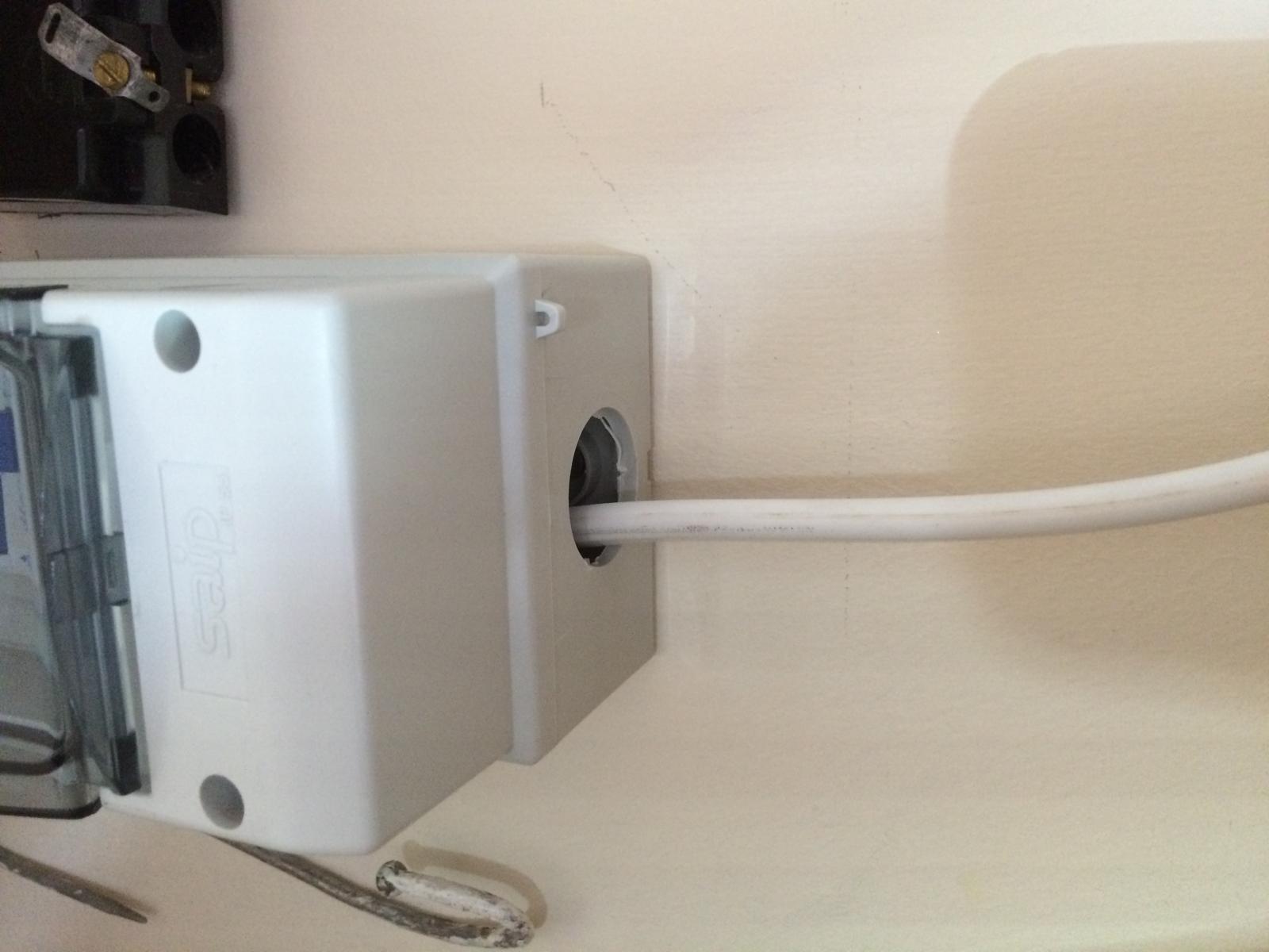

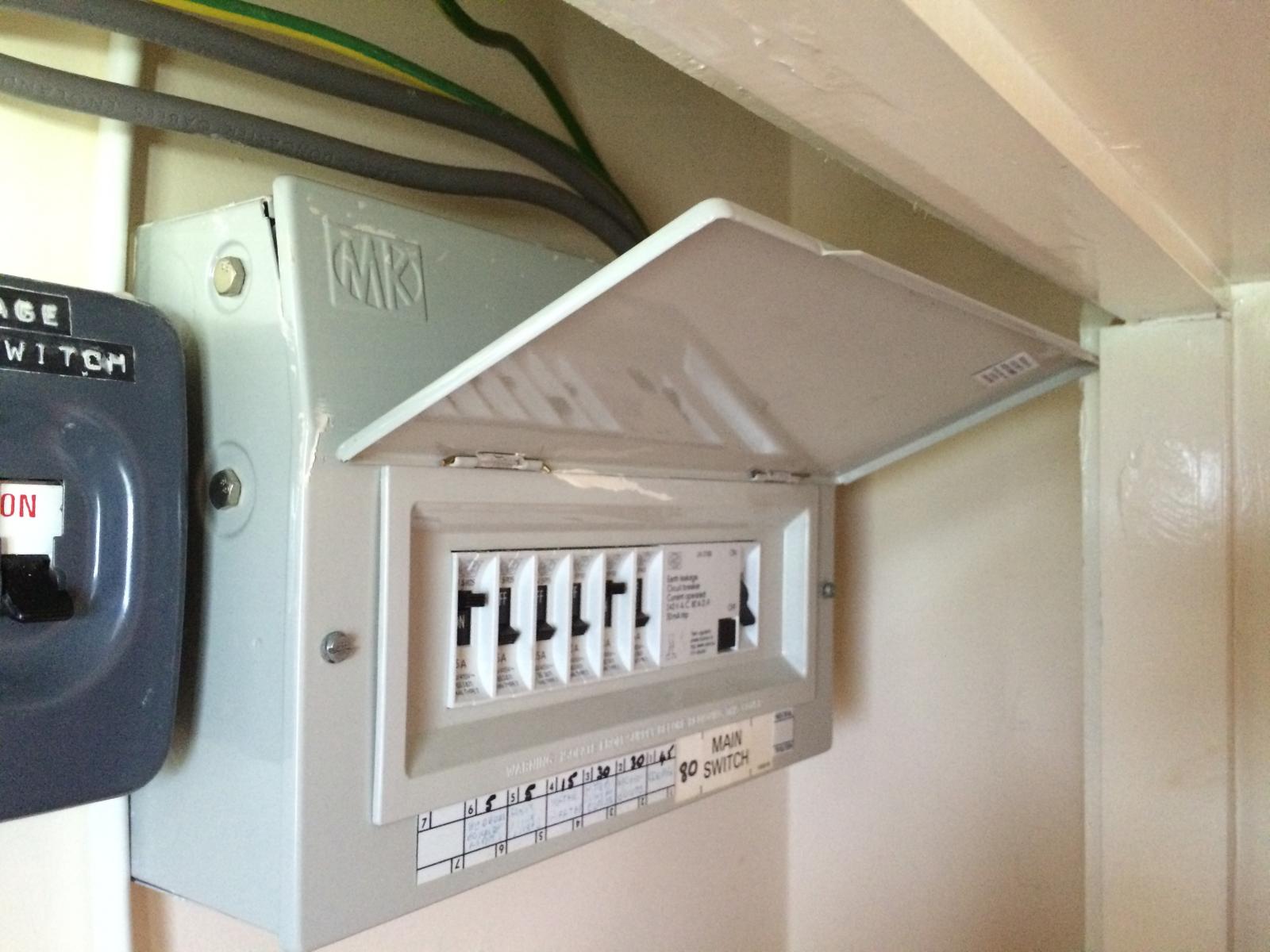

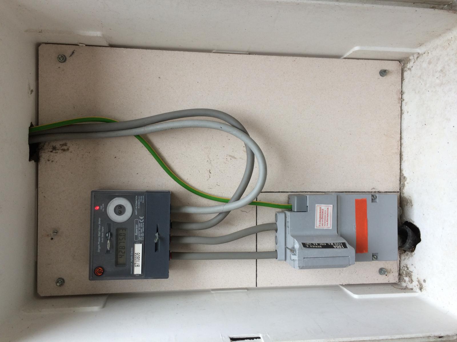

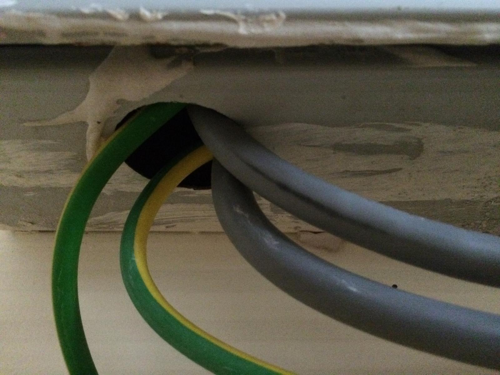

Not as good as TheGayOwl's but I had this the other day. The cu cover wont close as the door casing impinges on it. The space is to small to get a normal screwdriver in to remove the far side retaining screw and the cover doesn't sit flush in any event (see the top).
Top of the board!
Henley's to the side of the CU. The exposed conductor is the Live.
The shower unit the Henley split feeds.
The meter tails were approx 8m from the DNO cut-out and unprotected.
