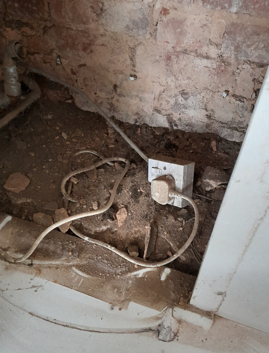

Henley block?
They could have used a cooker outlet as a joint. 🤣
I think they misunderstood.

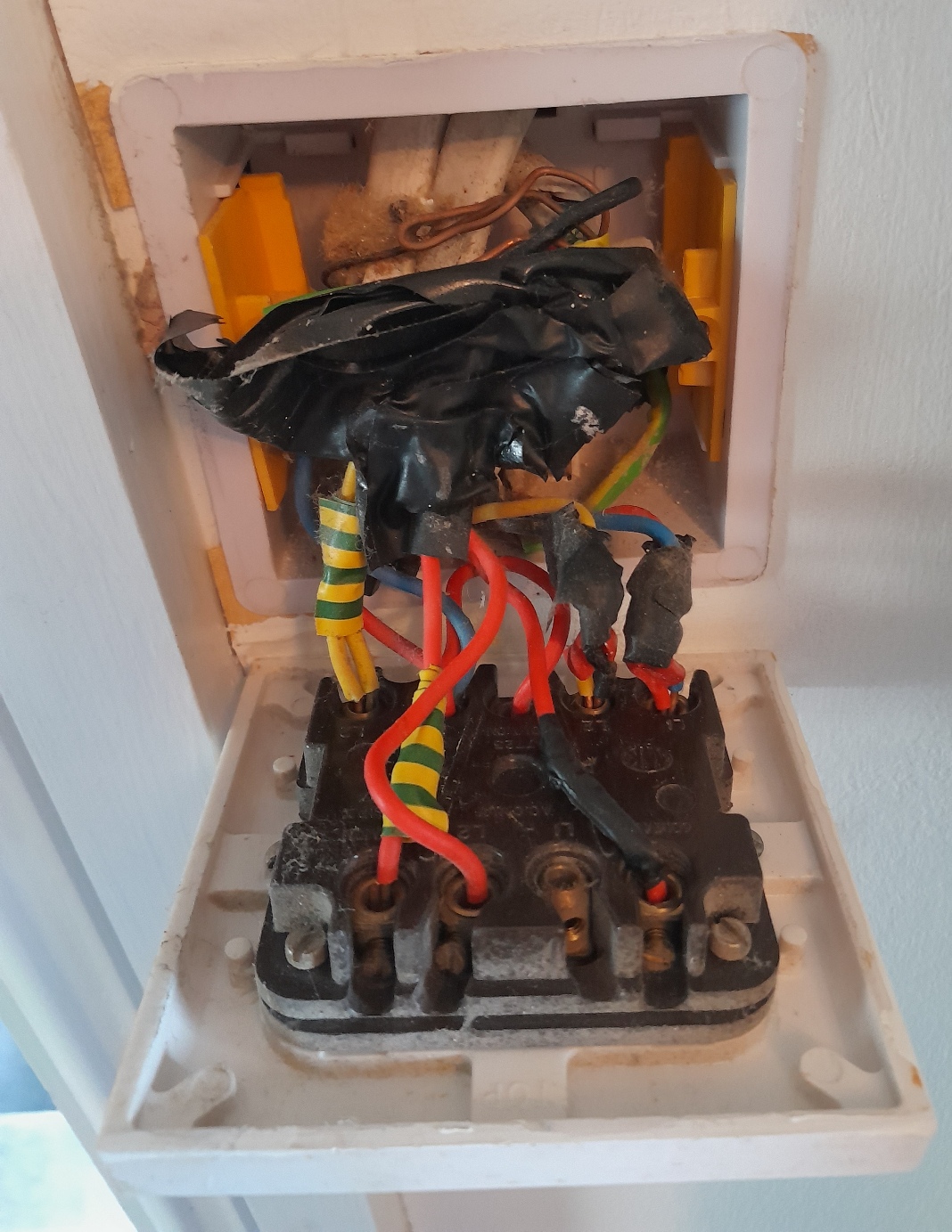

Lights not working. Generally poor installation. Flexible conduit runs up pole to light and the end is open allowing rain in to the box, among other problems.
Lighting poles fixed with a load of plastic ties.
And cables buried a few inches under the surface, run in water pipe across the entrance of a lorry yard.

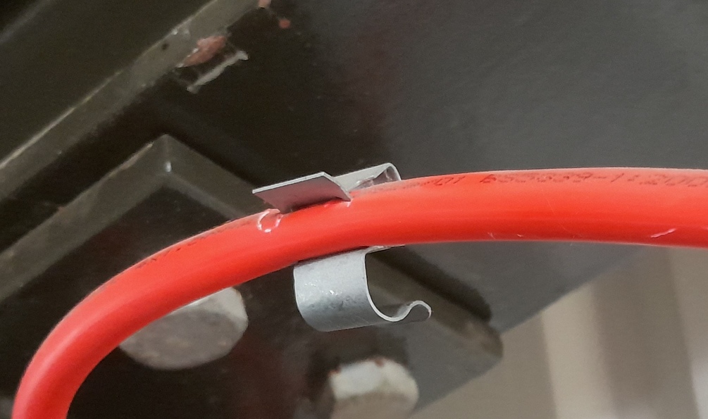

It was one of the few fire alarm cables that was fixed! Most were just thrown about above the suspended ceilings. Don't worry, they are all fixed properly now, and that cable shown has been replaced.

Maybe they got the wrong size and used a bit of imagination as a result. 🙄
