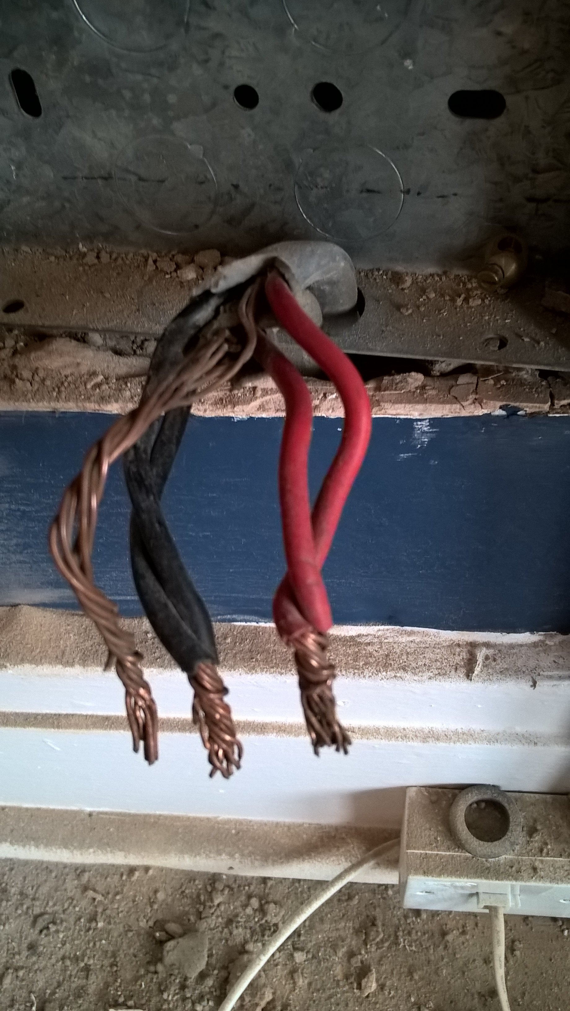

However, you can see I have looked out a grommet to cure the lack of one. The double socket this was connected to was held on by the usual two 3.5.. screws , one short one and one very long one, the latter to drag the squinty-fixed back box from the depths of the wall...and of course there was no earth to the front plate.
Can someone advise me on the likely age of this wiring with its multiple earth wires, 3 per cable? Or is it my eyesight...
1960's at a guess. They were onto solid core 2.5 by the 70's

Thanks, littlespark, I'll note that...1960's...so, not as old as I am!

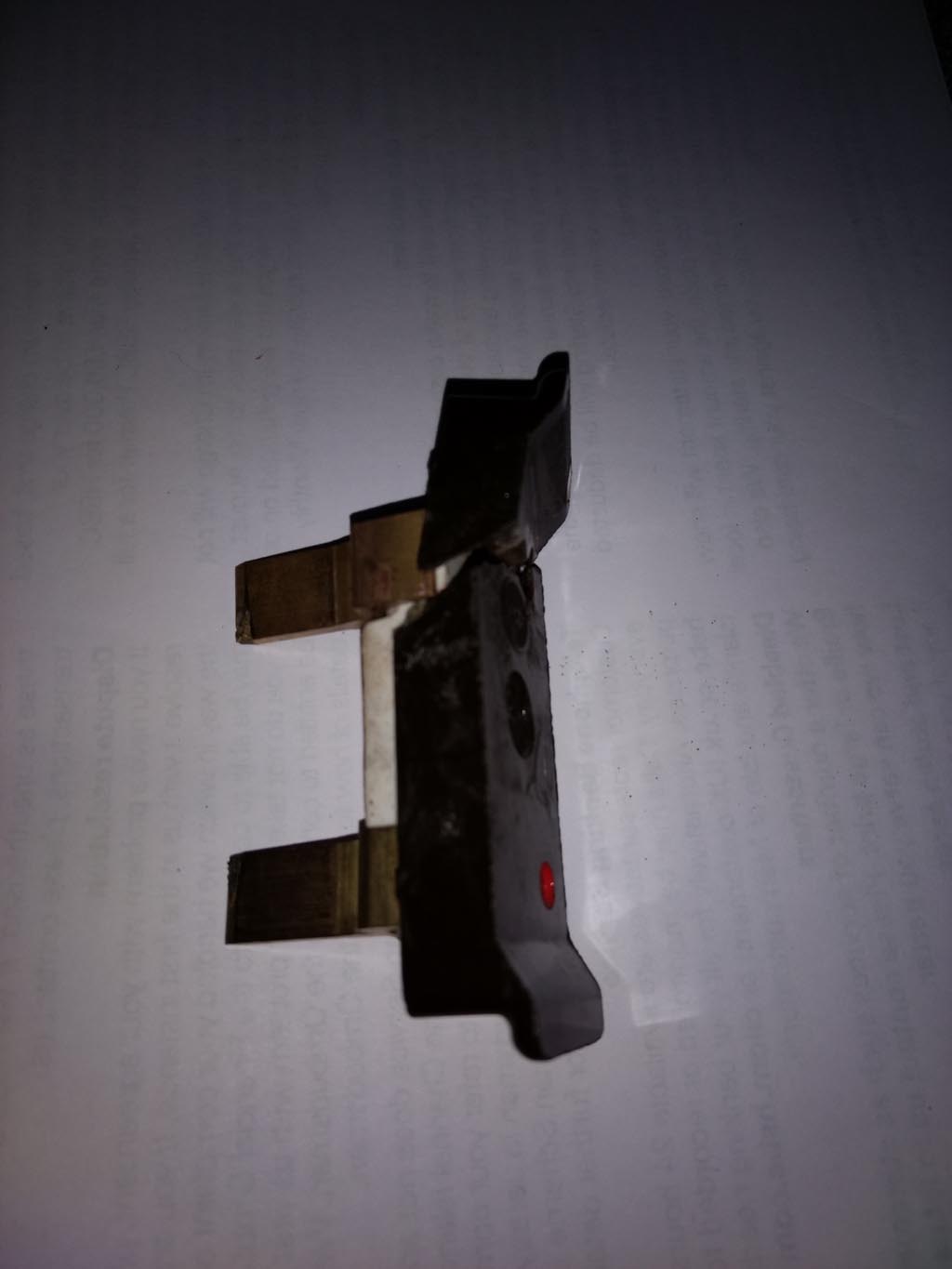

Here's a nice reminder of why you should always try and isolate fuses before pulling them :)
Thankfully I noticed the second red dot was missing and the screw was loose.
Oh... and it's also a timely reminder about why you should keep a few bits of junk you remove from old installations. Replaced this and a 15A carrier serving a 30A circuit with some spares from an old board I'd removed from a customer property :D

It started as a call out for an existing customer because they lost power to the cooker. I think what happened was a bad neutral connection in the cooker switch resulted in surges or something that had slowly cooked the fuse wire causing it to fail. Quick re-termination of that and change the fuse carriers and the job has yielded contact details for another family member with an electrical fault, a request for a quote to replace that old fuse box which carries with it the need to do something about other parts of the installation (like replace an elderly VOELCB) and the possibility of another checking out the British Legion in Newport. All in all quite a productive call out :)
