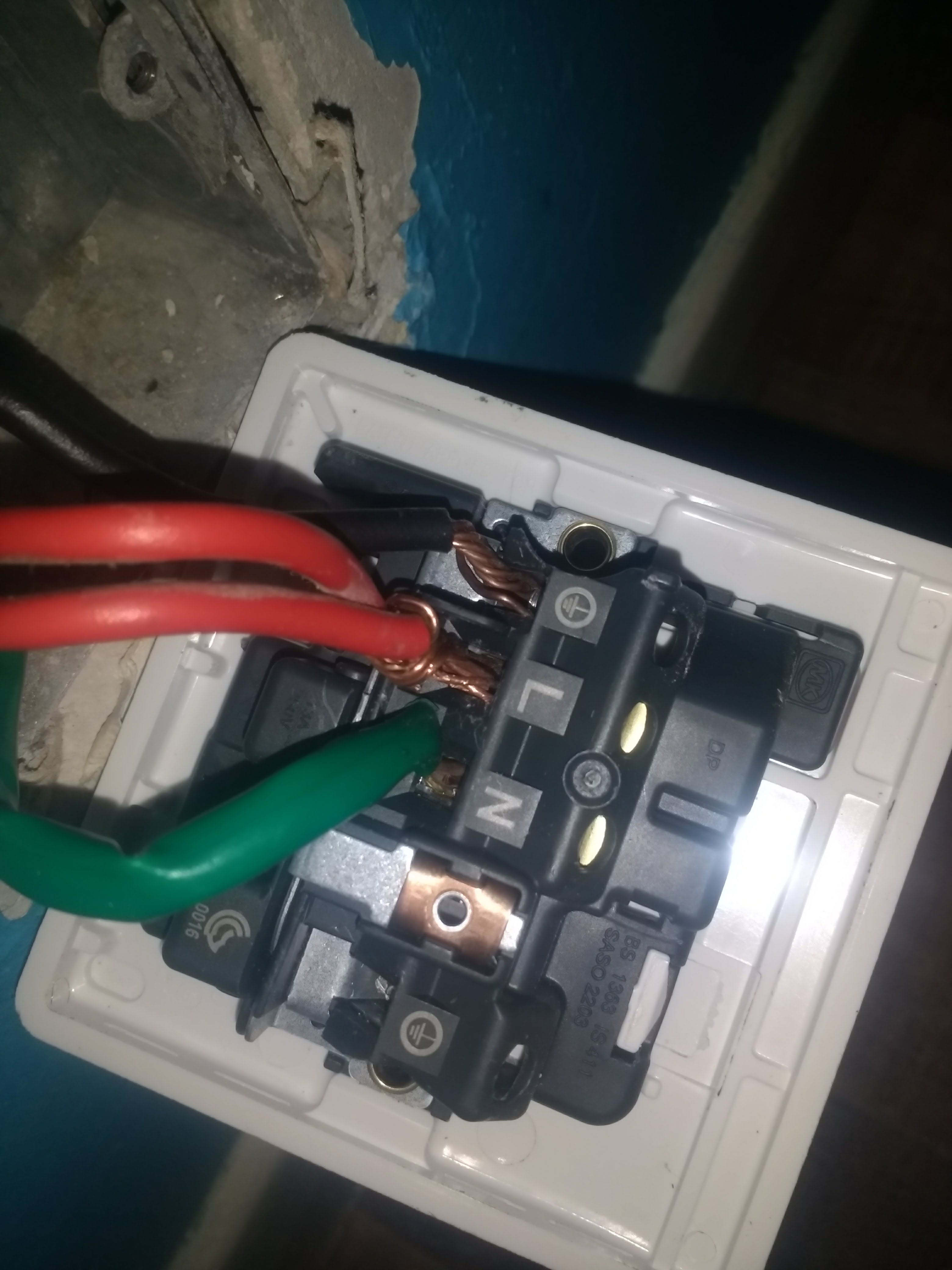

Anyway, yesterday something tripped the RCD, apropos of f**k all, as we say in Glasgow...
long story short, assuming it was the kettle, notorious here in Spain, but having no luck with that, unplugged everything else in turn. Turned out to be the microwave oven, which, when plugged in, but not switched on, tripped the RCD sometimes almost immediately, sometimes after a few minutes...oddly even when switched off, if I opened the door the turntable was turning...
Binned the microwave, connected the other stuff, all was well. Plugged the microwave into a separate circuit, and it tripped the RCD again, so really binned it for good, and bought a new one. Unfortunately, in finally pulling out the mains plug, the socket fell out of the wall...
The sockets are very flimsy, and screw into a very flimsy plastic back-box which is secured in the wall by being coated with plaster, squished in, the excess plaster wiped out, and left to dry.
The grey plastic box had just cracked round the screws.
The new box is very flexible and the knockouts virtually shatter when you squeeze them with your thumb...quick visit to A&E to get the plastic shards out of my eye...and back to work.
The other components are equally rubbish.
You can see that the two earth springy things slide through the top and bottom holes of the plastic socket-front
Reactions: DPG
A wee single screw holds everything together. I fitted the new box without plaster. The terminals are odd...each cable has two, so you loop in and out (no space for squeezing an extra in!) and when you tighten the screw, it clamps both wires at the same time, a square washer thingy clamping the bare ends...I quite like that, actually.
Finally, you assemble the components, click them into a metal frame that screws onto the back box, and snap on the outer cover.
The combined socket and switch on the left are much older and far better made. The rocker switch is for under-cupboard lighting, not for the socket...and, oddly, it isn't just tee'd off the back of the socket, but is actually wired into the separate lighting circuit...bet they don't bother nowadays.
Just to complete the picture, this circuit was wired as you see in blue, brown and green/yellow singles in conduit. The other socket circuit is wired in singles too, black, blue and yellow, where black is live, obviously...and all the sockets have the live on the left pin...not that it matters as you can put the plugs in upside down if you want.
