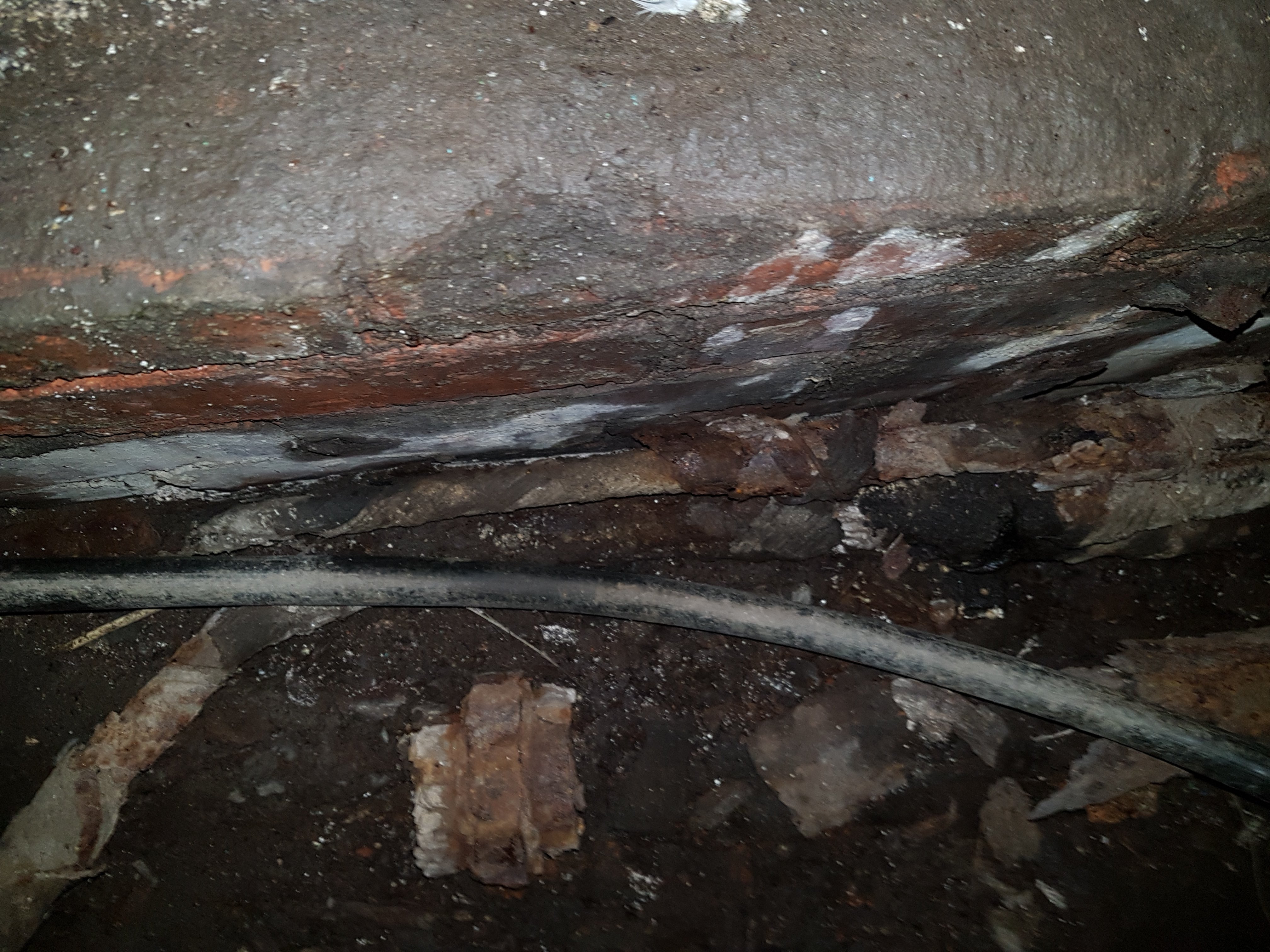

I have just started a 650-700 circuit periodic and there will be one Report with the Coded part sectioned to different areas of the site and the schedules in order with the Coded parts. These pics show a busbar which is apparently redundant, not and it is highly likely those deterioated cables in the second pic are live:eek:

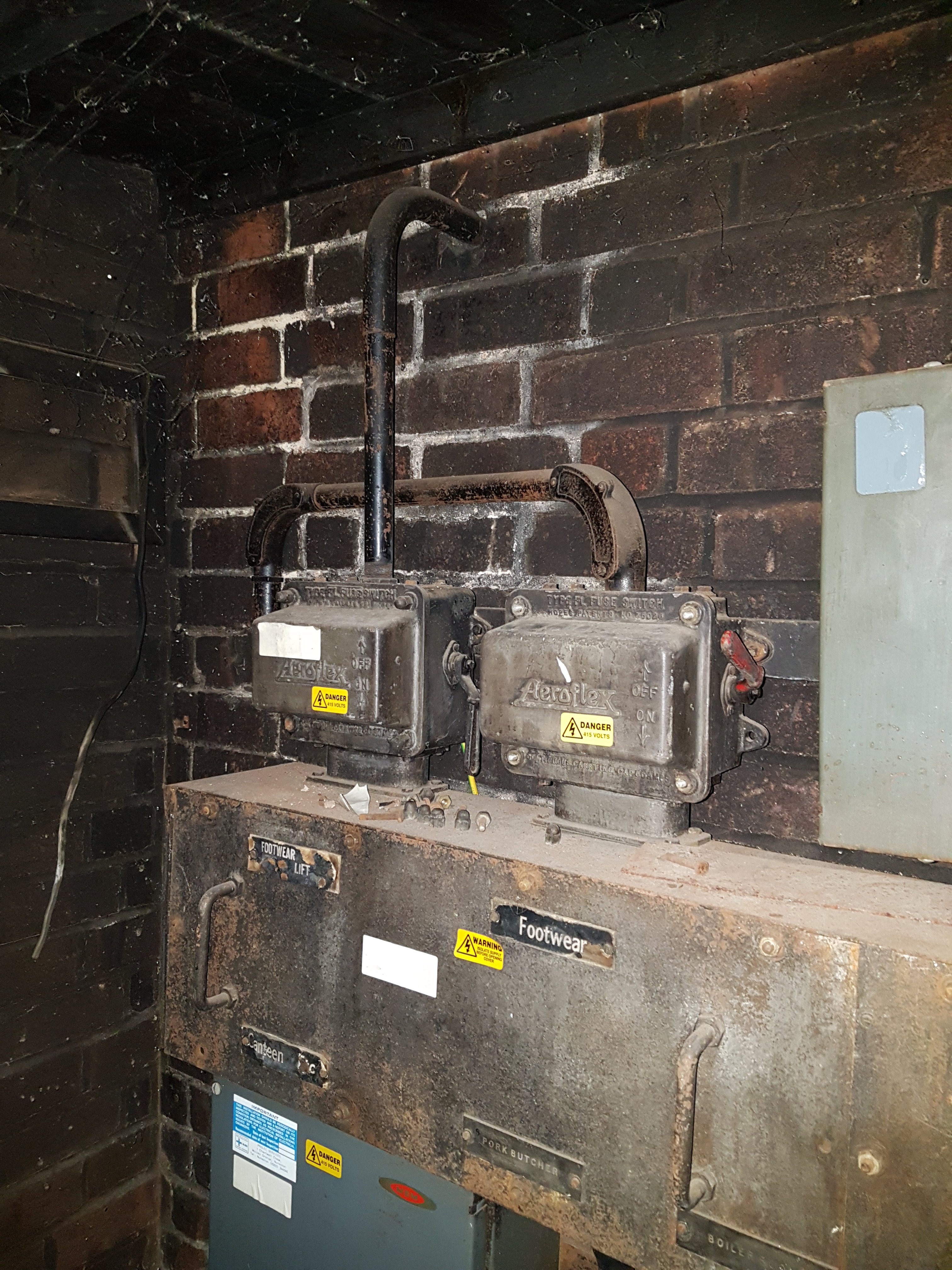

This is other end and inside one of the switch-fuses which I would date to mid 1950s and they still operate as smooth as you like.View attachment 40176 View attachment 40180
Are you able to say publicly what the building is used for? I'm just curious as the labels make me think shop or abattoir (footwear I can make work in my tiny mind for an abattoir but I'm not sure about footwear lift :) ). I guess I'm curious as to how it could get into that state and what the place is used for may help with some ideas.
Leeds
