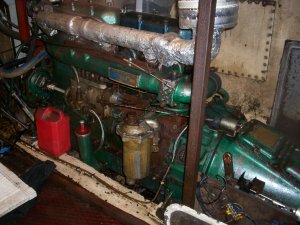

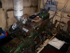

Ok, bit more info.
Won't be connected to a shore hook up, but will have the capability to be.
Boat is a steel hull
Will be powered via solar panels charging 12V batteries.
12V and/or 230V (via inverter) will be used for lighting and power with a 24V system for the engine room solely for the engine start operation.
