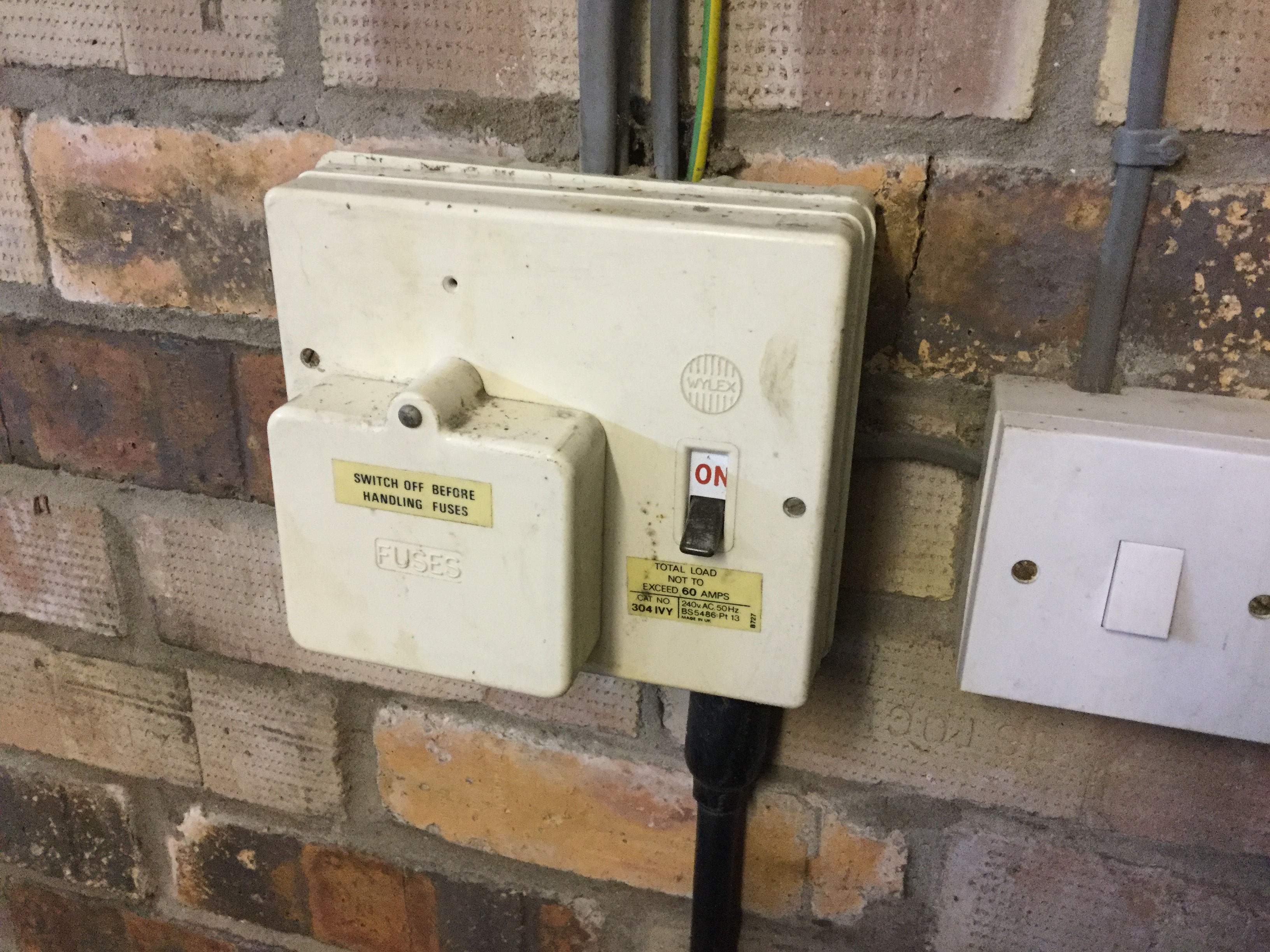

My garage is separated from my house by about 50 metres and the picture below is what electric I currently have wired in which would have been done approx 25 years ago:

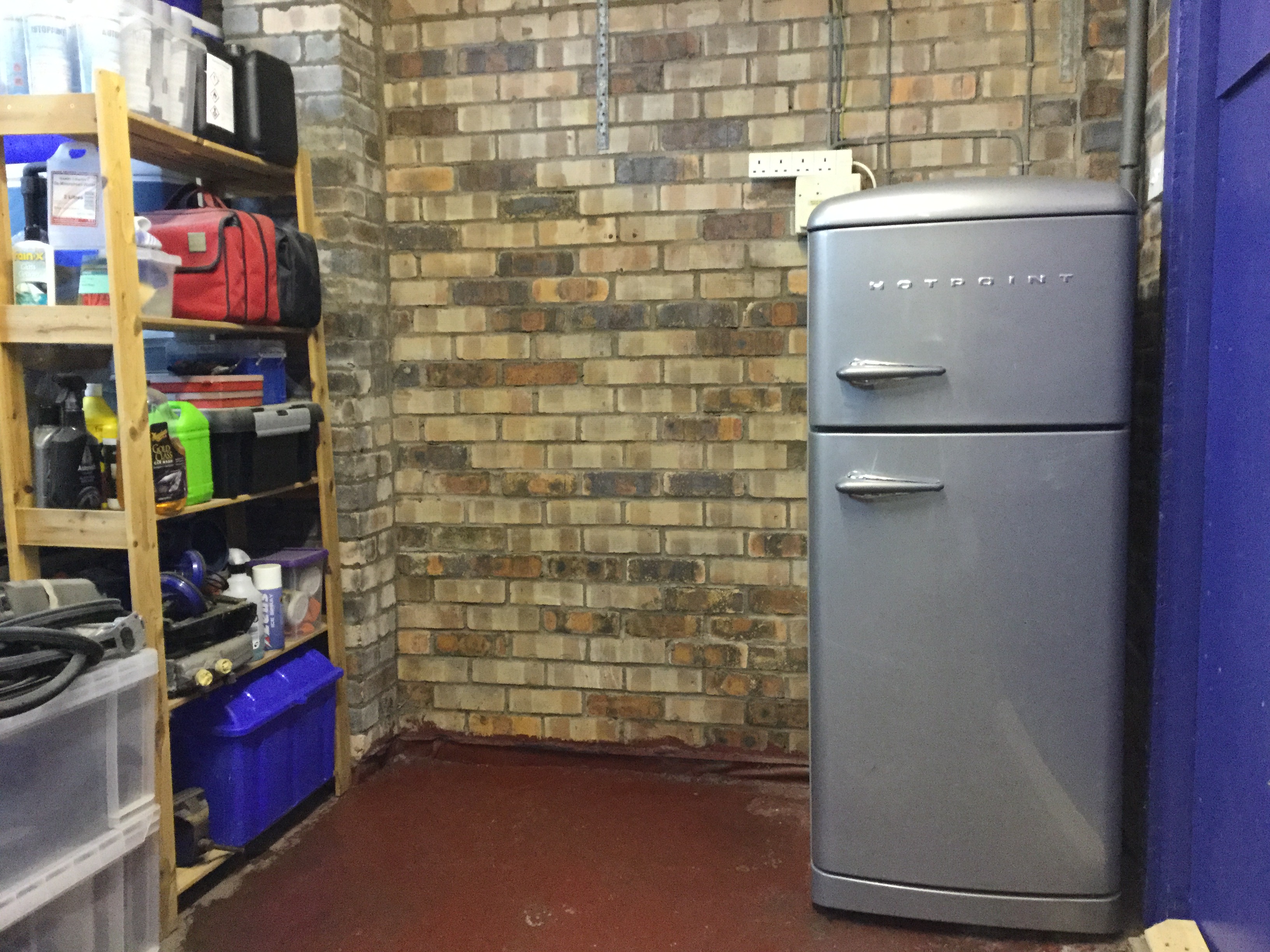

Here is a pic of where I’d like the compressor to live (note the location to where my power comes into the garage so I hope only short wiring will be required):
Firstly I’d really appreciate if somebody could clarify exactly what I need doing to make this work for me (what questions to ask and parts I need to buy).

Hi Mark and welcome to the Forum. There will likely be two approaches, the minimum change and the engineered one. Minimum change is perhaps a small upgrade to secure the wiring doesn't fail and the engineered one covers Marconi's points about voltage drop on startup as well. With a 50m run the existing SWA supply cable will need a close look at.
yep volt drop is critical with 1 phase motors. will cause premature failure of motor. in fact, looking at a Clarke 2hp compressor instructions ( yes we do read them occasionally) it advises not to use on an extension lead as the volt drop could permanently damage the motor.
As mentioned above, the most critical thing is going to be the size of that submain cable feeding the garage, more on account of voltage drop than current rating. Whilst it will probably support the running current of the compressor, the voltage drop during starting may be out of spec. An on-site inspection and test can determine whether the resistance is acceptable for the purpose.

Before making any moves, investigate the cable. If it turns out to be inadequate for reliably starting this single-phase motor, you will have to look at the economics of trading the compressor for a unit with a 3-phase motor that can be inverter driven, or upgrading the cable.
It might be completely fine - it's hard to tell from the pic as we don't know its configuration.
