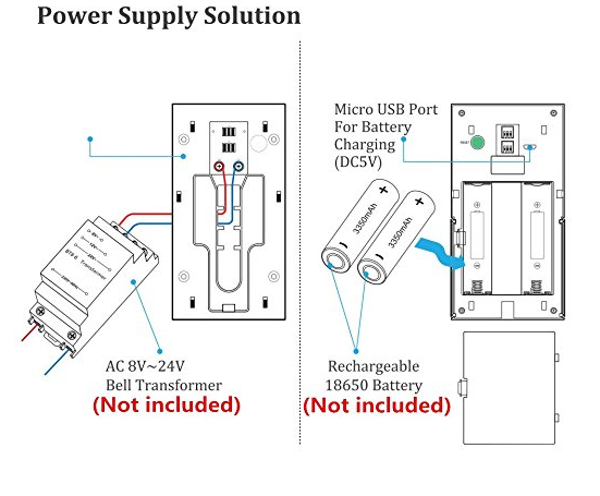

Hi, thanks for replying. Yes it does but as I explained above it is for use in CU. I have no space in my CU for it, hence I am going to use a plug in transformer 24v AC 1.5 AMP, its just trying to find if anyone knows where I can buy in the UK and if anyone has used a plug in transformer to power their ring pro.

I can use one the same as a Dantech DA652, but I am finding it very difficult to source one. I was hoping that maybe someone in the forum may know of one similar that I could buy and where from in the UK. The DA652 is 24V AC 1.5A

Many thanks Spoon, I'm sorry I didnt fully contemplate your post 25 as I had trouble with the links at first. Firstly, do you have a link to the review? I can't find an Amazon review for the same bell and any way I got it a lot cheaper than the Ebay one and it keeps connected to my wifi outside the door were a more expensive Proxima doorbell I tried and returned about 6 weeks ago kept disconnecting.
In regards to my coment about not having fusebox experience, this was because the Amazon picture has the transformer fixed into a fusebox. However, I now think the transformer can be wired to a spur from a mains socket. The transformer is to be fixed to a lath and plaster wall, so I need to consider if fixing directly to this wall is OK and can I make a wooden enclosure or what enclosures maybe suitable. Would be greatful for suggestions and again, thanks.
I wired it all to a fused plug to test it before installation. The bell doesnt power on though power is going with as it checked with a tester.
So you have the bell now. What does the manual say about the power.
The link you supplied for the bell just shows batteries.
You said the bell required 8-12V. The transformer I suggested was pinched from a manual of Amazon. I will see if I can find it again.
Thanks for your reply. The manaul is actually crap in regards to the AC power, it just says AC 8V-24V (the description on the sales page says 8V-12V as you can see) and directs to the screw holes on the alarm.
I have tried the 8V, 12V then the 24V settings and none work.
maybe your existing system wants D.C.
In your post #24, where you put the link to the item in ebay, I can't see anywhere where it states the voltage. It just shows batteries.
I'm still trying to find the one I was on Amazon, where I got the transformer from.
Have you tried contacting the seller on ebay and asking them how to wire it?
Might be worth getting the batteries and trying the bell with them. They might have sent you a faulty bell.
