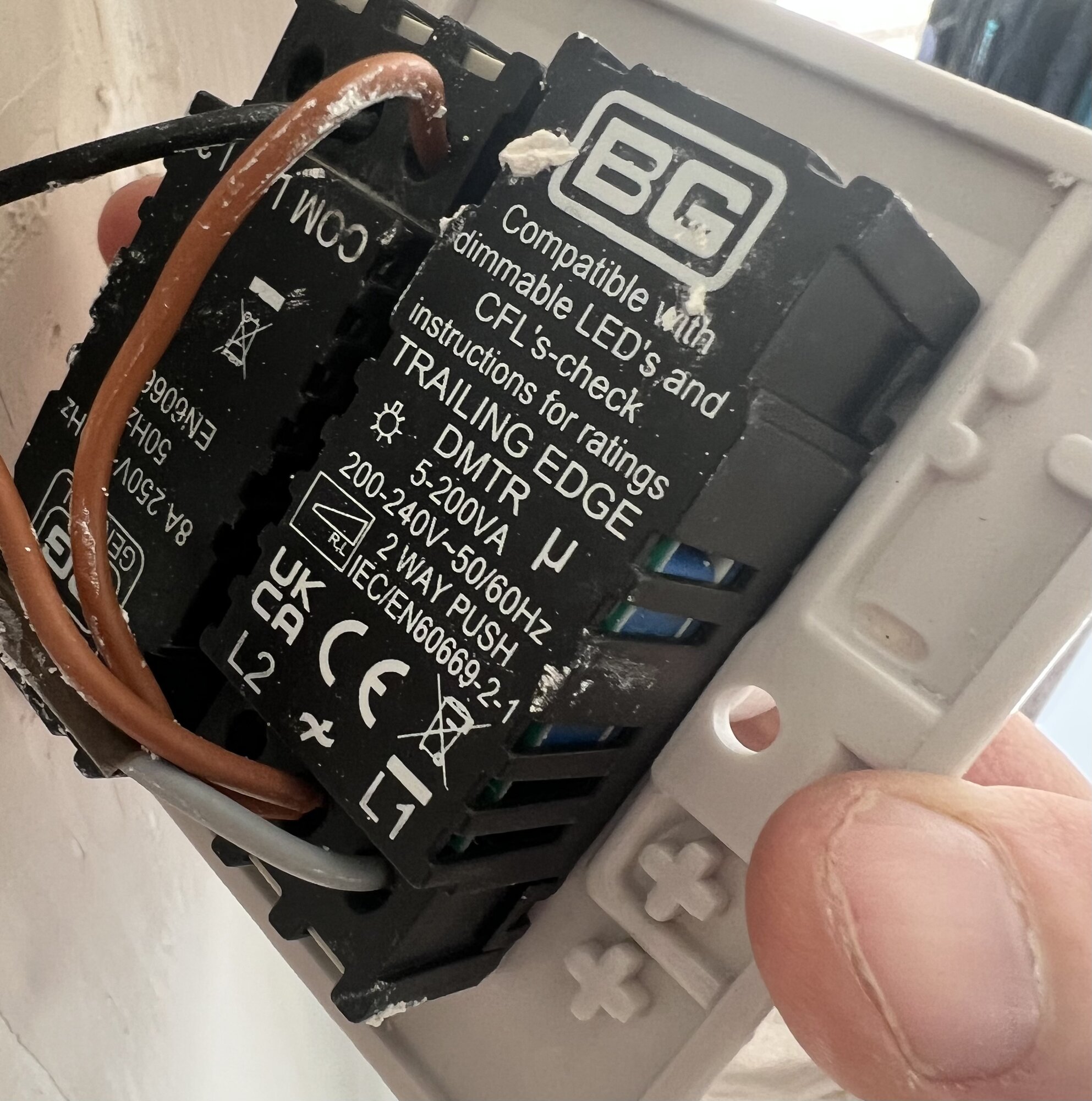

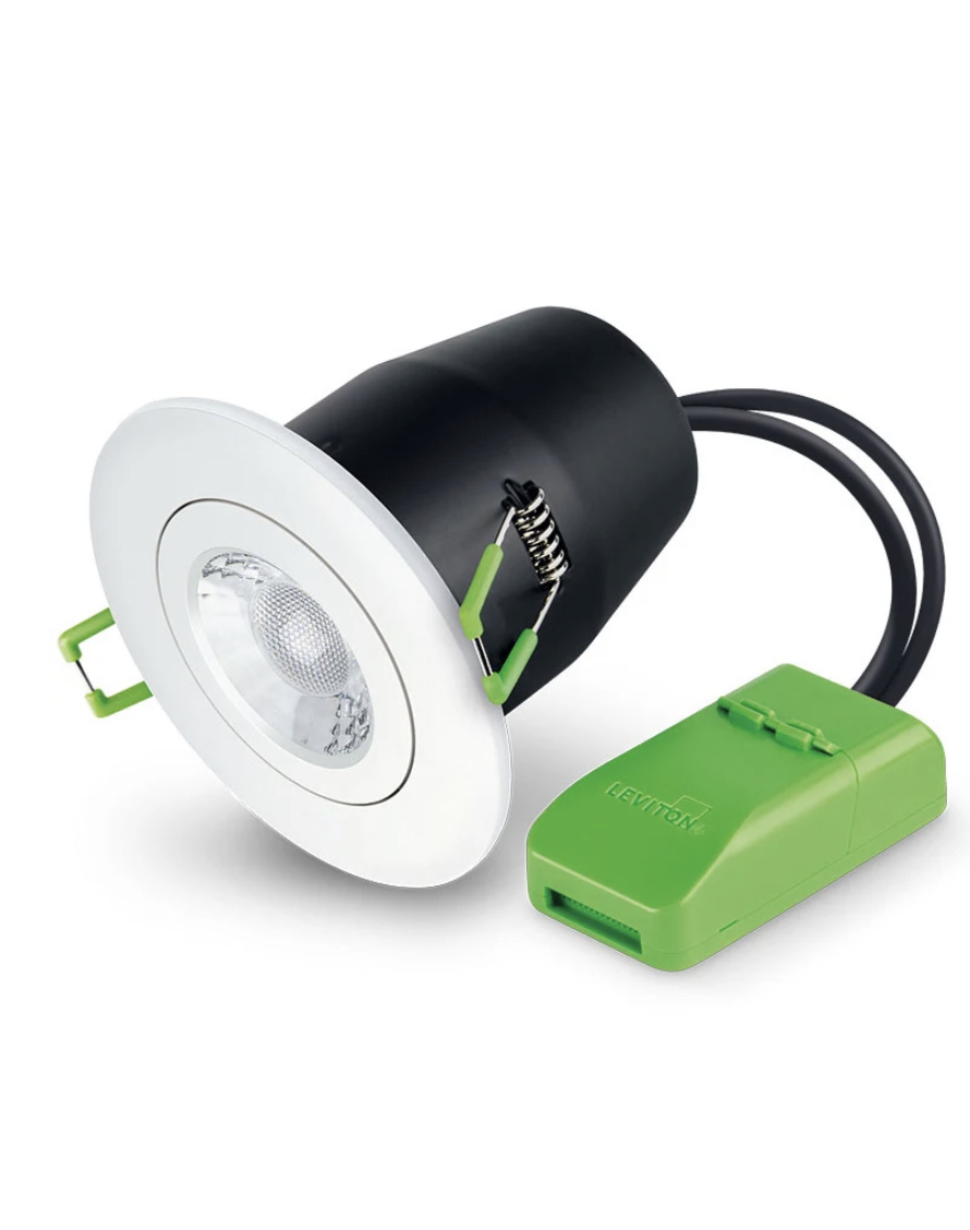

Hi,
I currently have 4 JCC LED down lights in my bathroom with a 2 gang dimmer on the outside.
The first dimmer switch controls the LEDs and the second is just a push on and off for the bathroom fan.
The current module for dimming the LEDs is a BG TRAILING EDGE DMTR. When this is down low it is still very bright and I would like them dimmed a lot more.
Can someone please advise of a better dimmer switch/module to enable the lights to be dimmer when all the way down.
Thanks
J
First check the fittings are, in fact, dimmable LEDs….
I’ve fitted Varilight v-pro dimmer switches without a problem, but even dimmable LEDs aren’t always compatible with every switch, and vice versa.
Sometimes it’s down to trial and error to get a good combination.
As above. I always fit varilight v pro dimmer switches. These can be programmed (fairly easily) to bring the brightness down as low as you want.
