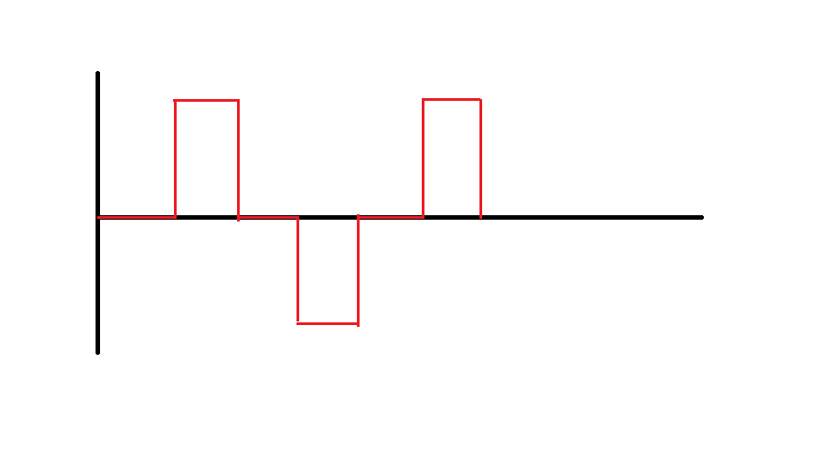

Hi, I know that should provide that kind of data, but sadly I can't show them, what I can show is this:
The input's waveform looks like a square (I'm attaching a pic & yes, where I'm working I only have access to Paint :l).
I still need to do the Thevenin Analysis, It's not that hard but they want me to focus on something else.
My instruments.... I'm stuck with them, I already measured the error, the results are shown in a reply above.
My output waveform looks like a M, I'm also attaching a pic showing it.

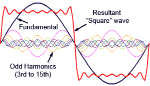

Re #8. The two waveforms tell you a lot. The equal mark:space ratio of the square wave means it contains only the fundamental sinusoid (20kHz) and odd harmonics of it ie: 60kHz, 100kHz, 140kHz,....
50231
The waveform of the output voltage/current shows it is mainly comprised of the fundamental (20kHz) and third harmonic (60kHz).
50232
