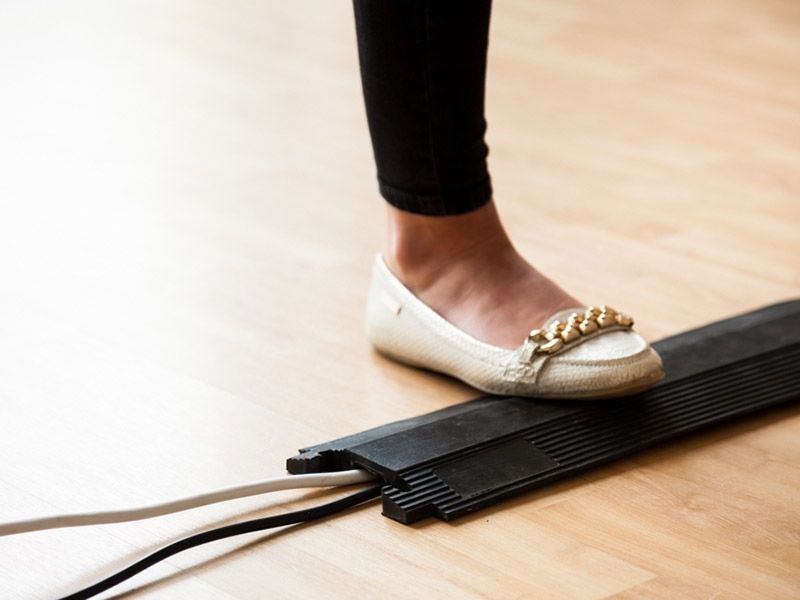

There are words for that incoming supply but I would not like to use them in case ladies are present
I've seen similar in a new build completed within the last year too - except it was carpet that time.
Wonder what the common denominator could be cough new build cough.
I'm assuming the floor layers followed the DNO install and cut the floor round it, but even on the base floor the DNO shouldn't have connected it - I'll be using SWA clamps on it I think, but that can only mitigate it so far.
Anyone do an earthed steel version of this? ?
