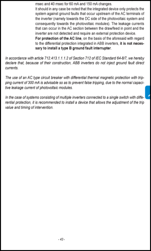

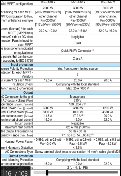

It says the maximum is 19A for the OCPD in the manual. As the installation method doesn't require RCD protection I would move it to a a non RCD protected way if you have a high integrity board. Failing that install a separate board with a main switch.
There in lies the problem, installer initially was helpful then said he would arrange for his spark to come round I did not hear anything for a while and now not returning my calls.
16 or 20A dual pole MCB is how we usually do it, though single pole will be fine if there's already an isolator for the circuit next to the consumer unit.
A typical install here in Cyprus, for Power one or other inverters, assuming it's a Net Metering installation, is to take supply from the DB using a 20A 2P MCB with type 2 surge arrestor, then at the inverter another 20A 2P MCB with A type 100mA rcd. Outside protected circuits seperated. May be worth checking the strings for leakage, measure DC volts from positive to ground and then from negative to ground, if the sum of these equals the string voltage you have a problem
