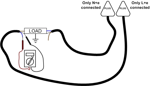

I would like to experience phantom voltage!! Is there any way I can reproduce it so that I can test it?
I know this might sound a little silly, and I realise my new Drummond test lamp would simply not light up if it is phantom voltage, but I would just like to see it for myself on something that I know for certain is phantom voltage.
I also want to test the digital and analog volt meter on it so I can see what they record.
Again... I know this sounds daft but I just want to see it for myself.
Cheers guys.
You can probably "see" this in your own home.
Locate a circuit, turn it off at the CU then attach your MFT - you will probably "see" the phantom voltage as long as the cable(s) run parallel to live circuit(s)
Not sure, haven't tried it, but if you took a nice length of three core and earth and wired it up to a load leaving the one middle core unconnected then you should get a "phantom voltage" on the unconnected core.
My idea works every year...!!!
You'll get a much larger phantom voltage if you wire a simple circuit using two twin and earth cables. Put a plug on one end of each of them but only connect the live in one plug and the neutral in the other, leave the other conductor unconnected.
If you use a nasty cheap multimeter which should have a ridiculously high input resistance you'll see a substantial phantom voltage between the unused conductors and earth.

Posted a couple of times about an easy way of demonstrating this...Get a length/roll of t&e,expose conductors at each end. Connect L and N at one end. At other end,measure between cpc/N or cpc/known earth. By using differing test instruments,the results can demonstrate both the merits of individual instruments,and,the reason why readings can occur. Also,by adding "links",of varying impedance,between sections of the circuit,you can replicate what you would encounter on an installation,and greatly assist the understanding of results. As incredibly sad as it sounds,some of the most fun i had,as a teenager,was setting up such arrangements,on a large 8' x 4' board,with all manner of purloined items,and inventing faults and scenarios,to test and understand. I suppose a modern risk assessment of such an enterprise,would today prove "troublesome" :bobby:

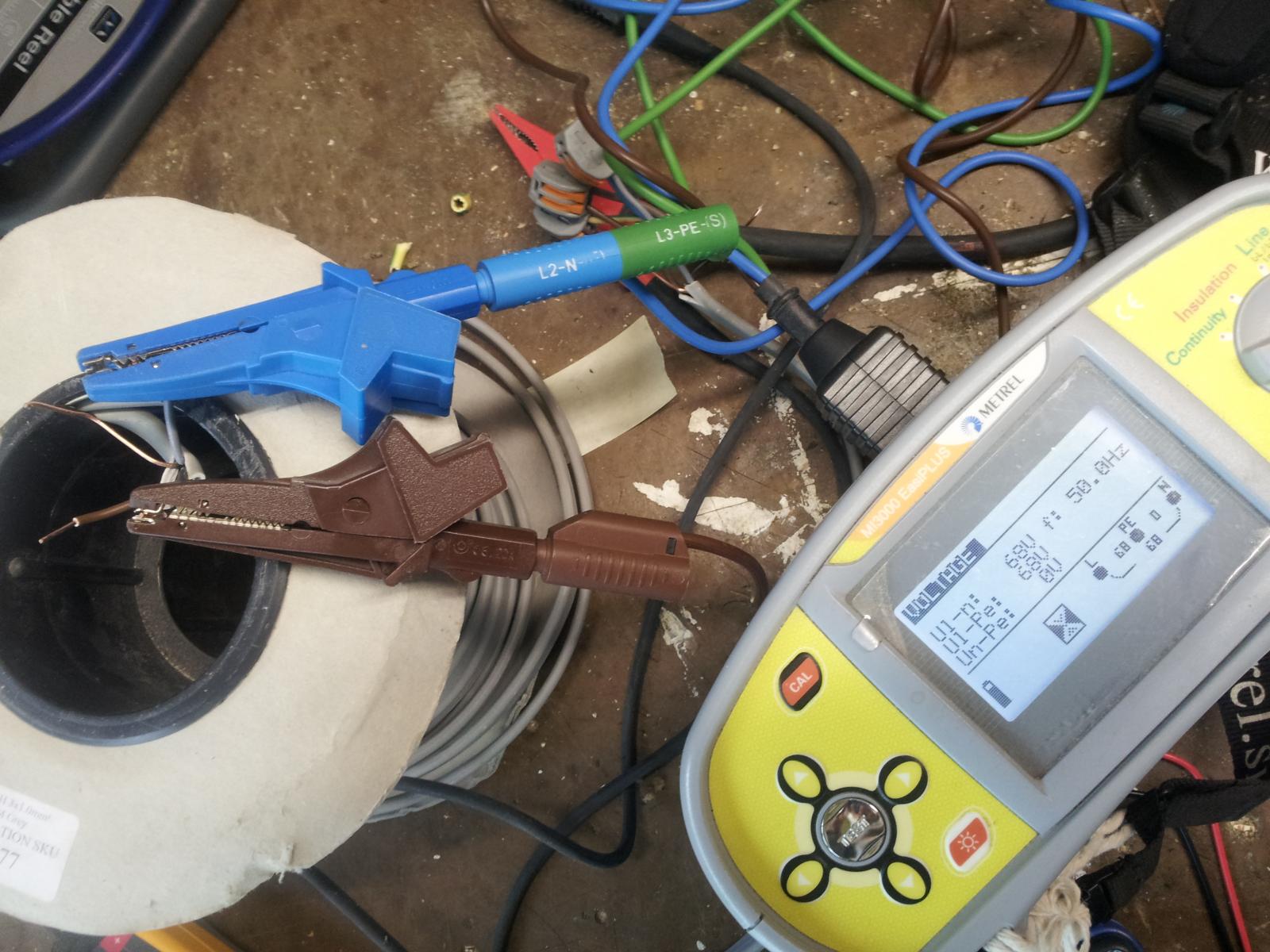

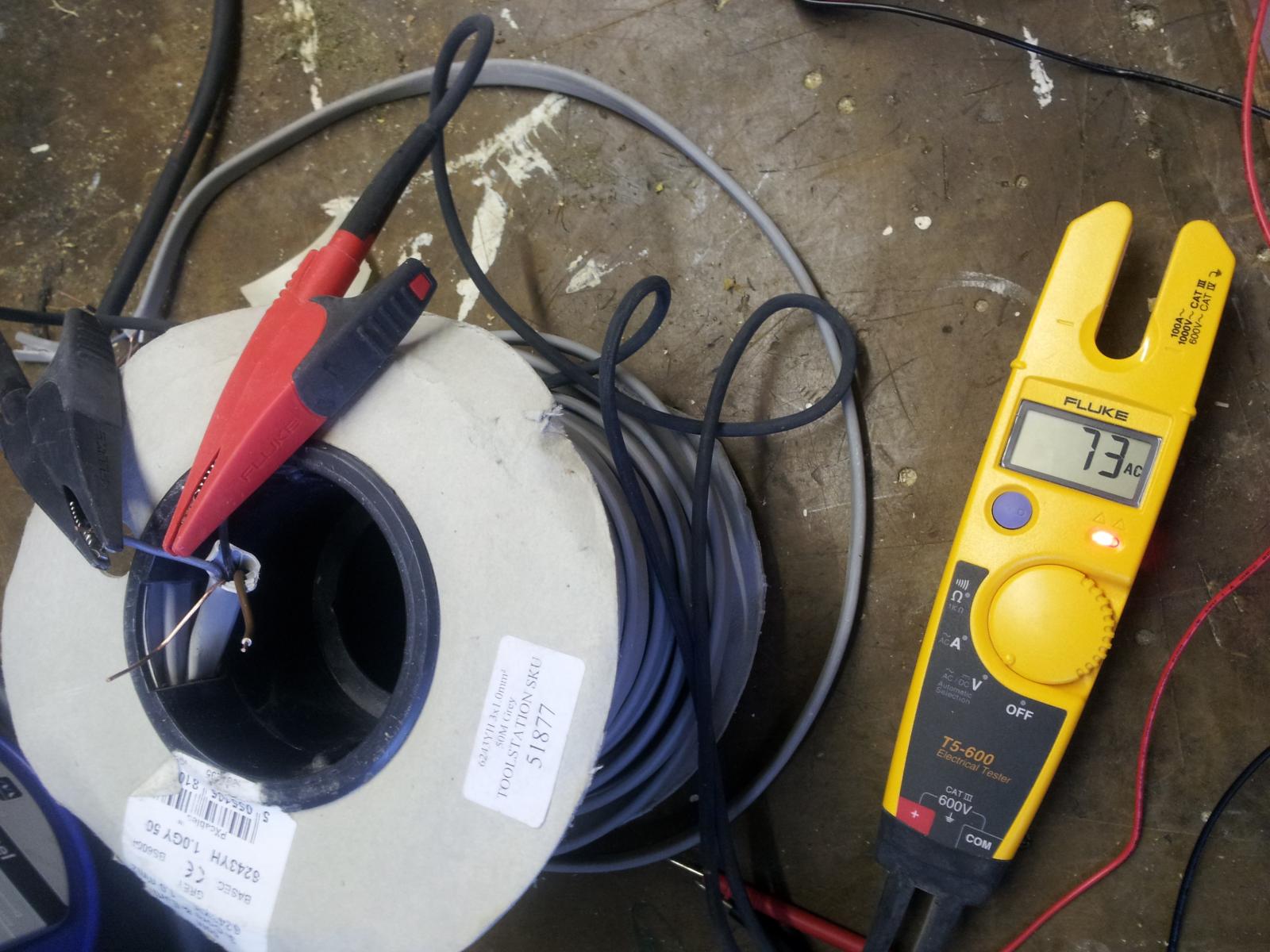

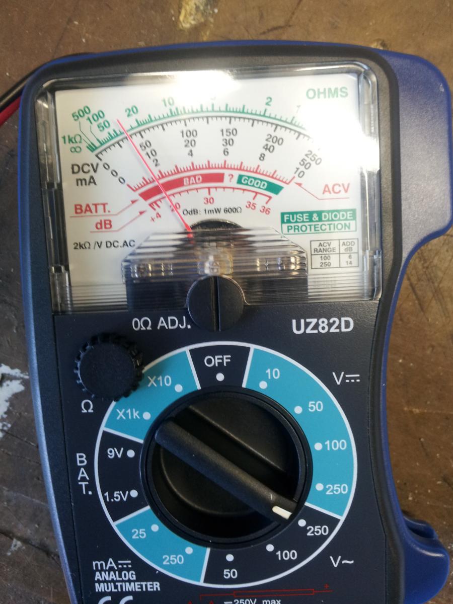

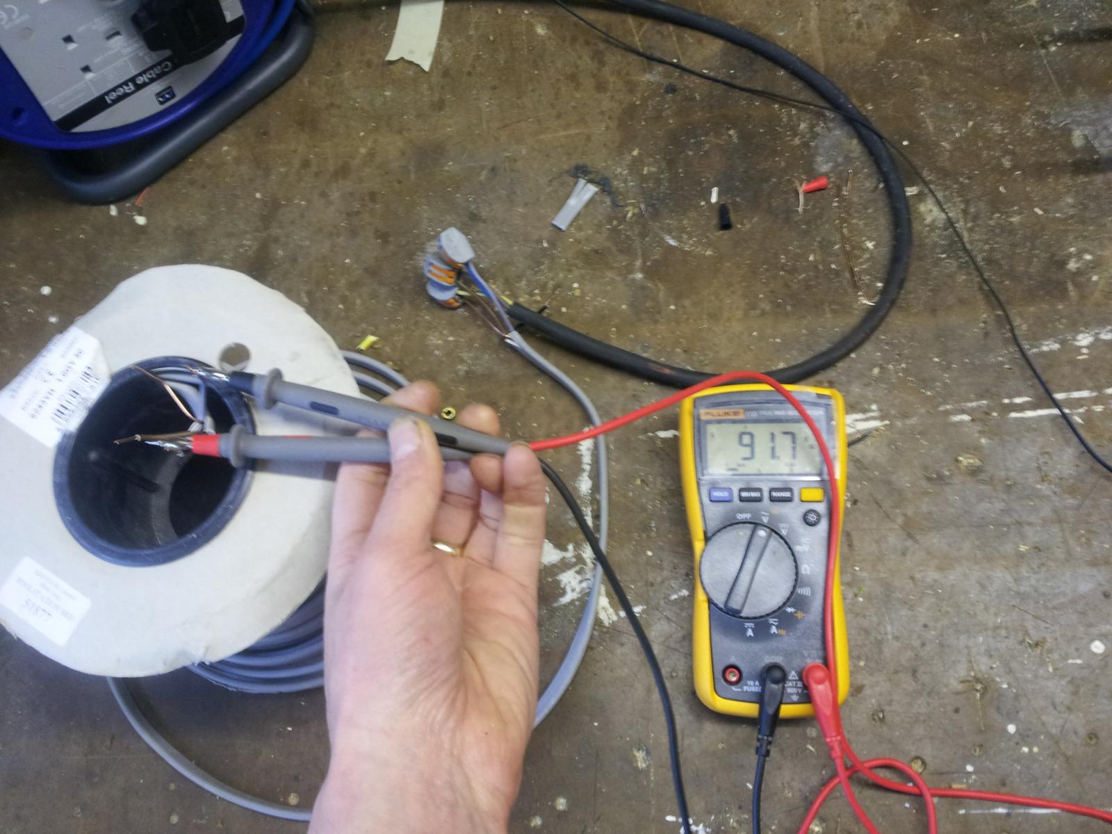

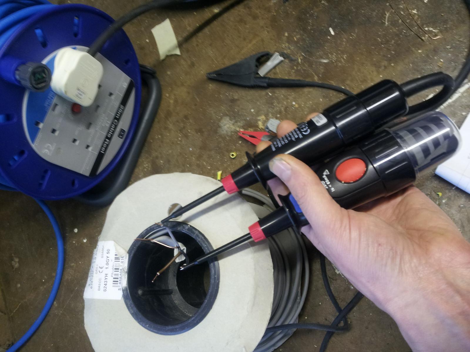

Well I went with your suggestion Richard, I used approx 30m's of 3 core and earth and popped a plug on the end. Live brown, neutral grey and black was the test conductor (left unconnected) to see if any induced voltage showed up.
Here are the results : (all results are voltage from black - N)
1. Fluke Multimeter (Thanks again Paul :smile5:) shows 91.7V.

2. Fluke T5 shows 73V

4. Analog shows 37V

5. Drummond shows <50V (no light)
It was all quite interesting! Quite a range of results from all the testers. It was good to witness first hand phantom voltage and to see the Drummond in action.
I was surprised to see any voltage on the analog meter though, it showed between 35-50V!

The input impedance of analogue multimeters can vary considerably. Older ones (AVO 8, etc.) are relatively low impedance and less susceptible to picking up stray voltage, but modern types (used to be called FET input types when this was a novel thing!) can have very high input impedances and be nearly as bad as digital types for stray voltages. Daz
The next exercise is to account for those readings and compute the inter-core capacitances per metre of cable. If you know the input impedance of each meter, you can use the change in measured voltage from one to another to determine the effective source impedance of the phantom voltage, and what the open-circuit voltage on the black core would be in the absence of any meter. Don't forget that the impedance driving the test core of the cable is mostly capacitive and the meter input mostly resistive so their voltages are around 90° out of phase, hence the squares of their voltages add, not the voltages themselves.
Then look at the construction of the cable and estimate how that is made up from the various mutual capacitances and resistances between each core and another, and from that characterise the cable. You could then take use that data to predict the stray voltage on a different core with a different layout of energised cores, and compare with the actual result.
