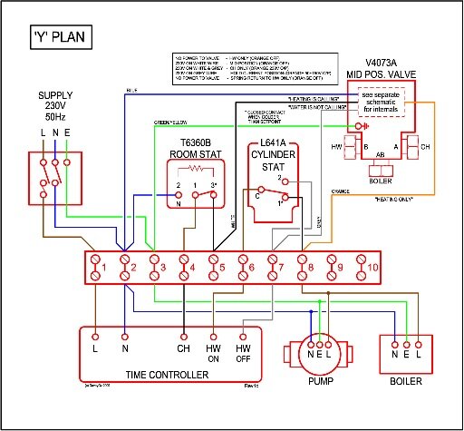

I have a problem with my central heating system…..and am wondering if anyone can help.
The system:
1. 15 year old detached house, with a 15 yr old Honeywell Y Plan CH system, which to all extents and purposes works FINE.
2. Boiler is a traditional ‘IDEAL Classic’ boiler, fitted inside the garage, wall mounted. Balanced flue.
3, Standard steel radiators, microbore plumbing. They all get hot very quickly when the system works properly.
4. Honeywell Y System, with a 3 way valve V4073A (28mm pipe) and pump, and hot water cylinder with a Honeywell cylinder thermostat, and the junction box for all the wiring, is all in the airing cupboard upstairs.
5. Downstairs in the hall there is a standard Honeywell Room thermostat. Model 6360B
6. Standard programmer, was a Honeywell ST6400, is now a Honeywell ST9400C, which times the hot water and heating separately.
Everything has worked fine until this summer. Normally I can set the programmer to Hot Water, or Heating, or Both….and it can be all automatic or I can just press the Extra Hour button on either.
What SHOULD happen of course is that when the electronics calls for heat, either for the hot water cylinder, or for the central heating, it will switch the 3-way diverter valve to the appropriate pipe and simultaneously switch the boiler and the pump on.
When I ask the system to heat up the hot water, everything works. Also, when I set the system to deliver hot water AND central heating at the same time, everything works fine….radiators get hot, hot water gets to temperature, etc.
BUT….My problem is this: When I ask the system to heat up the radiators ON THEIR OWN, the pump does not switch on, regardless of the setting on the room stat in the hall.

folow the switched L from programmer through valves and stat. using a metr set on ac volts.
You need to get someone in to sort the issue out as it could end up very expensive just changing parts.
If the system works on water and heating but not on CH only it sounds like the valve is not driving far enough across to activate the micro switch which should make the orange wire live on the mid position valve!
It really shouldnt take long for a good electrician to locate the fault !
With heating only selected on the programmer and the thermostat calling for heat the grey and white on the 3 port should both be live. White should be live as its connected to the thermostat which is calling for heat and programmer is on for heating. The grey should be live as the HW is selected to off on the programmer. If they are both live then the motor should turn the ball and arm within the valve body closing port B and making the orange live which then switches the boiler.

Orange wire shows around 60v, white wire shows 240v.
That's on a NEW head and valve, sitting on the carpet. I presume that when you say 'confirm the orange wire becomes Live, that you mean 240v? But this CAN't be a faulty valve or head. This is the 3rd head I've tried....

Select heating on and hot water off, turn room thermostat all the way up and check for voltage on the grey, white and orange.

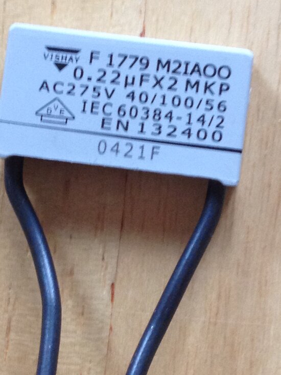

I had something similar recently. All wired correctly, valve was opening fully with 230v to white and grey but wasn't getting 230v on orange. Changed the head on the valve - same problem.
Called Honeywell to see if they could shed any light. Explained the problem and fairly quickly they said you need a capacitor between N and orange which they'd send out to me. Said DON'T fit anymore new heads as you will damage them without said capacitor. Mumbled something about pump overrun which I didn't catch and put the phone down!
Part arrived a couple of days later, fitted along with a new head and it all worked fine. Anyone else had this too?
That's interesting, MattG. Thank you. Might give them a ring. Could you give me the spec of the capacitor? Cheers.
I'm sorry I don't remember. If you call Honeywell and ask for technical they came up with it as the fix immediately. It's clearly a problem well known to them. Let us know how you get on.

This is what is connected to my boiler and it connects the orange of the 3 port to Neutral.
Not sure why its connected but cant see how this would solve the above problem.

That looks similar to what Honeywell sent me Tony. Also fitted between Orange/Boiler SW and Neutral. It solved my problem but not sure why to be perfectly honest. Everything was wired correctly but every time you replaced the head on the valve it would damage it and you wouldn't get 230v on the Orange.
Ah, OK. I've not seen this done before and I am not sure why it is done. The orange lead on a 3-port has two functions. When there is call for heating but not for water, the valve moves to the far position and a contact completes a circuit from white to orange to feed the boiler / pump. The only function the capacitor might have in relation to this is as a suppressor to reduce arcing at the microswitch when switching the boiler/pump load. I would be surprised if the microswitch would fail rapidly without it, unless they have started using very weedy microswitches or the present generation of mid-position valves actually use a solid-state switching alternative to a microswitch (It's years since I looked inside one, perhaps someone could confirm?) Personally I would use a snubber with built-in resistor for that purpose and the only reason to add it outside the valve would be if the one built into the valve was inadequate for certain loads. Mention of the pump overrun would suggest that the switching device in the valve is being damaged by the pump motor being dumped back on the orange lead and creating a transient after running from the boiler PL via the overrun thermostat.
There is another sneaky function for the orange lead, which is to backfeed the demagnetisation resistor in the valve when there is call for hot water via the normally-closed contact in the cylinder stat. The small resulting AC current in the winding is supposed to avoid the situation where, if the valve has been sat at the mid-position for a long time with DC flowing through the motor via the stall diode, the stator becomes slightly magnetised preventing the spring spinning the motor back to the rest position once the call for heat via the white lead is removed. There is a minor side-effect if the valve is in the far position when this happens: The valve stays put because grey is still live and current flows via the demagnetisation resistor back out of the orange lead. I can see a possibility that if this is used to control boiler electronics via an input that is unduly sensitive, the 1mA or so from the orange lead might cause unwanted triggering. The capacitor would provide a load to absorb that, however it would not damage the valve so I don't see that this is the reason.
If anyone can confirm or deny whether modern 3-ports have a triac or something controlling the orange lead, that might shed some light on it.
